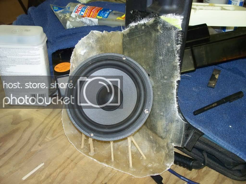

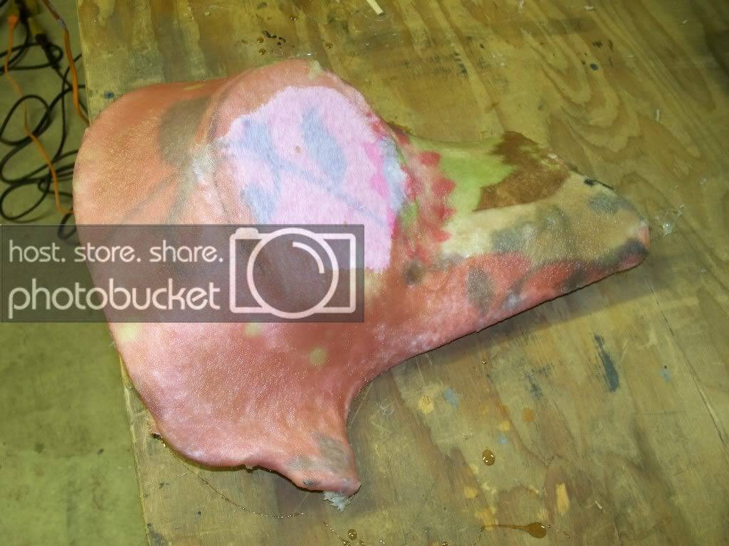

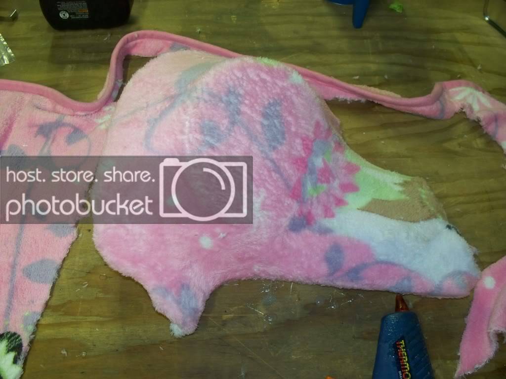

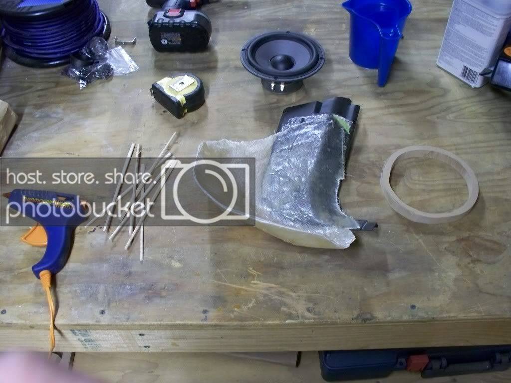

Today even with the rain i decided to finish the right kick panel. As I sit here recovering from the fumes I think they are going to look good after sanding bondo and paint.

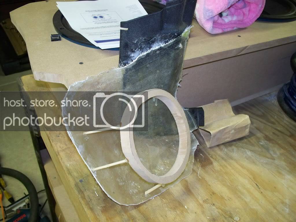

Trimmed the base
Made the ring and started mounting it.
Everything fits good going ahead fro wrapping and fiberglass.

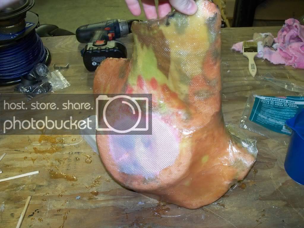

Clearance fleece blanket for 8 bucks. Sorry disney

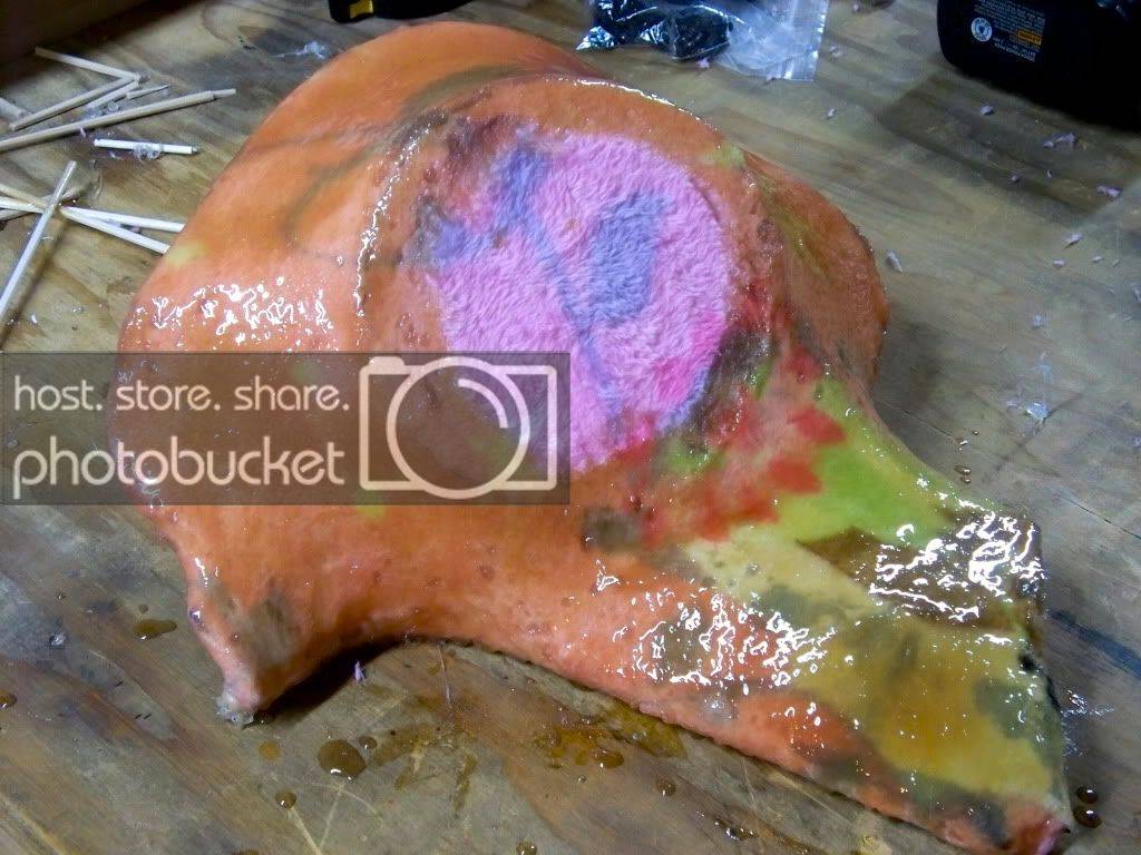

First coat of fiberglass.
Are you sure the mids will get enough airspace?
Base mold looks very thin.
x2 on router w/ circle jig. That baffle/ring looks like shizzle.
Will the mids have a grill to protect them?
