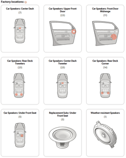

Crutchfield shows:
  • 2 front tweeters
  • 2 front woofers (4")?
  • 1 center woofer???
  • 2 rear tweeters, behind rear seats???
  • 1 woofer under front passenger seat.

Crutchfield says this is my car audio setup.
What would be the best I could do, without having to rewire the vehicle? I did that once and don't want to go through that headache again.

You'll need to provide more info than a link to a Crutchfield website. What budget? What do you want the system to do?
The best you can do without doing any wiring is a head unit and speaker replacment.
Beyond that, you'll need to wire for amplifiers.

Yeah, it should still have woofers under the front seats as well... would have to pull out the seats to verify. There are a few companies like FOCAL who have direct replacement speakers for all locations. It's not going to be cheap no matter the direction you choose but I think the FOCAL will run off the factory radio/amps.
