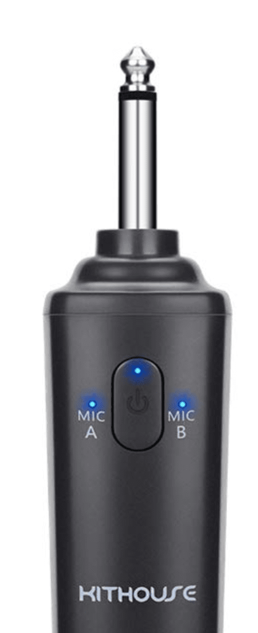

I bought a set of Wireless Microphone Karaoke Microphone https://www.amazon.com/gp/product/B07KJH7SS7/?tag=caraudiocom-20, and insert the Wireless Microphone receiver to my car AUX. I also have an iPad (song selecting) that connects to the Wireless Microphone receiver, so the song music can also come out from the car speaker.

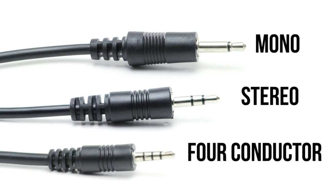

The Microphone receiver uses a mono connection shown here:
20432
You can tell that its mono because it only has a single black line which insulates a single conductor. Car audio auxes are designed for stereo connections and you need a 1/4 inch female mono to 1/8 inch male stereo adapter like this:
This should split the mono into stereo (two black lines representing three conductors - Left and Right and ground) This will allow you to hear music from both sides of the car. You should be able to search for any plug/patch cable/adapter as long as its a 1/4 or 6.35mm Mono Female to 1/8 or 3.5mm stereo Male.
Phones use four conductor wires (3 black lines for stereo and microphone)
20434
