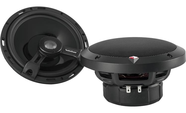

Thinking of doing the front component and hooking it to the amp and rear speakers to my aftermarket head unit.
Would these speakers and my current amp work together?: https://www.crutchfield.ca/p_575T4652S/Rockford-Fosgate-T-4652-S.html
if i do make this change do i keep the same rear speakers or switch for these:
Skip c5s. Leave the rear on head unit power. Bridge into 2 channel mode your current kenwood to the front components. Now you dont have to buy a new 4 channel.

Don’t waste anymore money on rear speakers. Also for a thousand plus dollar plus passive rockford Comp set you could get a new double din that plays active, raw tweeters and 6.5’s, and a four channel with more power to help with midbass amplification, and door treatment and still be under $1400cdn.
