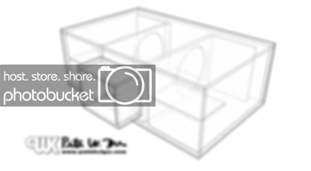

1) design your box first
-search around to see what 12'' BTLs like for airspace and used 16'' in of port per cubic foot or maybe more depending on how your box is setup
2) your cut will depend on your box size
-if your box is 15'' tall x 40'' wide for example, your cut can be 35'' wide by 12'' tall since you plan on angling the baffles in towards each other
3) cut the bed side first...I had the cab-side cut first and it ended up being a little lower than the bed, which was my mistake.
4) after you cut the bed-side, drill a little hole at all 4 corners of the cut from the bed-side...this will transfer the corners into the cab-side
5) cut the cab
6) put the accordion boot on using 3m weatherstripping adhesive
7) caulk around it to be safe

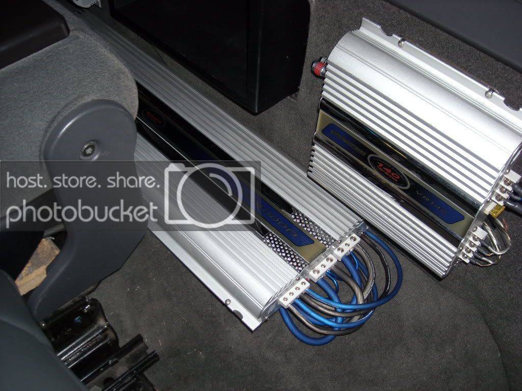

What the hell ^^^ the back of my cab flexes so much it causes my 2-channel to make the music skip and this guy has 2-15s and has amps on the back wall? What the hell am I doing wrong?
His back wall dont move at all. Foamed, bolted MDF, and all kinds of mat.. It's as solid as a rock.
He's running the VR4000 at 4ohm's. Video kinda sucks but it moves quite a bit of air.
