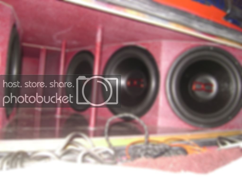

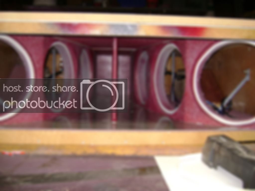

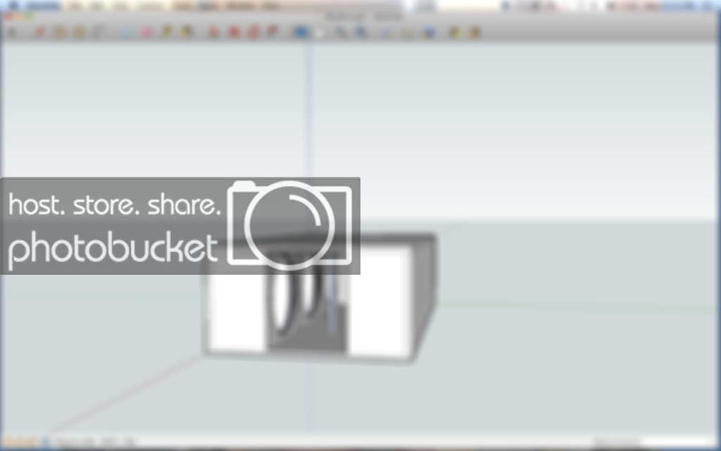

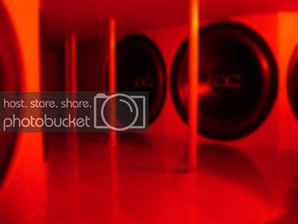

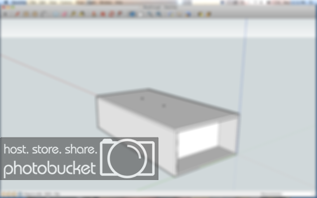

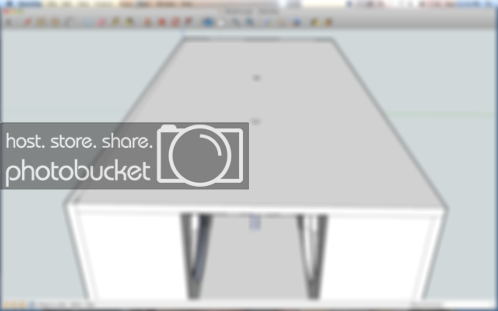

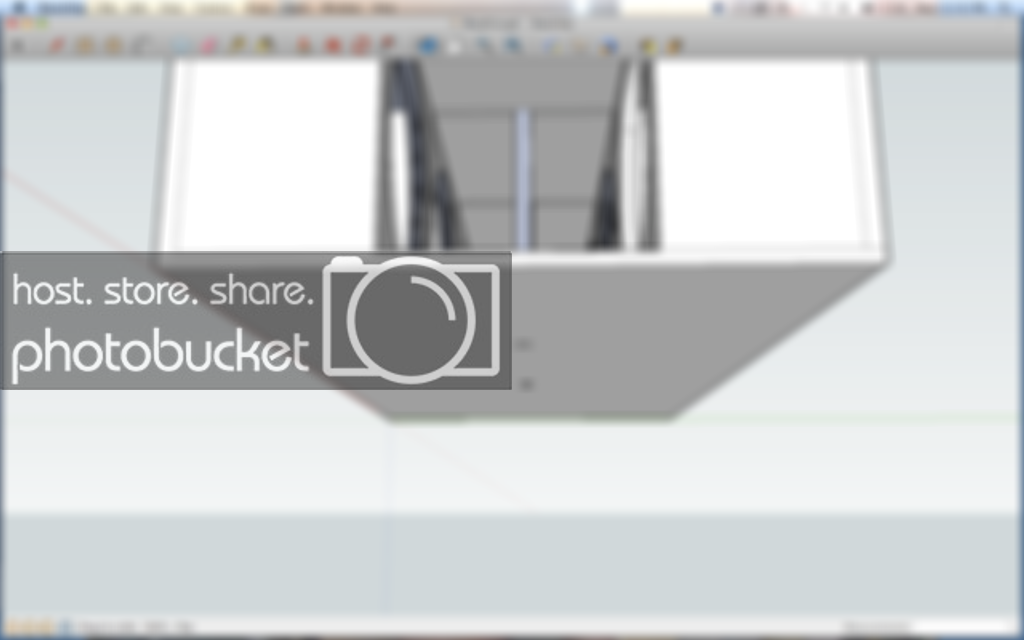

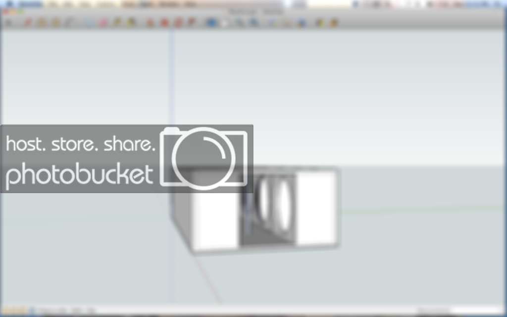

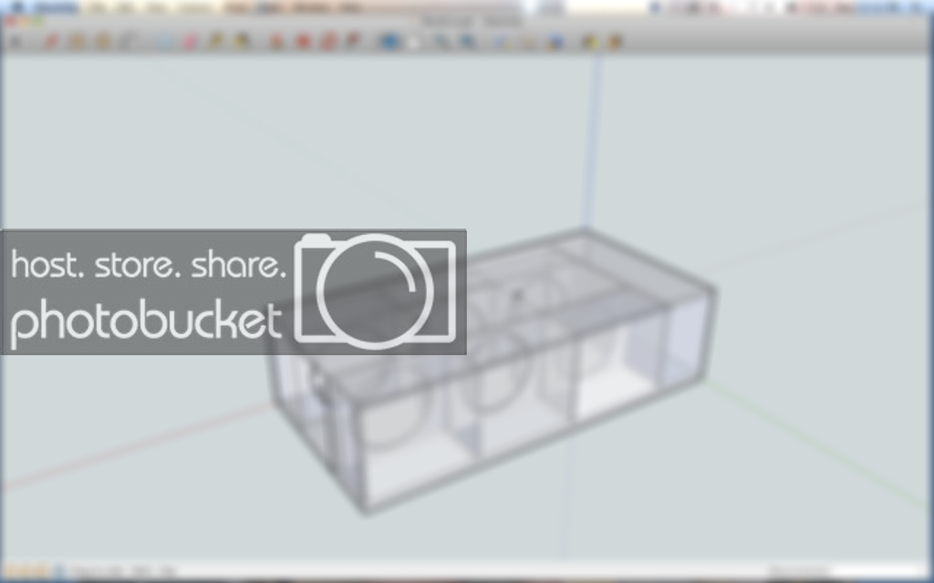

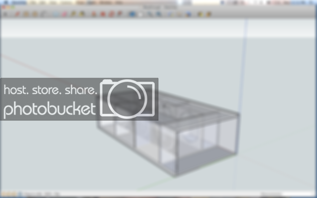

My truck is about 160 miles away so all i have for now are shitty cell pics.
I wish I could take some better ones for ya. This thing was a rediculously snug fit. They barely fit.
gotta quick question ...how would be the best way to connect the box to front of the bed? also how could i make like a beauty plate look good? any idea guys??
You really dont need to "connect it anyway.. You just slide it in and seal around it with whatever you want. As for a beauty panel you can just cut up like some 1/2" MDF and form it to fit right over the front of the box and make it come up to your window line and all..

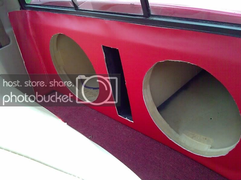

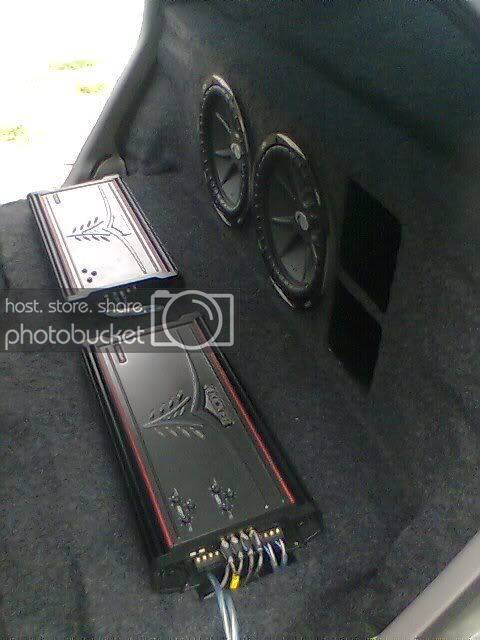

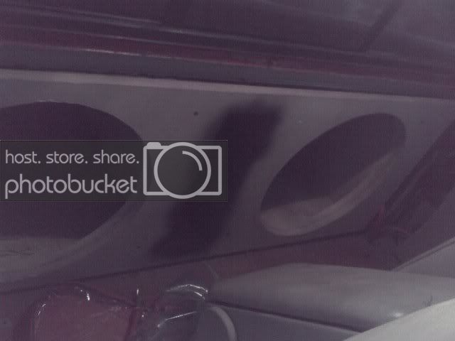

this is virtually the same thing but in a sedan I did.
Pretty neat you can fit 15's flush with the rear wall. I could only cut so tall before getting into bed rails and I can't cut into that or my tonneau won't fit.. I had to sink my 15's back to fit them.
