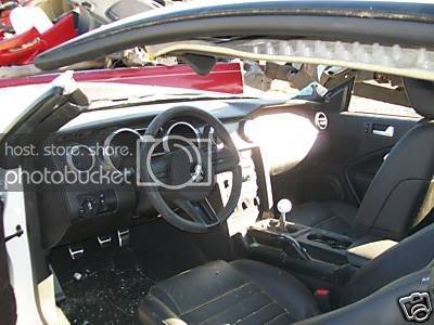

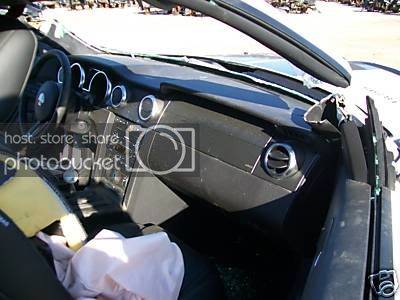

I had a pretty sweet idea for a dash swap check it out
the dash is from a 2008 Ford Mustang SHELBY GT 500
I bought just the shell no gauges or center console. Im going to swap that into my crown vic after i do some research on the electrical system of both cars and figure out how im going to make all the gauges and switches work on the new dash. Ill also upgrade some of the systems in my car such as auto headlights cruise control climate control ect.
Im an electrician with a little research i can make anything electrical work. As far as width more than likely the dash will have to be widened to fit to the car...actually the dash may even have to be totally re shaped thank god for fiberglass! ill know more when the dash arrives and i have the car back so i can take some measurements.

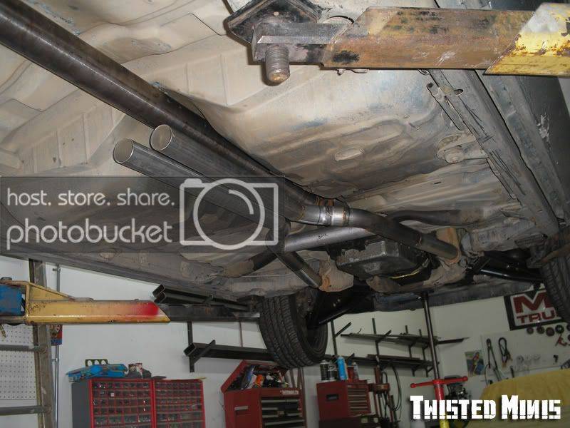

Thats not how low its going to be its held up on the exhaust in the picture. Were putting in a new 2.5 exhaust X pipe menderal bent tube. Im using the SLP loudmouth II mufflers and SLP high flow cats. After the exhaust is out of the way the oil pan will hit so were sectioning the oil pan.

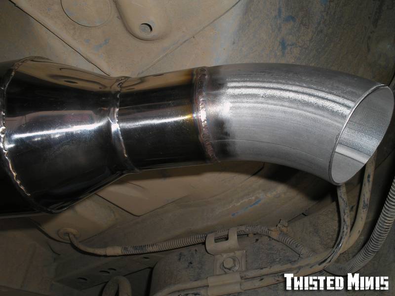

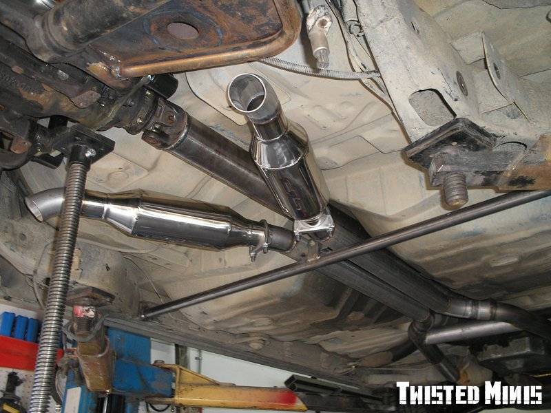

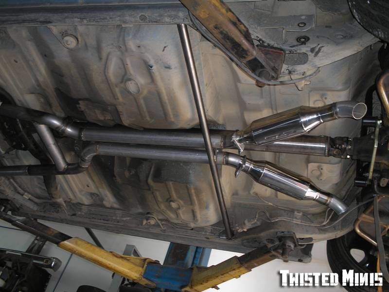

got the drive line built (from scratch, stock one is composite material no one will touch it), and started the exhaust. The floor dips down behind the front seats for passenger foot room, leaves about 3/4" of room between the floor and the ground. Luckily with the IRS the drive line won't move, so we decided to tuck the exhaust up in the drive line tunnel. The floor comes back up behind the rear sits, so we are going to kick the tube back out and put the mufflers under there.
Just about done with the exhaust. There is one rubber isolator on the cross member, but I need to wait until I build the strut rods for the rear axle (waiting on parts still) before I make hangers for the tips. I want to turn them out towards the wheels as much as possible, but I need to get the strut rods built first.
It's gonna be loud. Went from 1 3/4 tube with flat spots in it and massive mufflers, to 2.5" all the way out with what is basically a glass pack.
