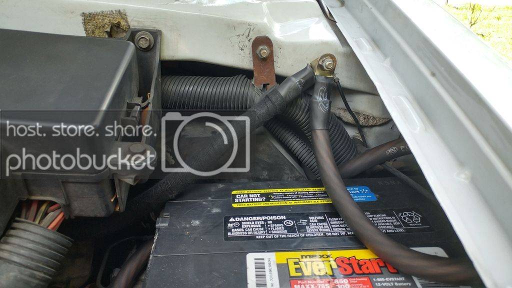

FSD audio 700D amp, the car is a 2002 Chevrolet astro
yeah make sure they clean and if u see a bolt somewhere looks like it's on thicker metal than battery ground move it there.. yeah i got lucky with my alt but they all remans and like tahoe said sometimes takes u 1 yr of swapping to get good one..
Alright so I put the engine ground wire in a different place and made sure to clean of the surface. It's still having a little trouble holding voltage. Should I try putting the two chassis grounds in different places because right now the battery and engine ground are in the same bolt on the chassis.

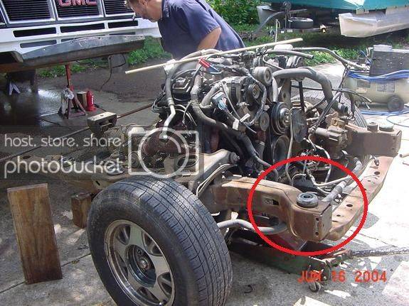

strut bolt?
