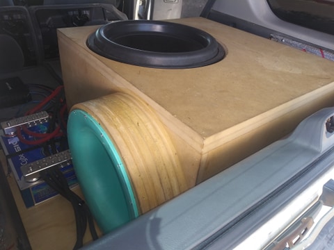

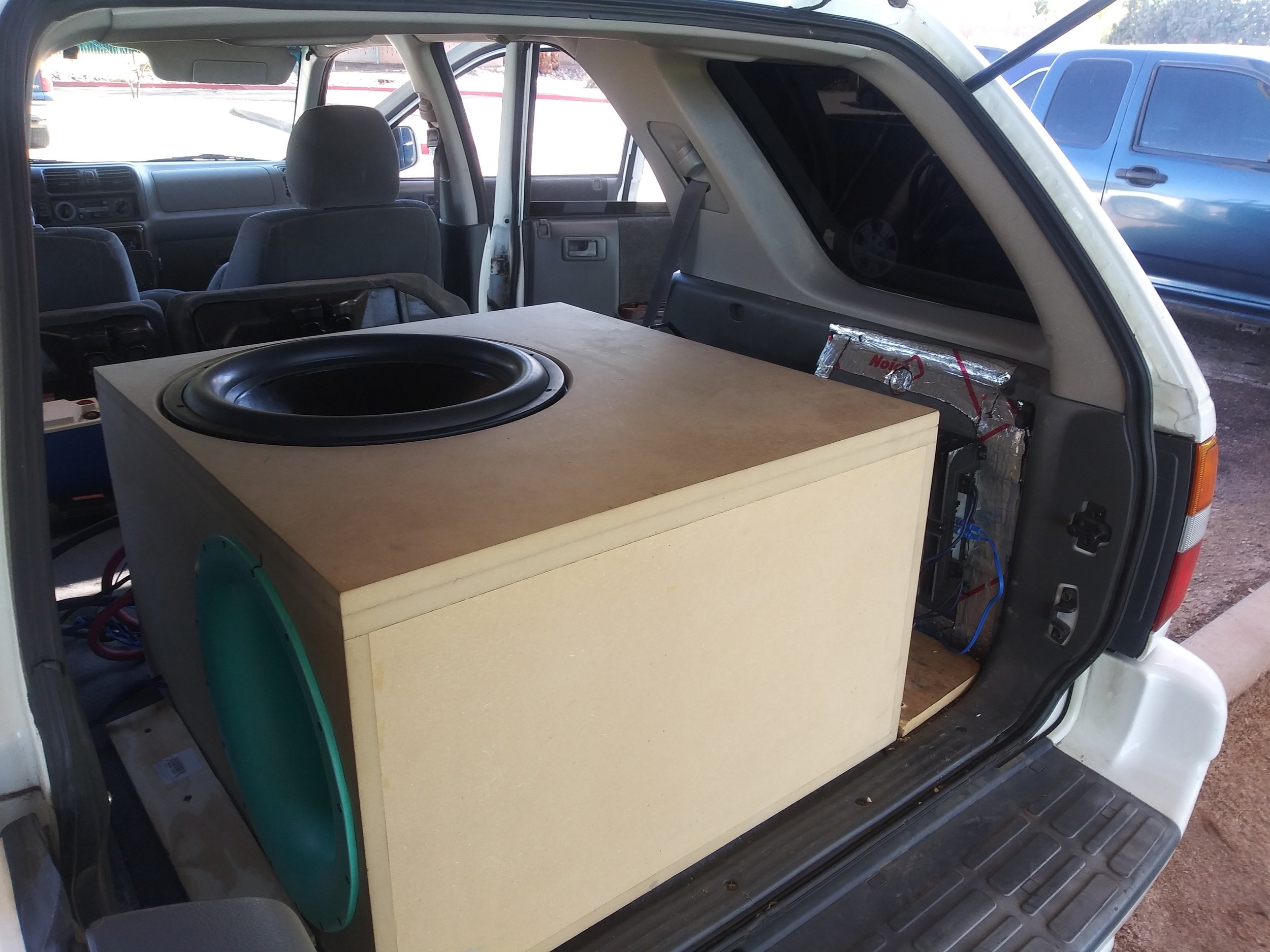

70-90in2 of port in around 5.5ft3net- 7ft3net usually makes most 18's happy. Dependent on power.

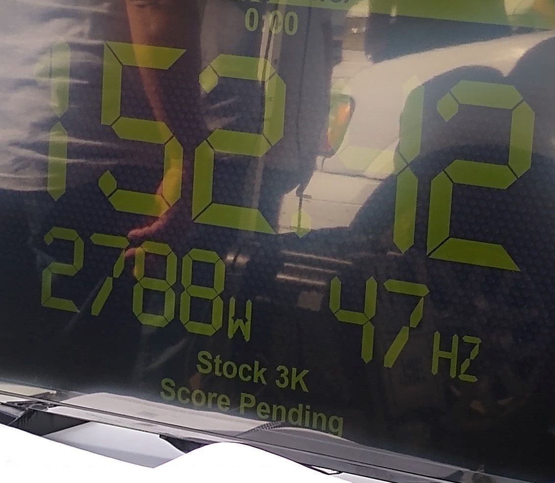

For example, this 1750watt 18 was overpowered a fair bit... and was in 5.6ft3 net with 77in2 of aeroport for a reason. Recommendations claimed 6-7ft3 for this sub on their website. Designed around the power and installed for the vehicle it did numbers like 153db+ garage and 152.4db usaci for 2 years with only a slight coil tap when hitting the lanes.
I think I was close/at the subs ultimate potential... 3K clamped worked with a 1750rms Fi ferrite sub.

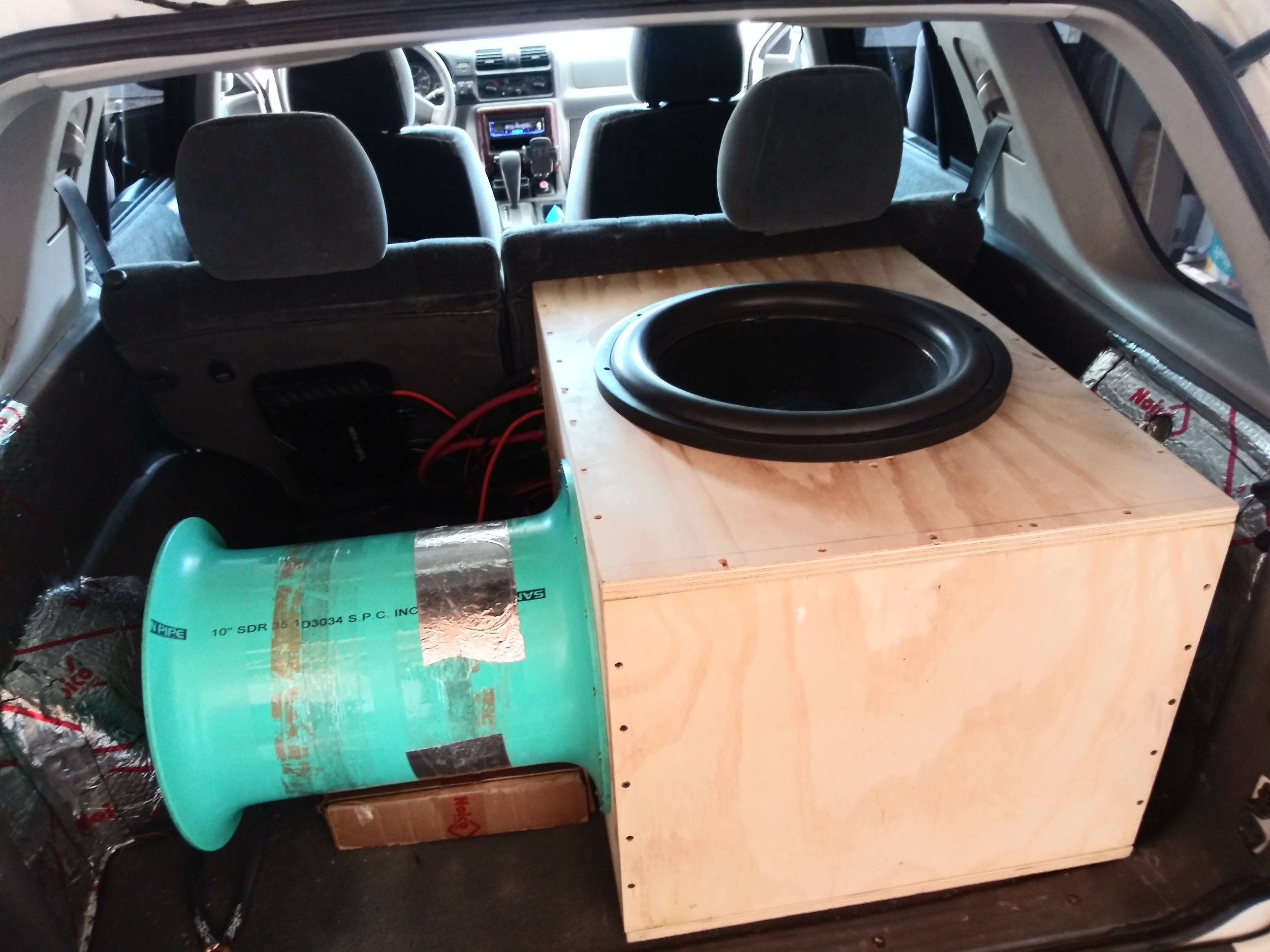

couldnt find a true 10" so i got a 12" and cut it down and fiberglassed a flange on it. Ugly, but functional.

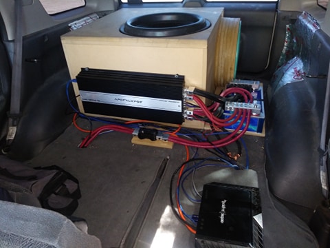

I knocked out and plugged the internal port which gets me to 5.7', put 6 lbs of poly, 10x34" port should be tuned around 30 dont remember. Just checked with my meter got about 52v and 23A so about 11-1200 watts and its not working hard at all. The work van hits pretty hard lol.
