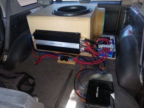

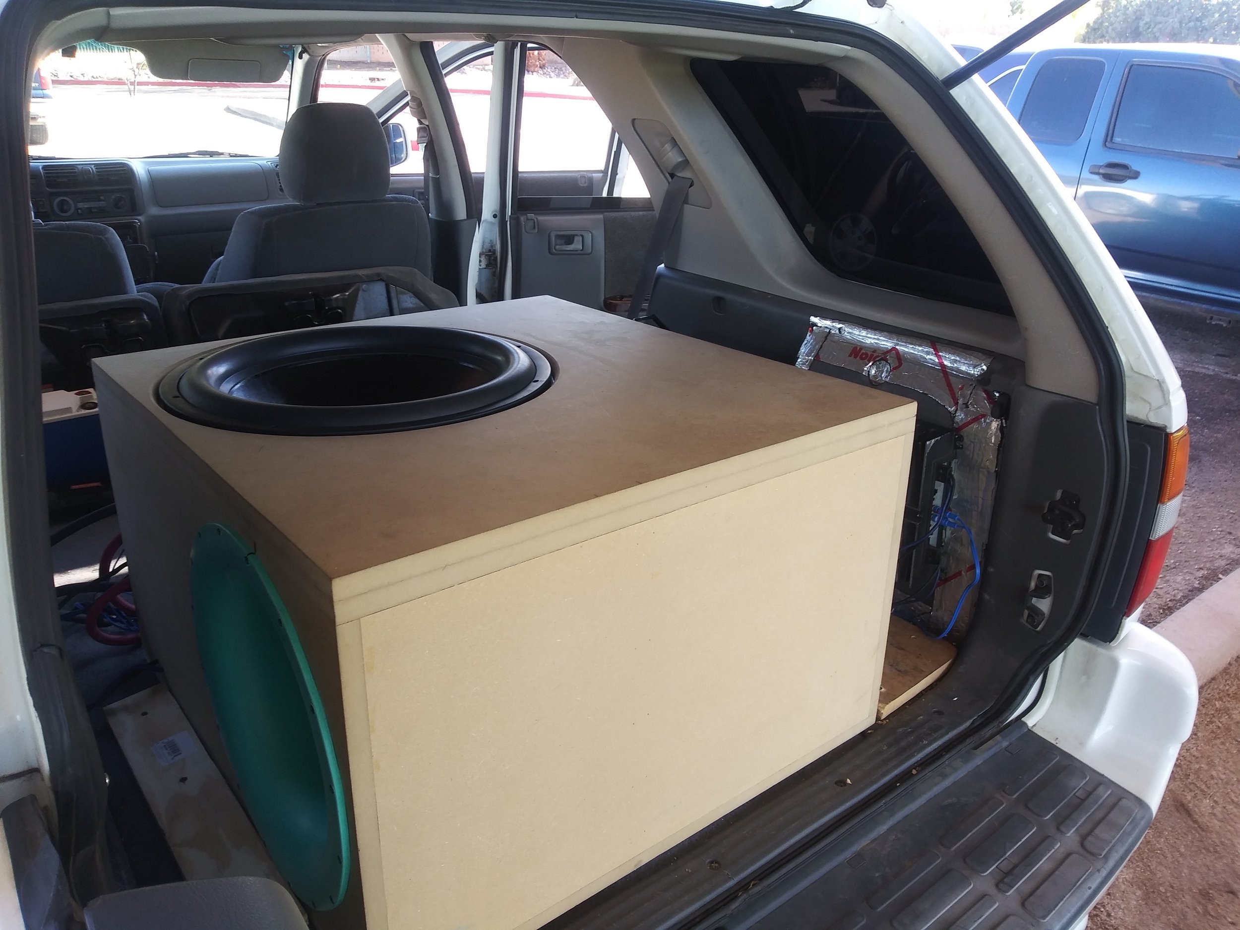

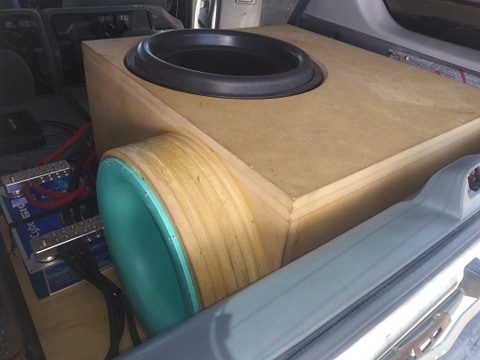

70-90in2 of port in around 5.5ft3net- 7ft3net usually makes most 18's happy. Dependent on power.

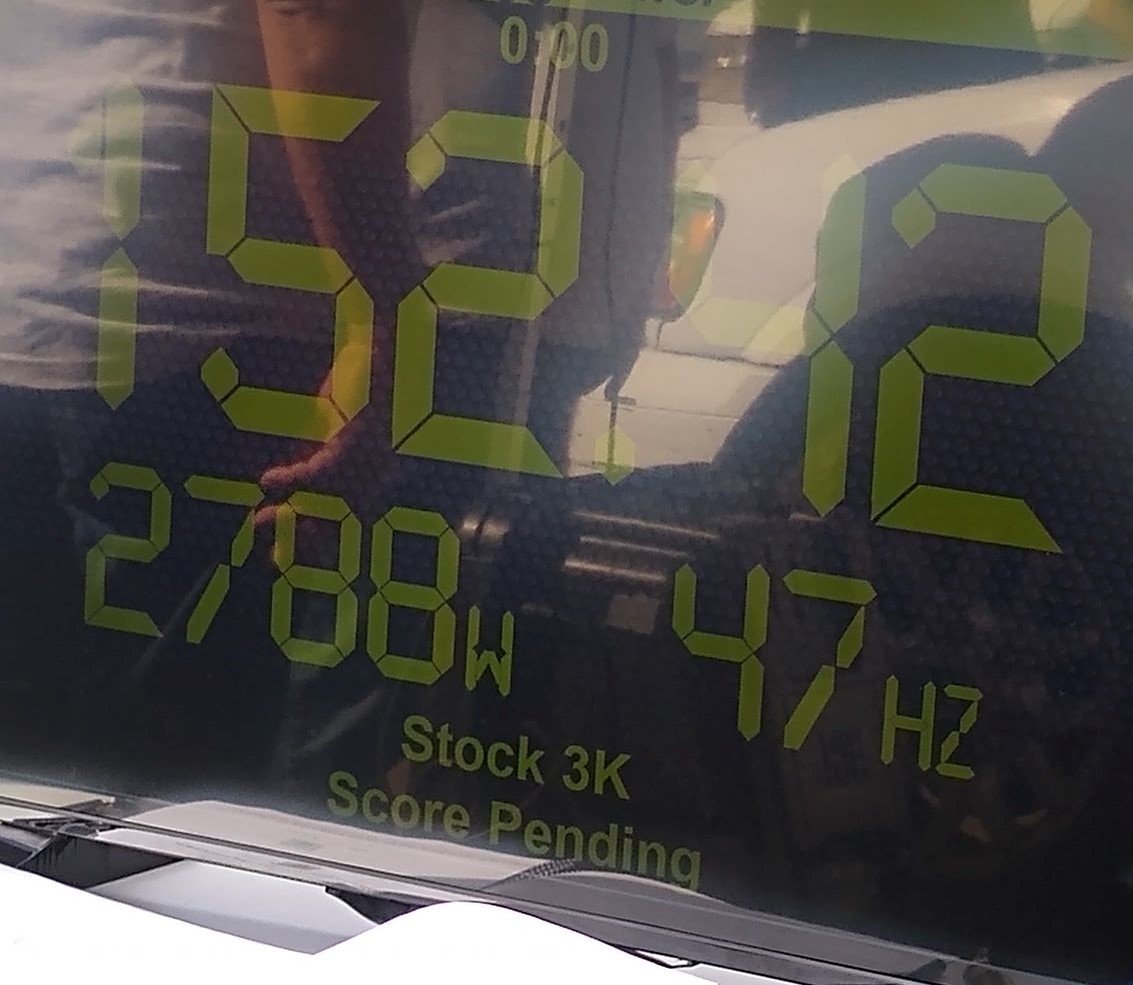

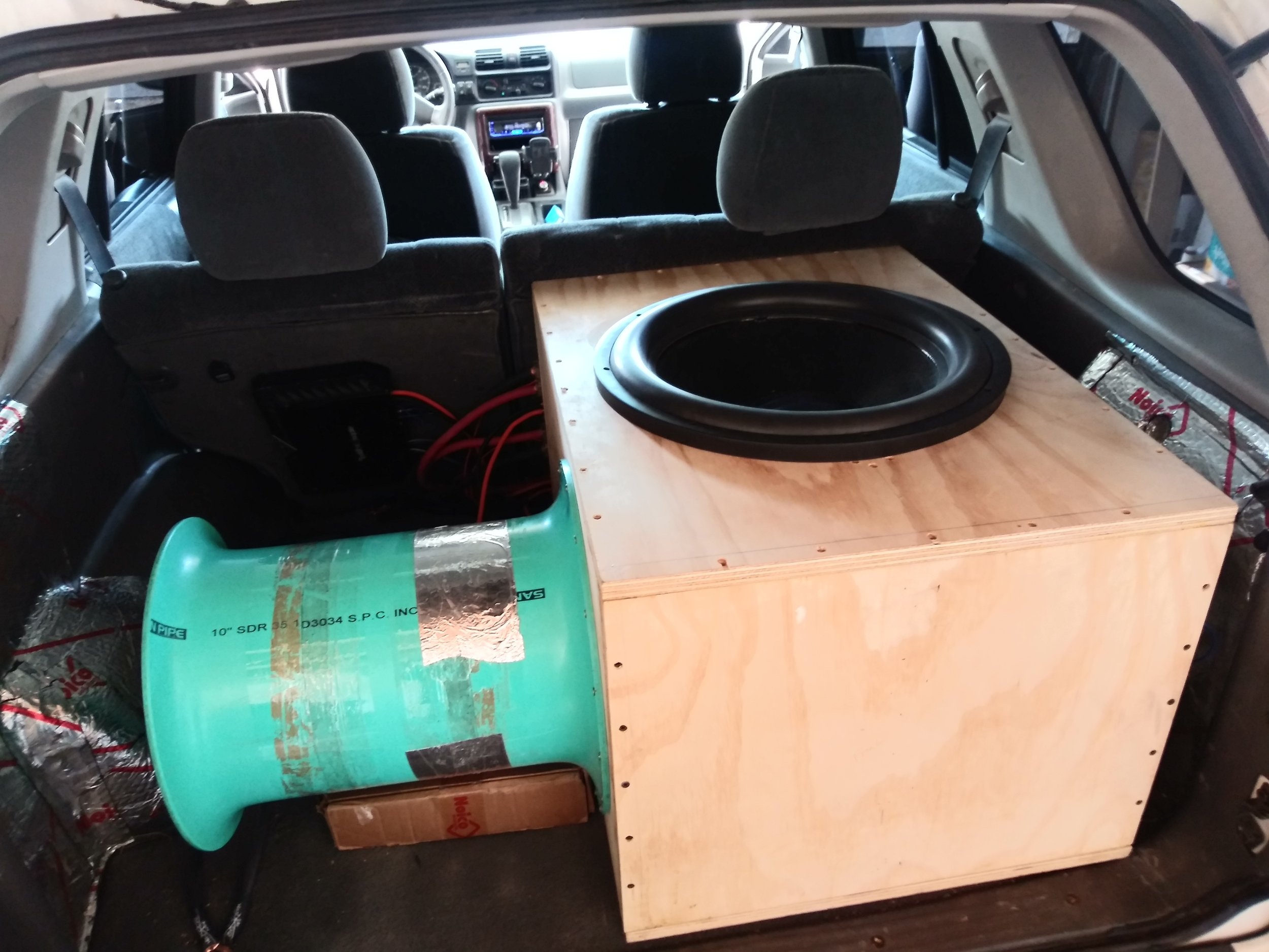

For example, this 1750watt 18 was overpowered a fair bit... and was in 5.6ft3 net with 77in2 of aeroport for a reason. Recommendations claimed 6-7ft3 for this sub on their website. Designed around the power and installed for the vehicle it did numbers like 153db+ garage and 152.4db usaci for 2 years with only a slight coil tap when hitting the lanes.
I think I was close/at the subs ultimate potential... 3K clamped worked with a 1750rms Fi ferrite sub.
It wasn't a burp box either, it was tuned to my musical tastes it went as low as I needed it to and got loud for what it was. It sure flexed and slapped windshield wipers when I needed it to... :ROFLMAO:

Ok so, say I get rid of the internal port and add an external one Im looking at a 5.65' net box. would be allot easyer then building a new box. whered you get that port from?
Is the flared end really needed If Its big enough say I just fiberglass a 10" concrete form tube to the box... ugly but that would be cheap and easy.
