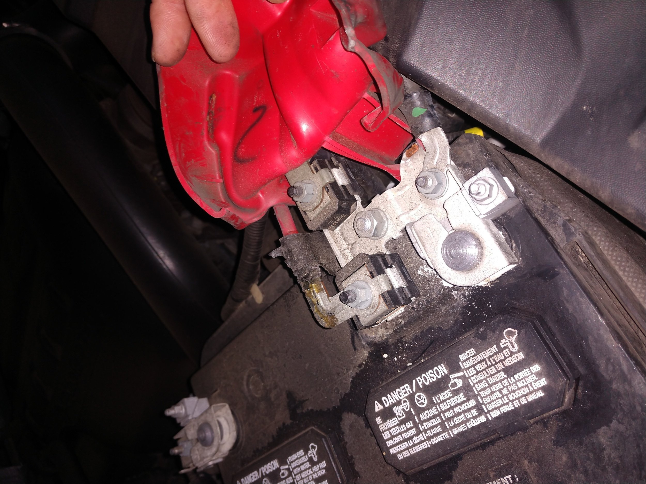

My stock battery terminal is huge. What is everyone doing to clean these up? I see no way to keep stock.

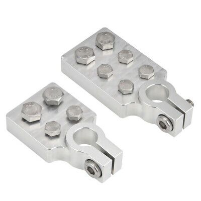

Look for these styles if you are upgrading. Just make sure you can retain your factory power cables and that factory fuse as well.

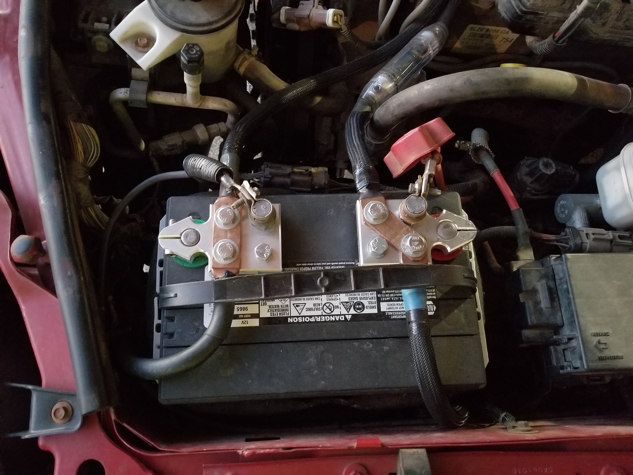

What I do is get battery posts from a parts store and drill/tap one of the holes in the aftermarket terminal for the posts. Then you connect the factory junk to the posts.
