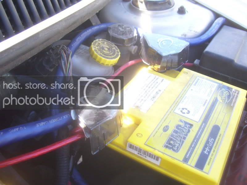

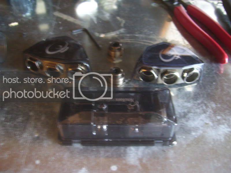

all wiring is kicker kyperflex 1/0. they have 3 connections, each capable of taking a 1/0g or a 4g depending on the adapter you use. each one comes with a few of each size.
this is the negative side. 2 being used in big 3 upgrade, 3rd will be used for the ground run to the back.
this is the positive. one to the rear, one to the alt, one set of two 8g (fuse box, line to small amp for gps speakers) being used with a 4g adapter.

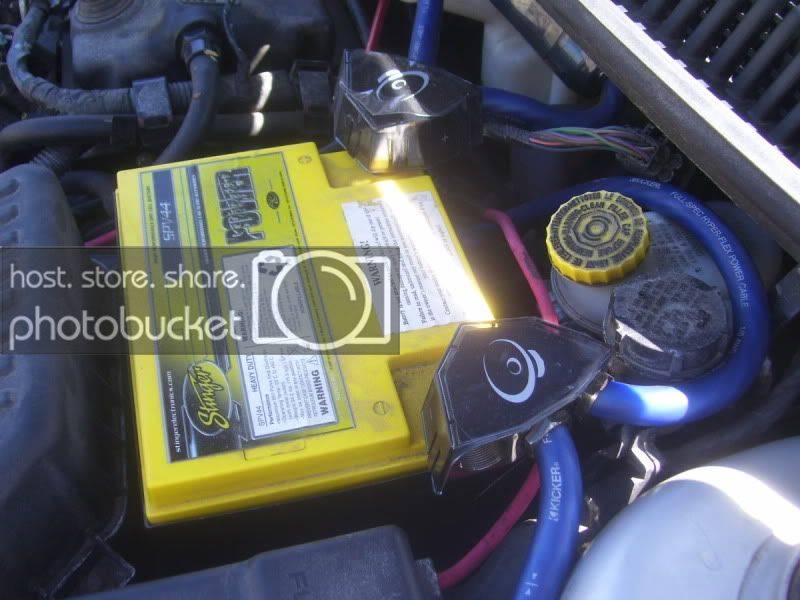

Looks very good! //content.invisioncic.com/y282845/emoticons/smile.gif.1ebc41e1811405b213edfc4622c41e27.gif Thanks for taking some time to take pics I really appreciate it. No need for ring terminals if I will go with this on the battery side.

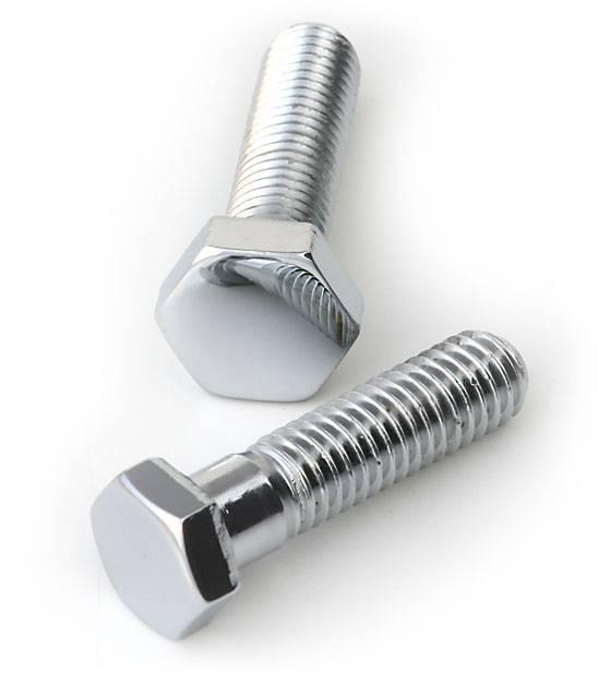

you can get the marine terminals at any local auto parts store. idk the ring/bolt size. i would imagine it would vary. but probably ~3/8"
Ok. Thanks.
To bolt the ring terminals to the battery //content.invisioncic.com/y282845/emoticons/confused.gif.e820e0216602db4765798ac39d28caa9.gif
how in the hell would you do that? //content.invisioncic.com/y282845/emoticons/confused.gif.e820e0216602db4765798ac39d28caa9.gif
unless we're thinking different kinds of batteries...
