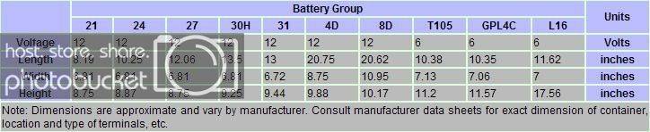

Battery Group Size
To further complicate matters, manufacturers for marine batteries make them in all sorts of sizes and voltages. Battery case sizes are typically denoted by a "Group Size" which has nothing to do with the actual size of the battery. For example, Group 8D batteries are much larger than Group 31 batteries.
Table of Battery Group Sizes, Voltages, and Approximate Exterior Dimensions
The group size will merely indicate the approximate exterior dimensions (including terminals) and voltage of the battery in question. However, the exact dimensions can only be directly obtained from each manufacturer.
