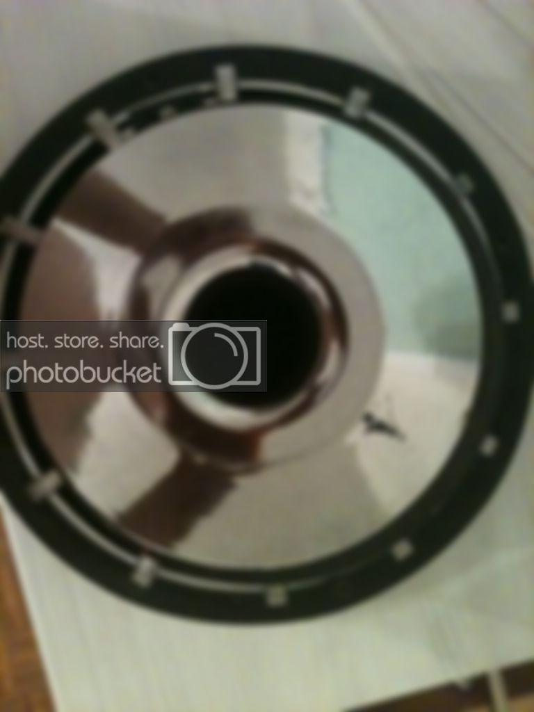

One the way home, I didnt have highs. No clue whe the hell the problem is there BUT, I thought I had blown my sub amp, nope, it was the sub. I just went out and pulled the sub amp out and took a look inside, nothing burnt. Went and tried to push the sub in and shes locked up.
Also, tried to start my truck just now, and I have no power what so ever. Not even enough for lights to come on.
I had my gains set correctly, so the only thing I can think of is either one of the VC's took a crap or the amp some how screwed the driver up.

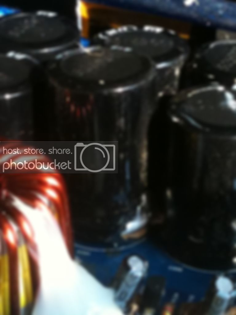

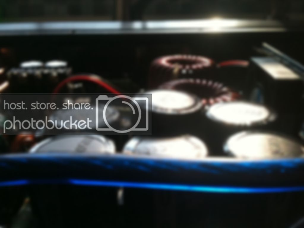

Just took a closer look inside the amp and there is something shot in there //content.invisioncic.com/y282845/emoticons/frown.gif.a3531fa0534503350665a1e957861287.gif
Sorry for the crappy phone pics but you can see what happend.
Im going to ask this in the amp sectioin but does anyone know if this can be fixed?
I also noticed this....
