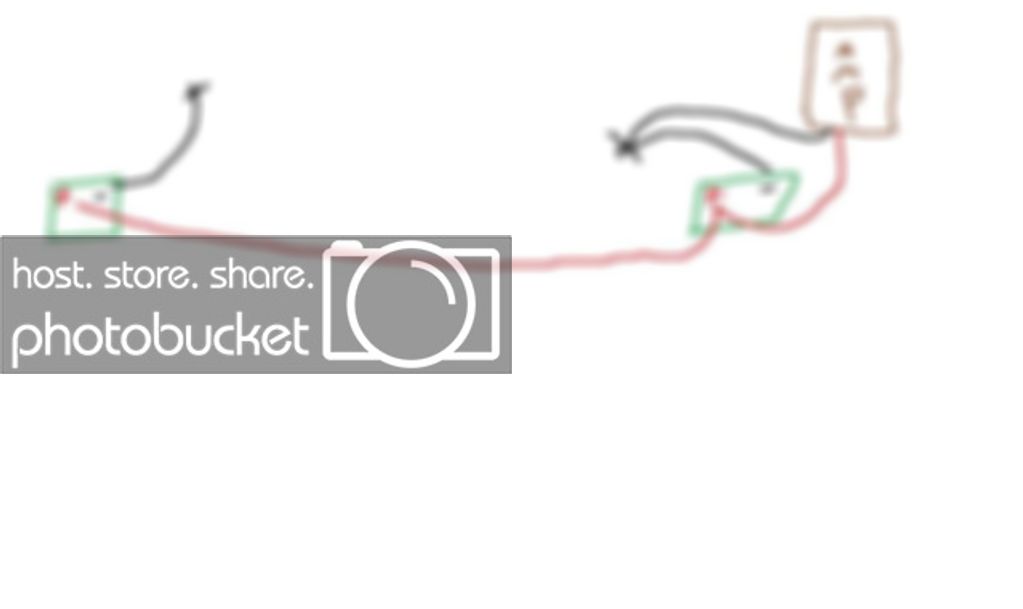

Do I have to have a ground run from my front battery to my back battery? Or can I just ground the back battery to the same spot I ground my amp to? Last time I tried to, I just grounded the back battery to the same place my amp was, and it smoked. I didnt know what the problem was, but I forgot to reconnect to front battery ground. once I did that it didnt smoke. Maybe it was because I had already partially blown the amp? I just got a new amp and I just want to make one power run from the front battery to the back battery and ground the back batteyr sperately. I really dont want to smoke this amp

I would run your amp's ground directly to the rear battery's negative and then ground the rear batt's negative to the chassis if youre doing it that way
yes.
*this is what i meant im doing. im doing both of my amps power wire to my rear pos bat, and both of my amps ground to my rear neg bat and just grounding the rear neg batt.
