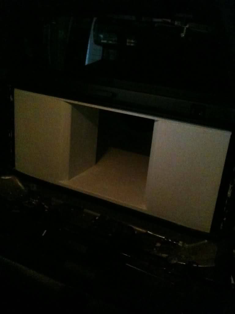

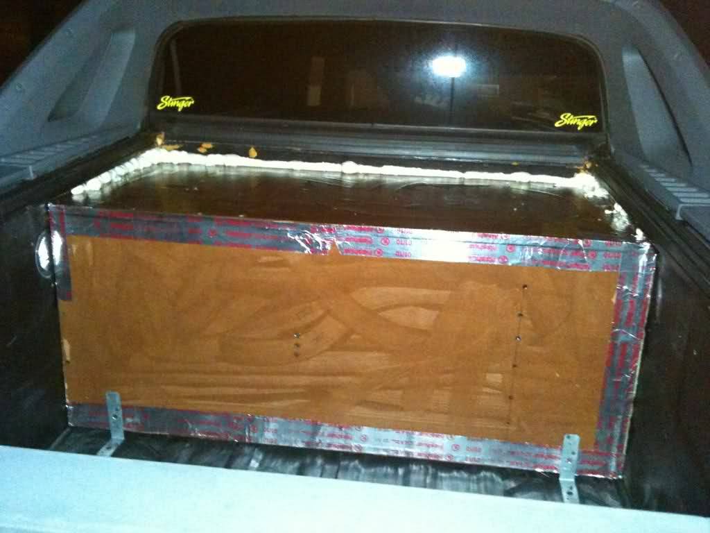

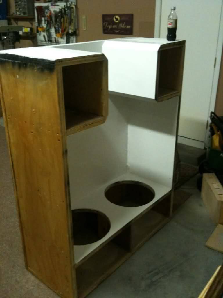

This is the setup coming out. Was a Dayton DVC 15 on the back of my 4ch. Was actually really loud. It was just a temp setup though. Box was a 4th order. Got down. Really efficient, clean, and just the type of response I liked. Low. Was 15 cubes externally for 1 15. Had a nice peak @ 31hz.
Vids as a test with it sitting in the back seat.

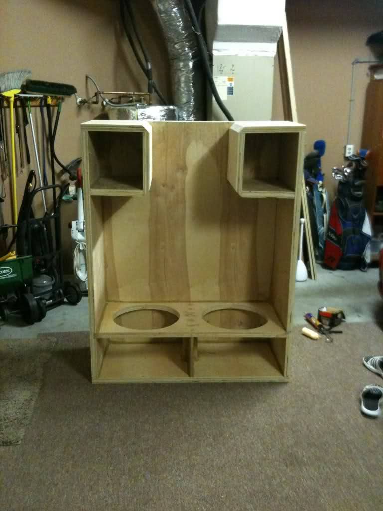

Anyway, thats gone. Heres the new highs. Decided not to use those tweets because 4ohm wont work.

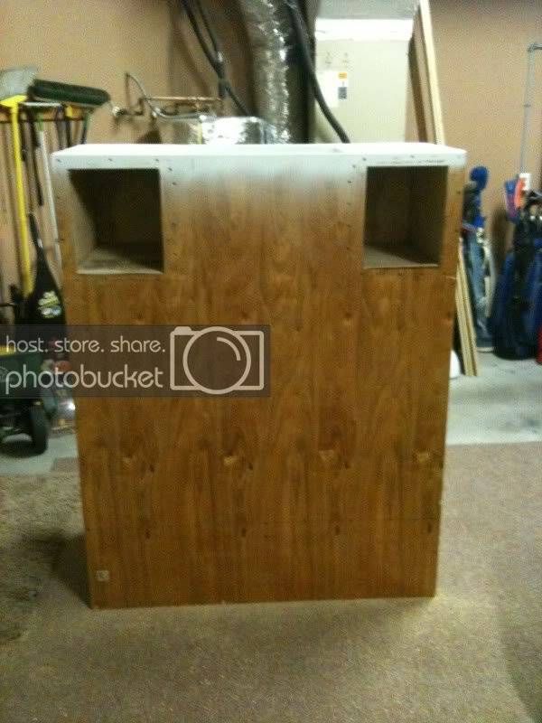

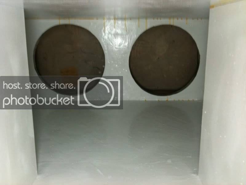

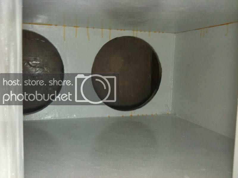

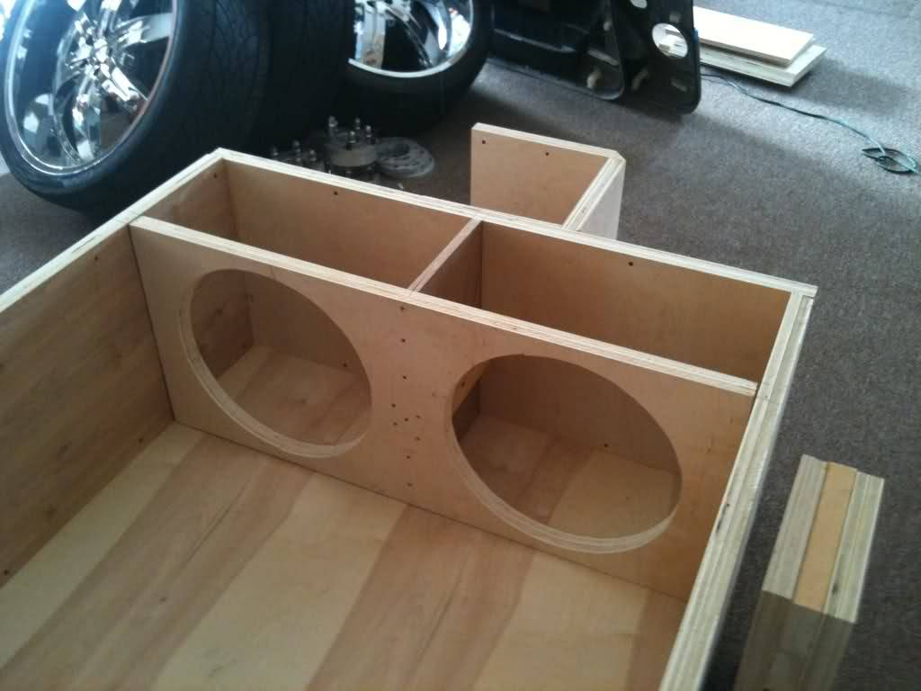

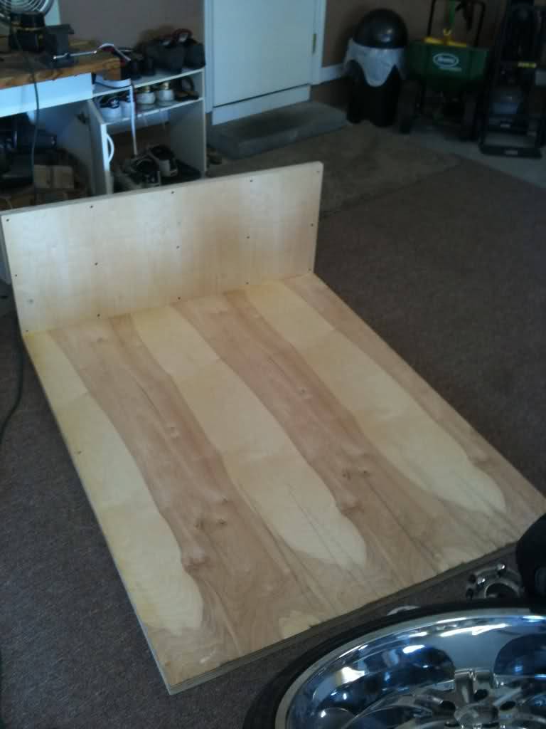

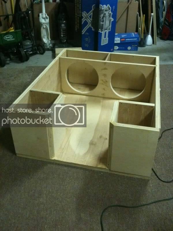

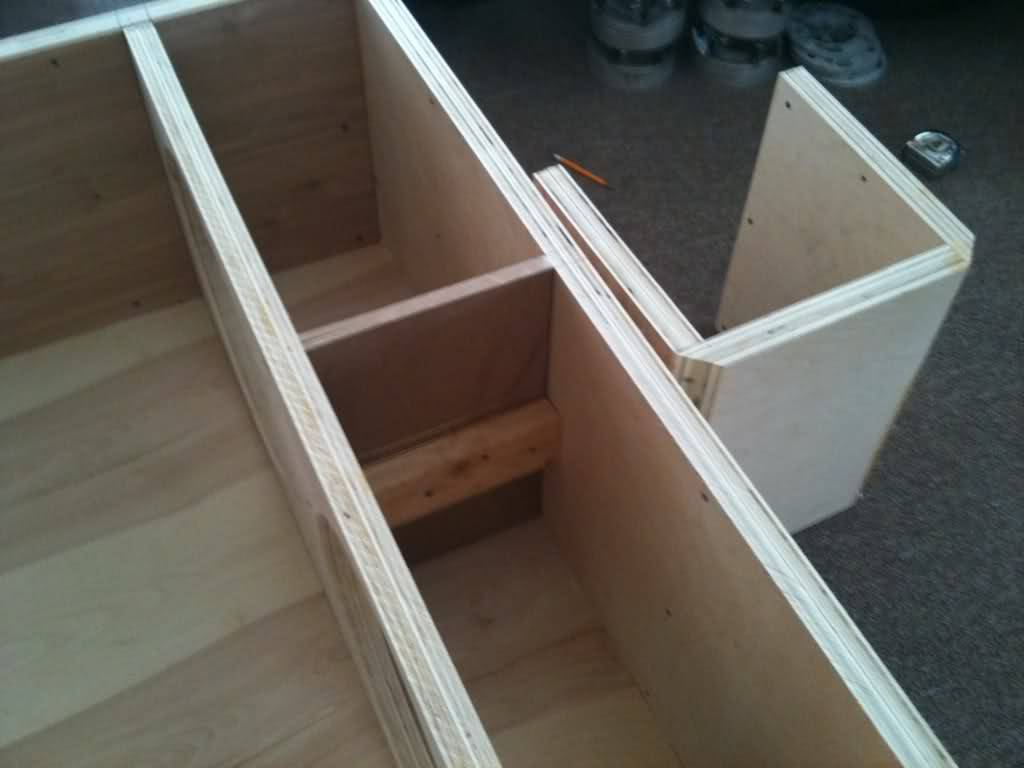

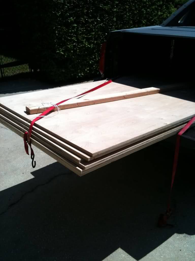

New box. 2 18s in a 4th order. Entire box is double layer Birch and its completely resined, inside and out.
The Selenium D250-X are horns. In the pic, I have of some 6s, a pair of 10s, and some DB Drive Bullet tweets (which Im selling).
