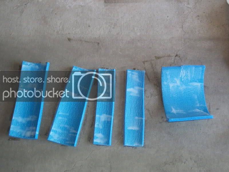

The CCF I used is a 3/8".

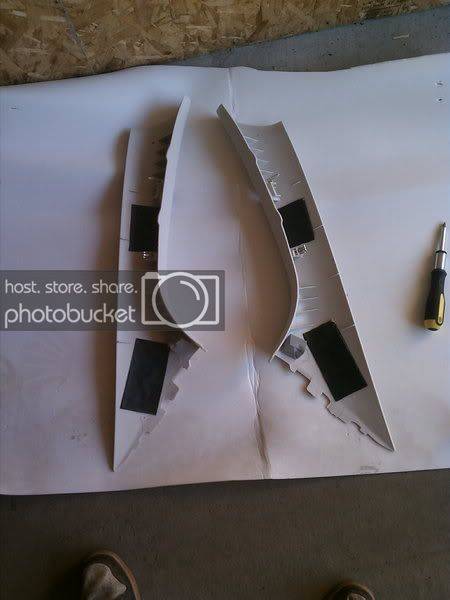

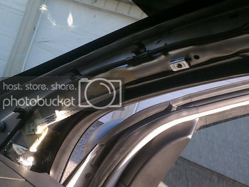

While I was in there I tightened up the clips so they hold the trim pieces as tight to the metal as possible.

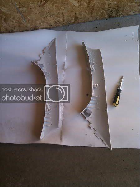

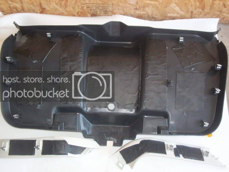

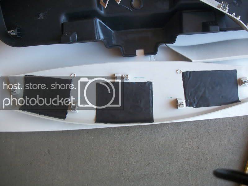

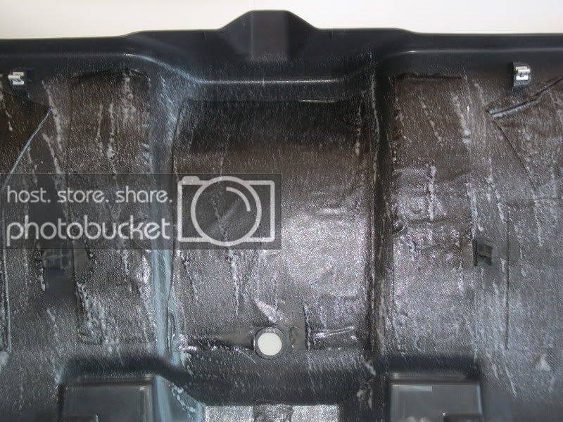

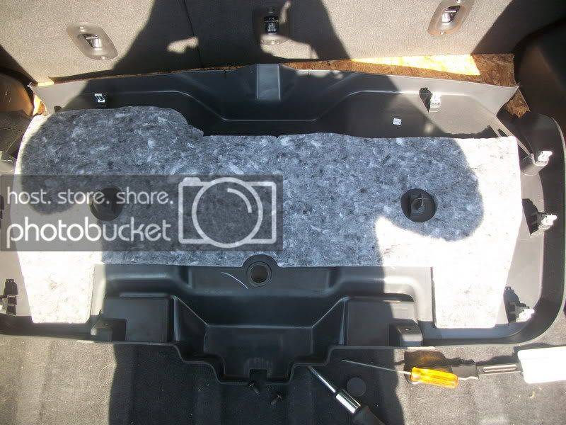

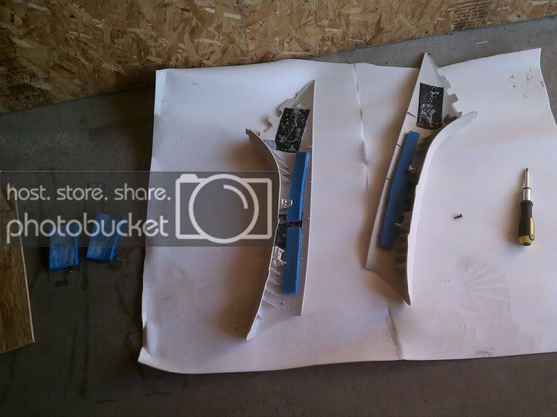

Here you can see the basic ideas of the process. I got in a grove and forgot to take pictures of the last pieces. Over all it took about 2 hours to disassemble, deaden, spray, apply CCF, and reassemble. Pretty sure I added about 15 pounds to the hatch area during the whole thing.

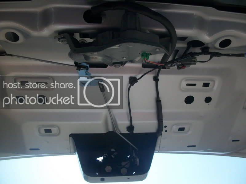

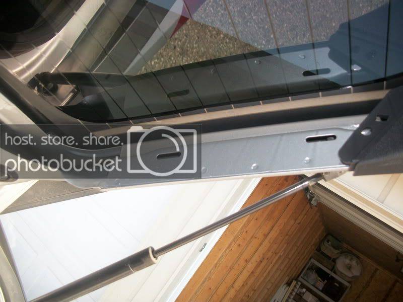

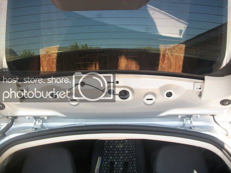

To take apart the hatch you remove the two screws from the bottom of the lift gate near the handle to pull the hatch closed. Then you just pry off the top piece, then the side pieces, and then finally the bottom half comes off. They are all connected via metal retaining clips.
Here is everything removed:

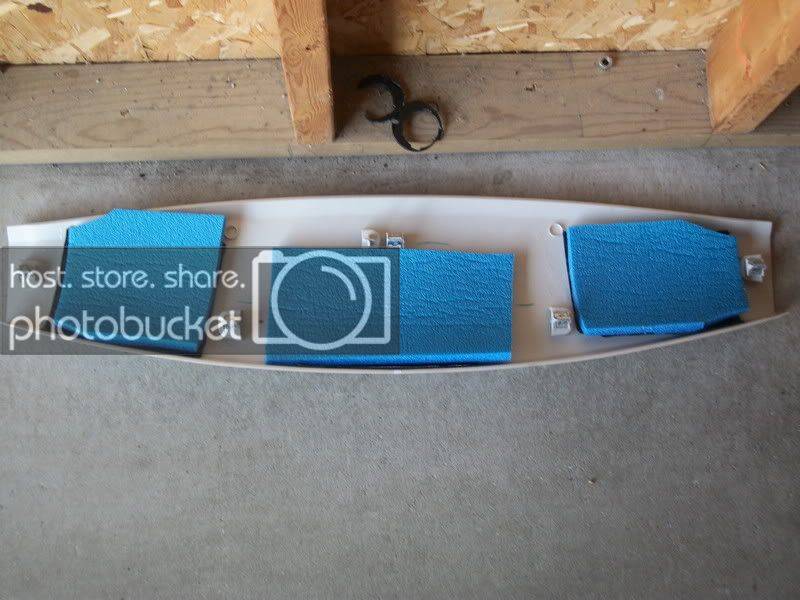

This is the bottom piece before I got to work. I removed the factory matting there. Applied my deadener, applied my CCF, and then reapplied the factory matting.

Which ones? I didnt fill any of them but there are some in the A Pillar that are filled from the factory.
Well all of them I guess. Anyone who has foamed the hollow cavities can tell you it is a world of difference. Front has factory foam because they know it works wonders. I use to work for an insulation company. We used a 2 part foam for sealing up houses. I been using that as I can drive up and snag some:)
