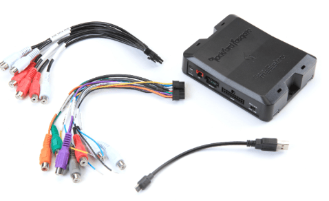

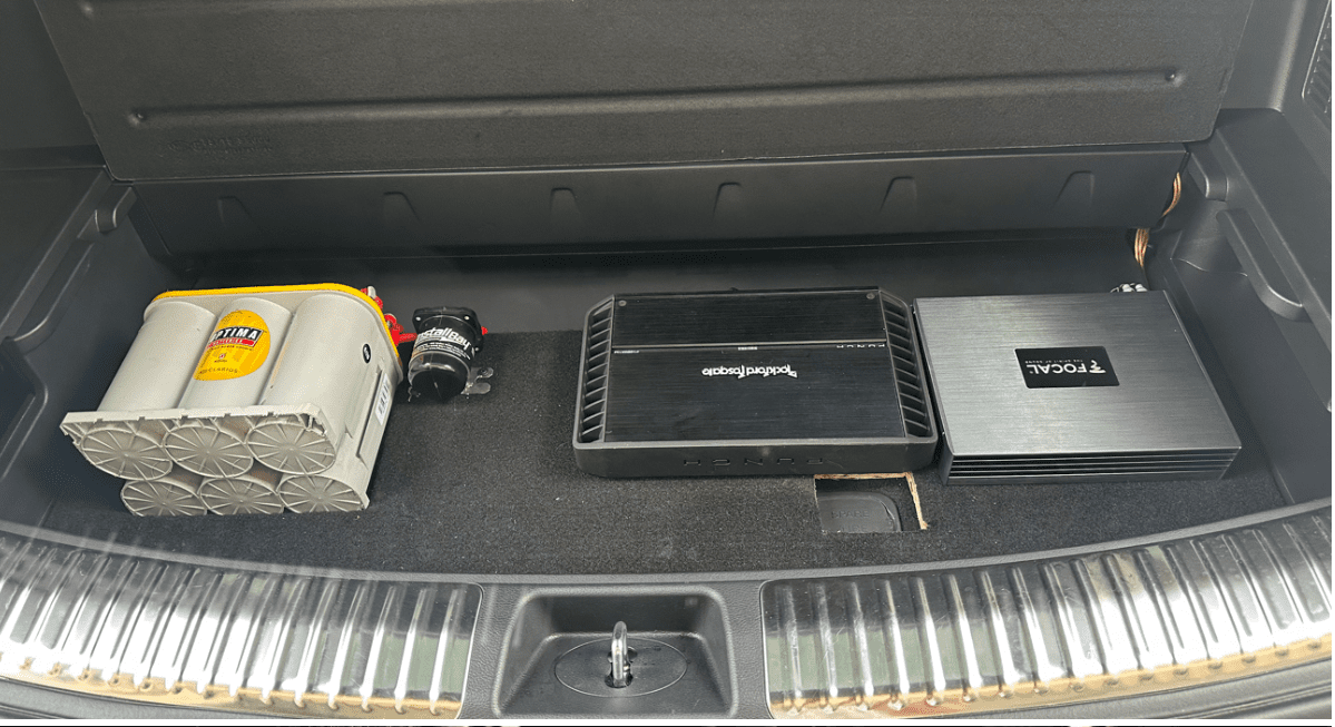

for the DSP get a DSR1 rockford, thats what i am running. I have Focals K2's all the way around and a Focal 4ch amp, 1000 watt rockford amp, 2-12 p3's on my 2023 Xline Telly.
Yes. Works great with the DSR1 Rockford.
Im running it all in my 2023 SX Xline Telluride. I had a diffrent setup in my old 2020 telluride S model.

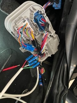

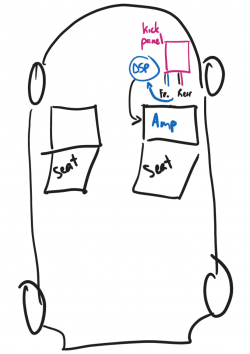

Awesome! I saw in anther forum, both speaker pairs (Front and Rear) can be tapped in the passenger's kickpanel to feed the DSP. It sounds like running fresh speaker wire is a PITA through the doors. I wonder if the DSP could tuck near the panel and an amp under the seat? Berryboy, where's your DSR1 mounted? Are you just running speaker wire back up from your rear-mounted amps to the kickpanel for existing OEM speaker wire?

@rooty-j someone on the Kia forum made a breakout harness thats all color coated and labeled ....All my speaker wire is running directly from the focals. I wanted to use all copper wiring. see below:
This made it so I didnt have to tap into the main harness. makes it super easy. You can see how I had both my old and new set up below.
Old Setup: 2020 Telly S model
Didnt get to show you the dsp in this pic but I tapped it in the wires you see coming out the right side from the back seats and it was sitting on the side panel.
New Setup 2023 Xline Telly:
just much cleaner with the harness. I say pick one up from the guy like I did. You could just tap the DSR1 right under your seat if you needed.
Check out this thread here: https://tellurideforum.org/threads/h-k-amp-speaker-breakout-harness.13891/
