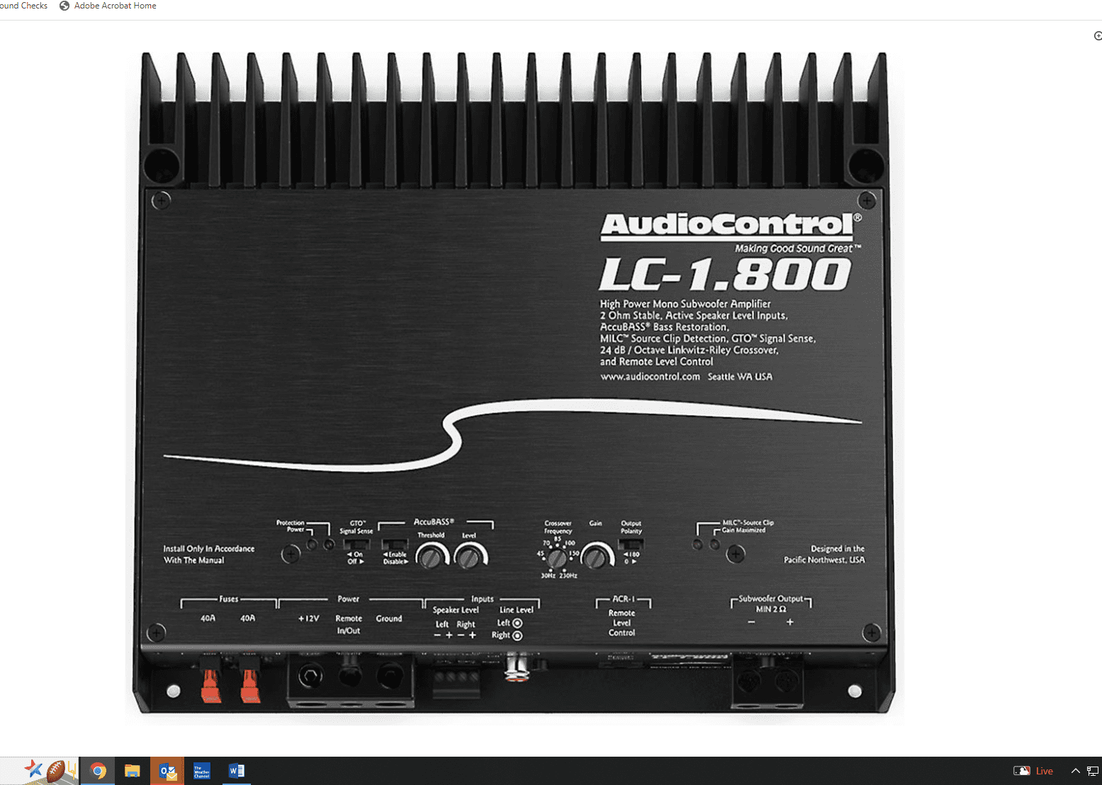

You will not need the LC2i Pro if you are running the LC-1.800
You have speaker level inputs on the amp as well as accubass to correct the factory bass curve if needed
Interesting....as the AudioControl rep said I needed that as well...but was confused as I THOUGHT you didn't with that amp! :)
Oh, yeah, that even has bass restoration in it! WTF
THANKS!
THANKS!
