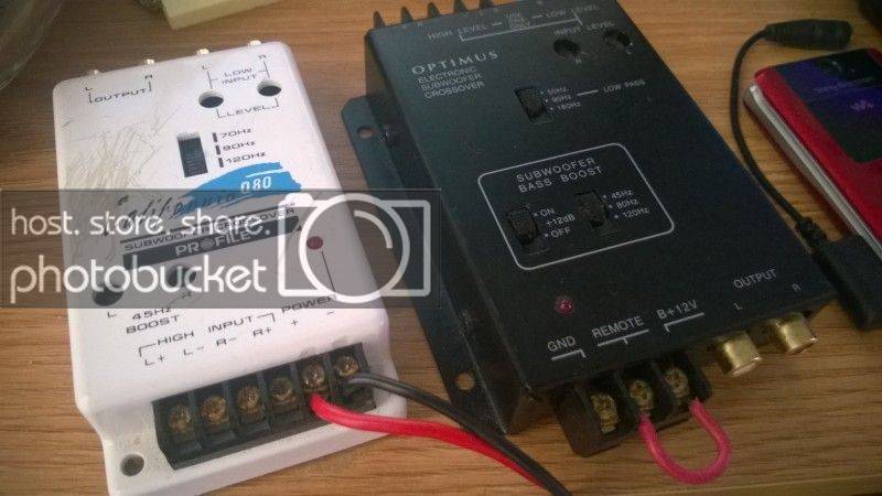

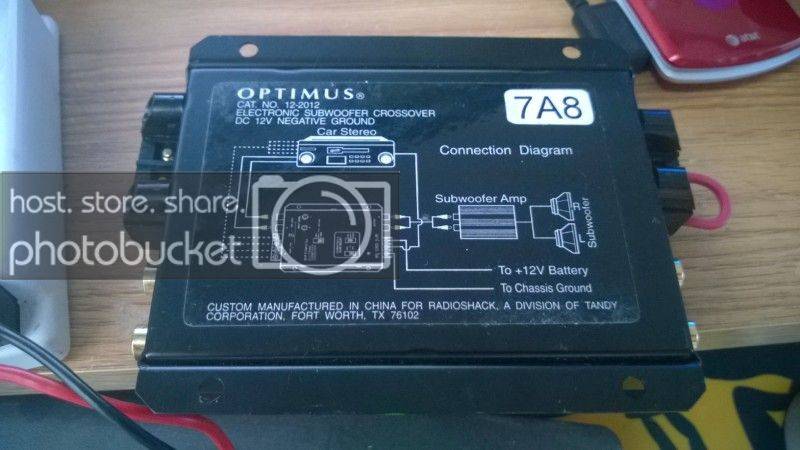

But I have these from my car way way back:
Do these work as line drivers or... no.
You'll ask why I think a line driver might help her case?
Because I threw in an ancient pioneer HU into her car we had laying around and even turning up the amp's (Alpine mrp-450; says 250w @ 4ohm) level to the max it doesn't match what the volume should be for the music playing. She ended up putting the bass level on the HU to max, the treble down, and putting the fader to the rear 6x9s to get more bass. I don't like it but it is what it is. So I've read it may be remedied by adding a line driver to boost the signal to the amp so that proper levels can be set.
They work as line drivers if the output signal is higher voltage than the input signal voltage. Most of them do both, the specs should say
here's a good example http://www.amazon.com/SX310-Pre-Amp-Electronic-Crossover-Subwoofer/dp/B001TE5YWU
if your hu puts out 4v max, 2v rms then the crossover i posted would amplify the signal to 8v max 4v rms (if the manufacturer doesnt lie about its output).
measure the max voltage out from your headunit RCA's with a DMM set to ac volts to see how bad it really is
Just wanted to update that a line driver completely fixed the issue. All the threads I read about them with negative comments almost made me not do it but since I had them laying around I tried it. Previously gain at 100% just didn't match the volume of the music. Crank up the volume and ... Meh, hardly any bass. Now with the gain at around 1/4 and its perfect and hits.
