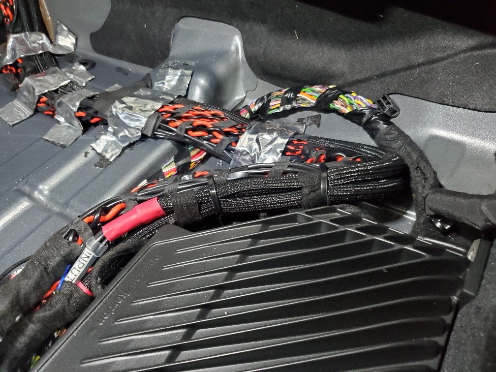

The OEM Hardon Kardon amp is located under the passanger seat. This amp and the processing inside of it may be essential into some of the tuning i do for the 2 seat tune/setup. Regardless of what you think, Harmon has more advanced processing and upmixing going on in here than anything that is offered in the aftermarket. Might as well utilize it, while also giving me access to all speaker wires since the molex plugs on these door specifically make it seemingly impossible to run new wire. These make Mazda door molex plugs look like a walk in the park. I will most likely have to drill a hole and make another boot to get a wire to the tweeter since the oem midrange and tweeter are on the same channel with a basic passive crossover at the tweeter. At the end of the day, i have to grab 10 speaker signals from this amp. Front left and right midbass, front left and right highs (midrange and tweeter), front center channel (2 mids and a tweeter on a passive crossover), rear left and right doors (passive 2 way set up in the door), left and right rear deck speakers, and sub. The reason im deciding to grab ALL of these signals isnt because its necessary. Its because i want to, again, utilize the Harman processing to its full potential and have the option to use or not use whatever signal may or may not work. I have a reason to believe that the rear door signal and the rear deck signal are not the same. I will be evaluating the signal soon enough and post my findings. Unfortunately the Helix DSP Ultra only has 8 channels of analog inputs, so i will probably put the rear deck signal into the V Twelve so long as it is a clearly different signal than the rear door speakers. I will not only have to test for response, timing, phase, and input mixing on that channel, but also signals unrelated to music, such as back up beeps, etc.
OEM amp removed. The harness doesnt look like much.. but it will when 23 pairs of speaker wire are run to/from here, as well as 5 extra pairs of accessory power/ground wire and a single turn on wire just in case. 57 wires total. im not even sure how i fit it all, especially considering i ran out of Stinger speaker wire and had to borrow some home audio style wire from another installer i know locally (Thanks Chris). This stuff was stiff as hell, had an extra external jacket, and was a pain to work with since it was so stiff.
So, the green plugs with the harnesses shown above are the outputs of the amp that feed into the processors/amps. The amplifier outputs were then wired to the oem speaker wire harness. The 5 pairs of extra power/ground are under the carpet on the left in this picture, and the 3 extra pairs on the right are to run extra wire for the side tweeters, and the center midrange. Its not as pretty as i'd usually do it and would like it to be, but I cannot stress enough how hard that wire was to work with, let alone when there are over 20 runs of it in one bundle underneath a molded foam backed carpet.

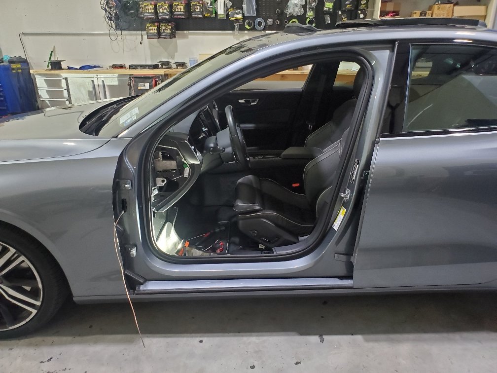

Next up was getting the wires run into the door for the tweeters. Since the OEM midrange and tweeter were tied into each other passively inside of the door, we needed to run a wire through the doors molex connector. From the outside, this one really looked like it was going to be a disaster and i would have had to make a second boot. Thankfully, the molex is easily removable, the door is easily removable, and the molex even has a hole on the bottom that can fit a run or two of thin speaker wire through.. perfect for midrange and tweeter. I used the OEM wire for the midrange and ran 18 gauge speaker wire through for the tweeter
Said molex connector. The hole in the bottom is large enough to run some thinner speaker wire (16, maybe 14 gauge max) through with ease. I used 18 gauge
Door off and running wire through
