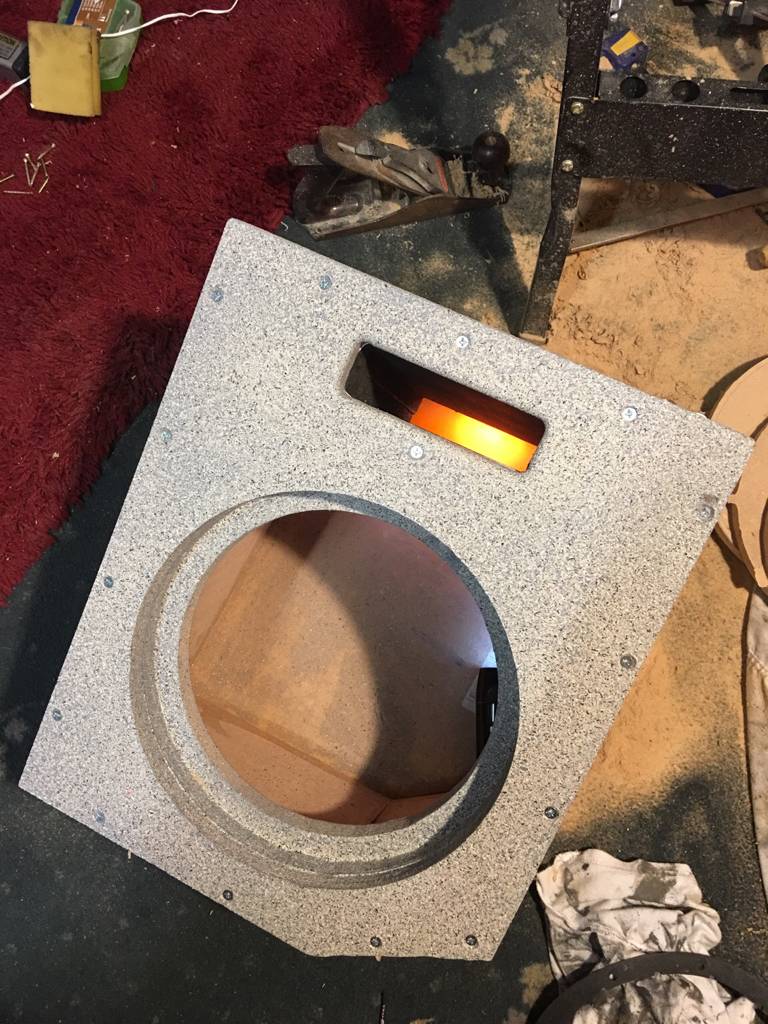

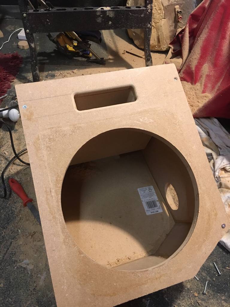

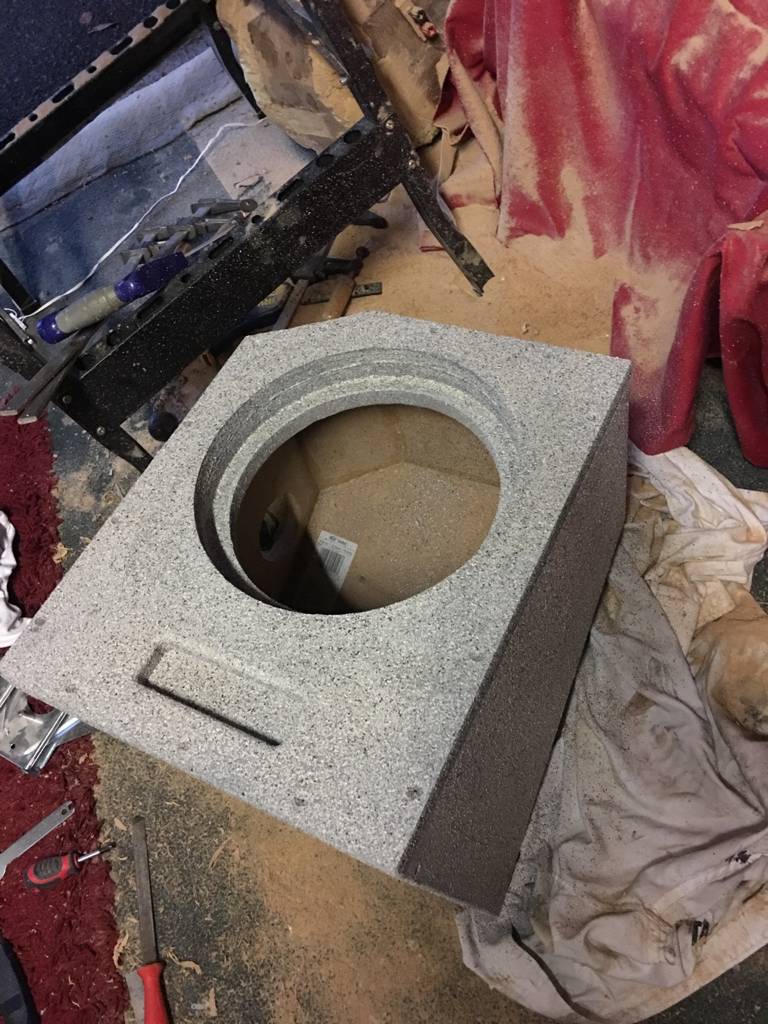

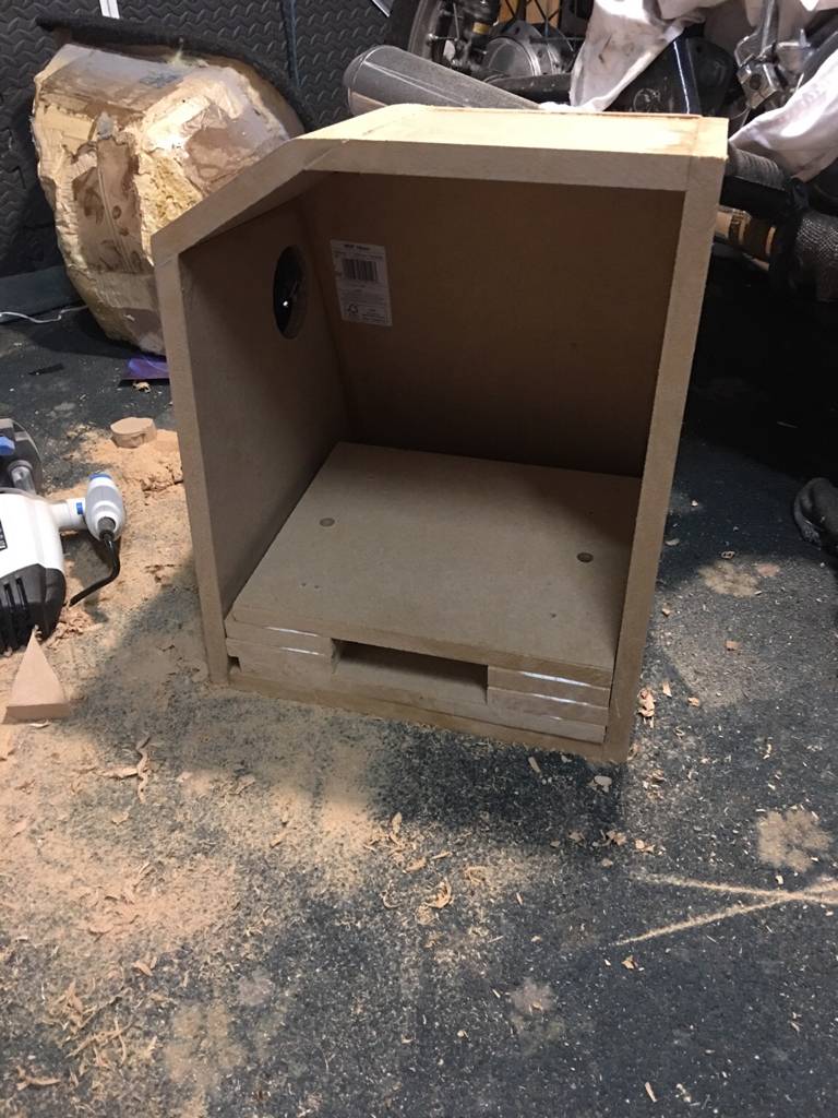

Port made

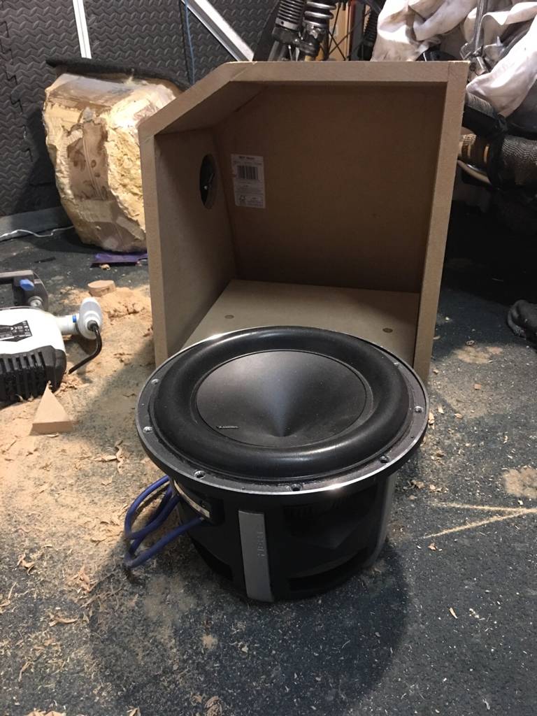

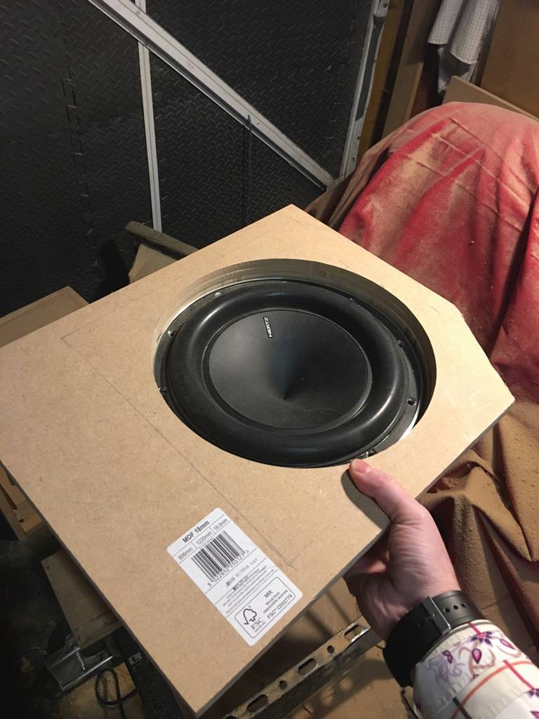

Got the sub out of the old box
2 recessed and the mount

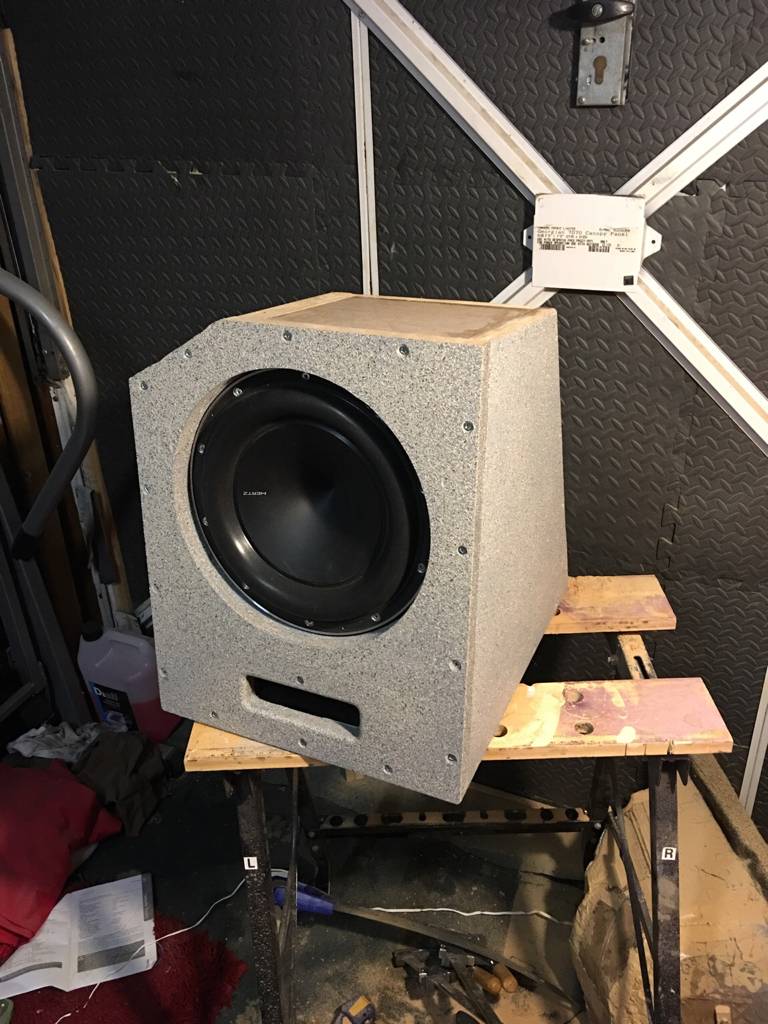

Slot port looks ok on front face
Looks pretty nice. I hope you're not using too much power. The other main issue about trying to tune low in a tiny box is that port volume starts to become really huge so you either shoot yourself in the foot by having to make the box really big just to fit the port, or you skimp on port area which can lead to troubles. On the bright side, you can easily get some weather stripping and a small scrap of wood to seal off that port for testing.
It's a little late now, but port placement on the box (or more specifically where it fires in the vehicle) can make a dramatic difference, though this is exceedingly hard to predict and the ONLY way to optimize is either testing or talking to someone who has actually tested in the same vehicle.

The box recommendation was 77.5 dia x 250lg so my 36x130 slot is the same area and 250lg as suggested.
There is 80-100mm space behind the port so shouldn't effect it.

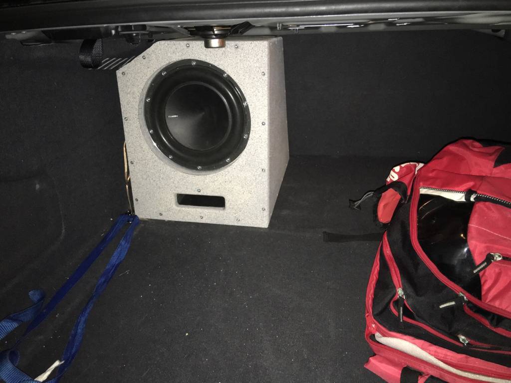

The box is wedged against the back seats with the sub /port face facing the back of the trunk. Time will tell if this is a good layout.

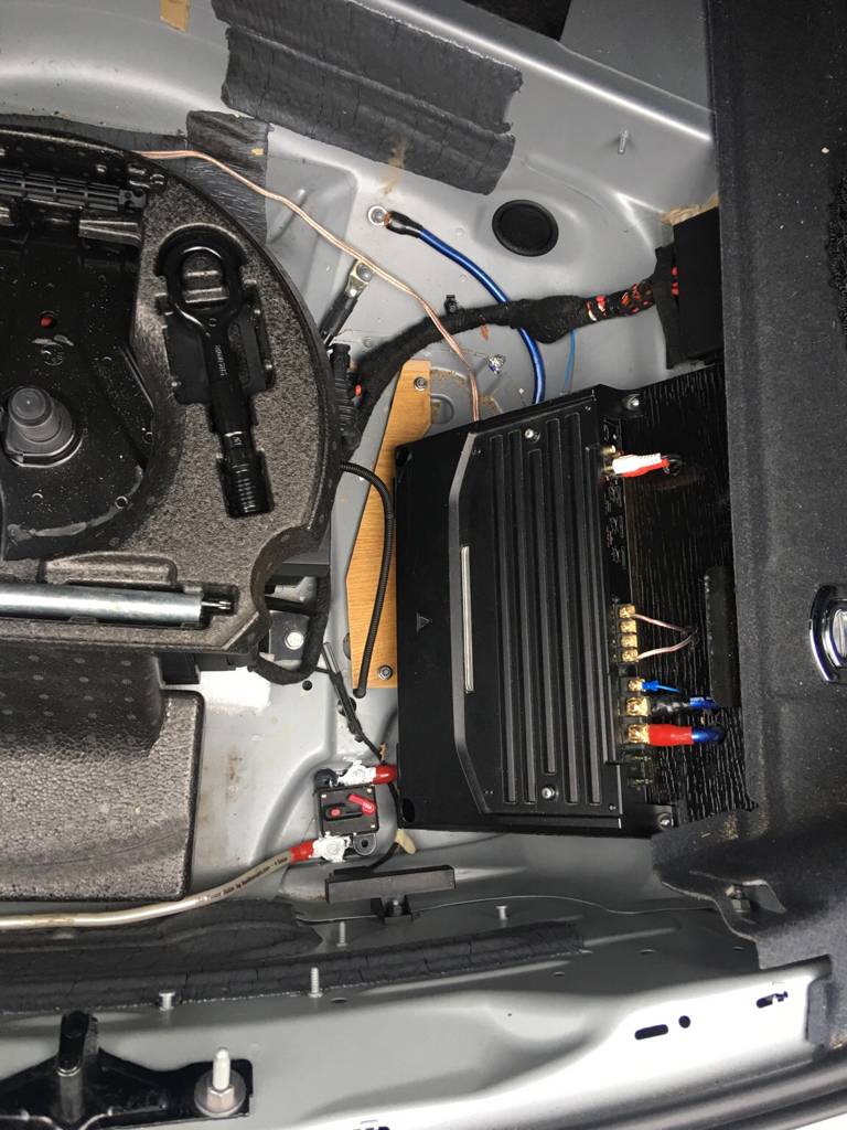

The sub is rated at 500rms 4ohm and my Kenwood 9106D amp is the same for 4ohm.
I'm only using 4ga power/earth but the battery is in the spare wheel right next to the amp so runs are real short

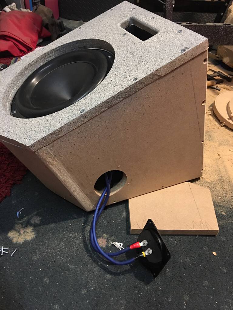

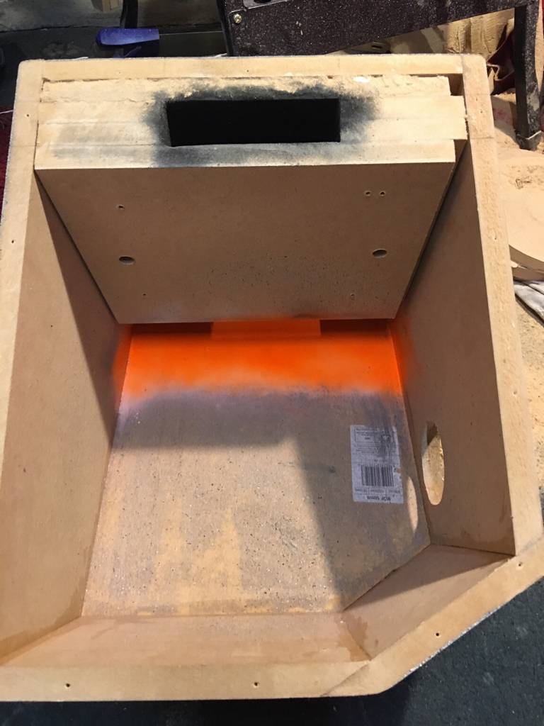

Some fluorescent paint on the inside back just for fun
Wired to the terminal plate, used the wiring from the old box so it has to go in with the terminals on the plate side so the 'hertz' logo is upside down [emoji54]
It looks lost in the A6 trunk.
