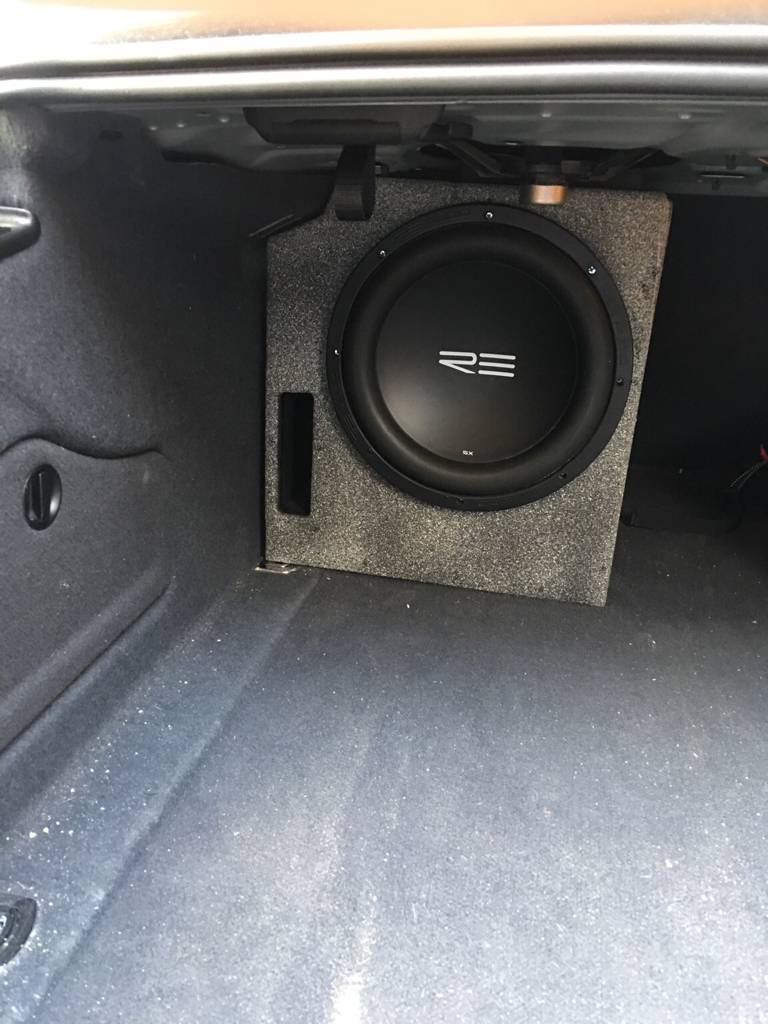

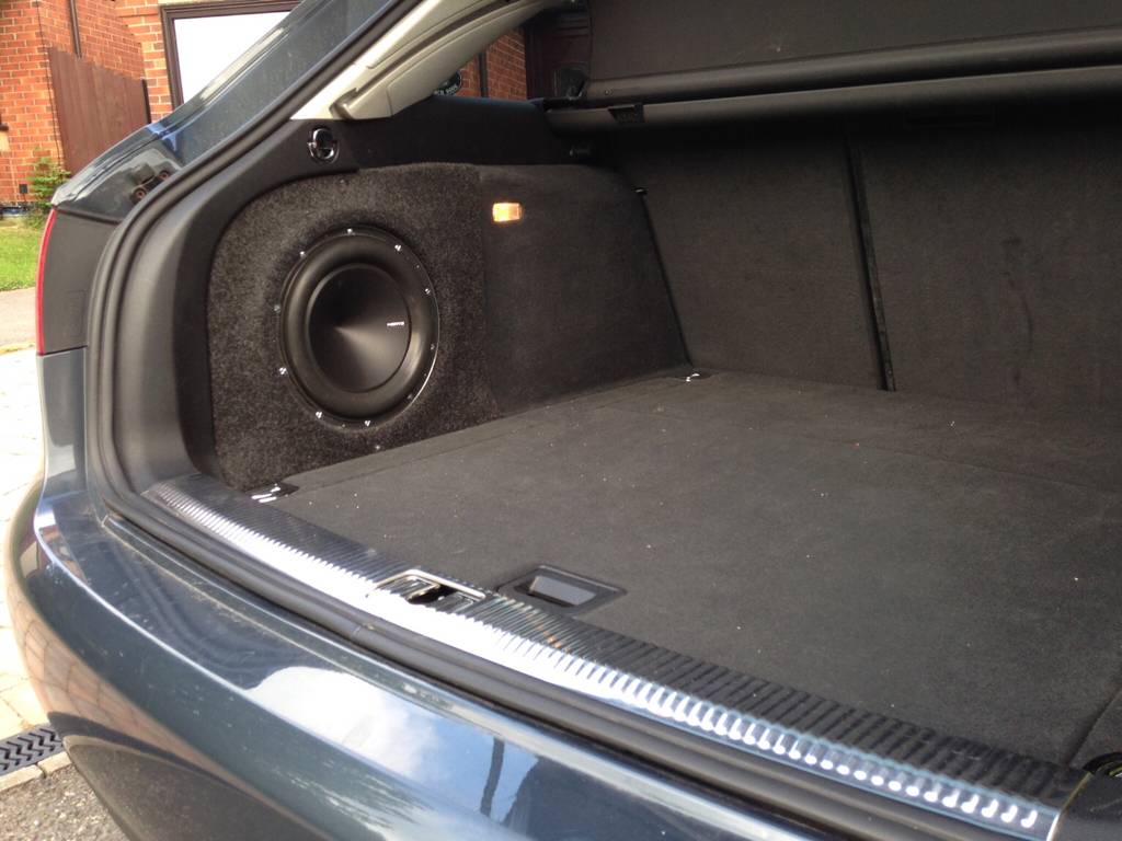

The sealed ML2500 way back in an FG box in my A4 Avant
True, the Hertz is a truly quality bit of kit. In the 0.5cu ft sealed box it really shone and kept my trunk space open for my bike and kids stuff.

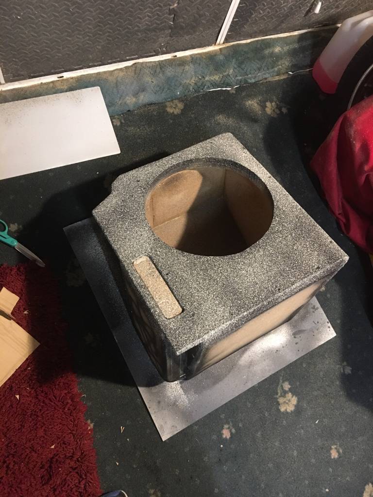

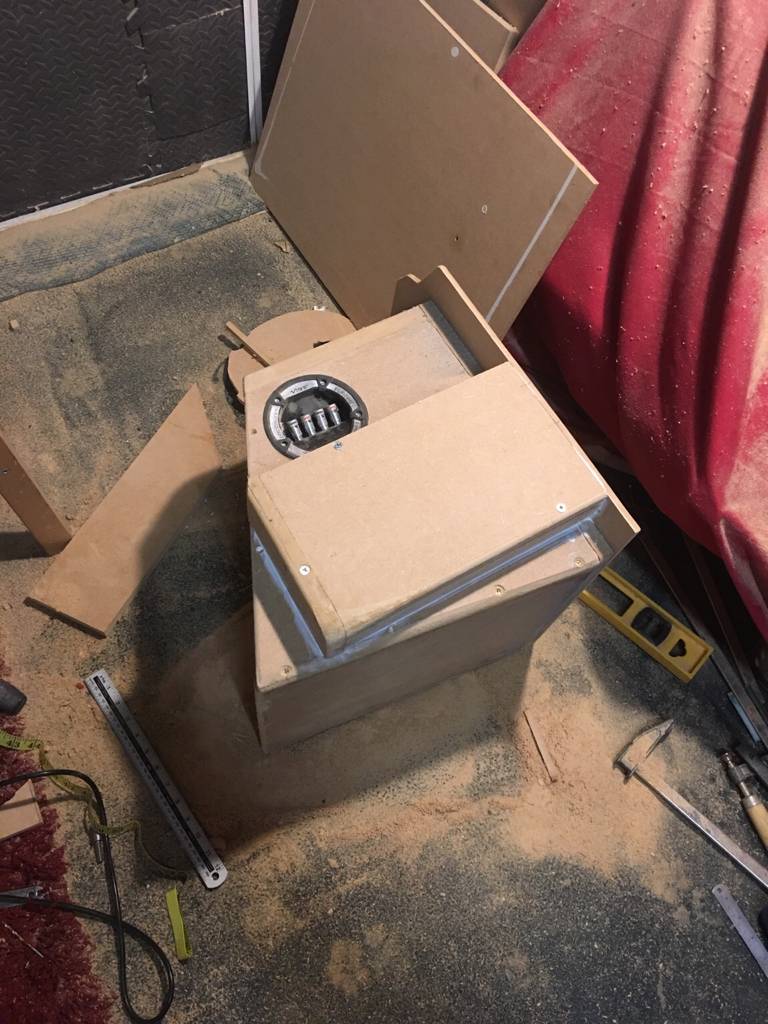

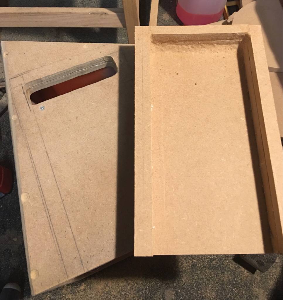

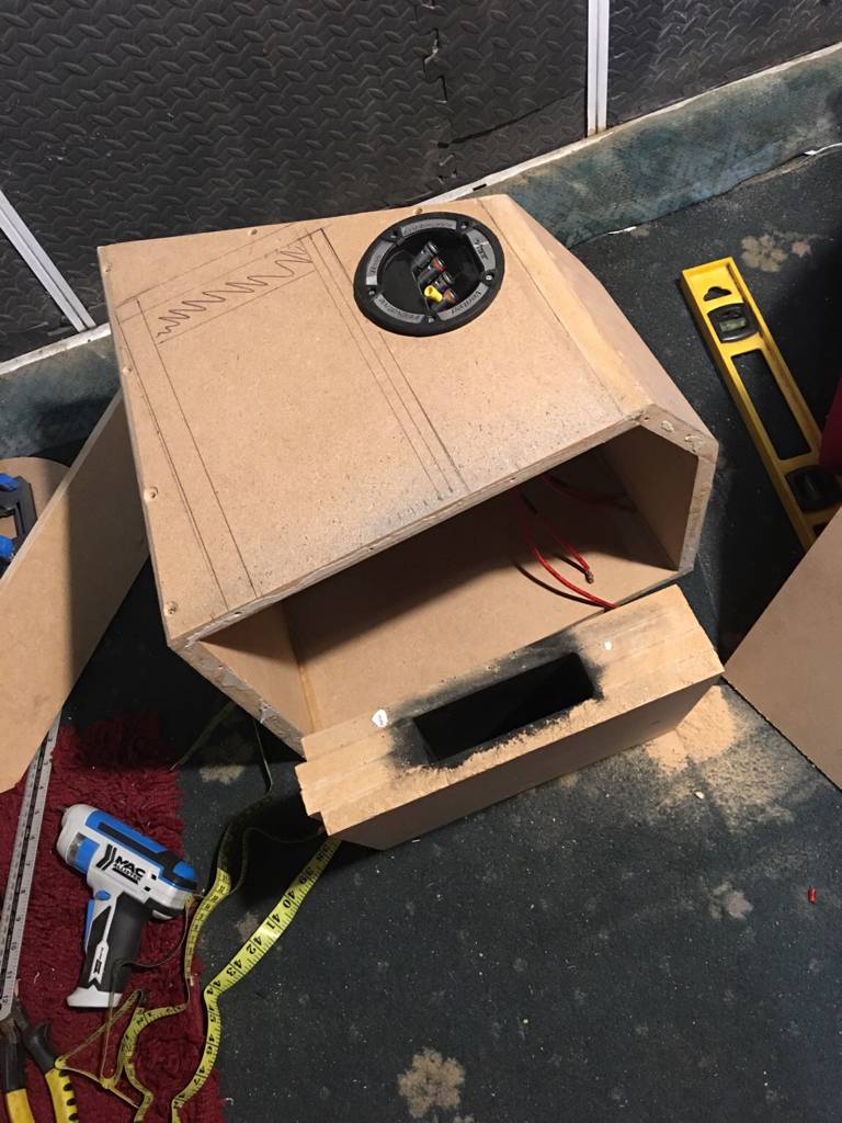

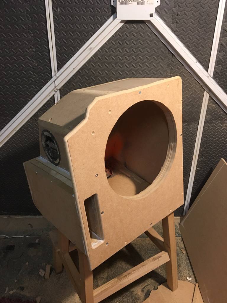

Box is out and under re-construction.
With the internal port out the volume is back up to about 34 L (1.2 cuft)

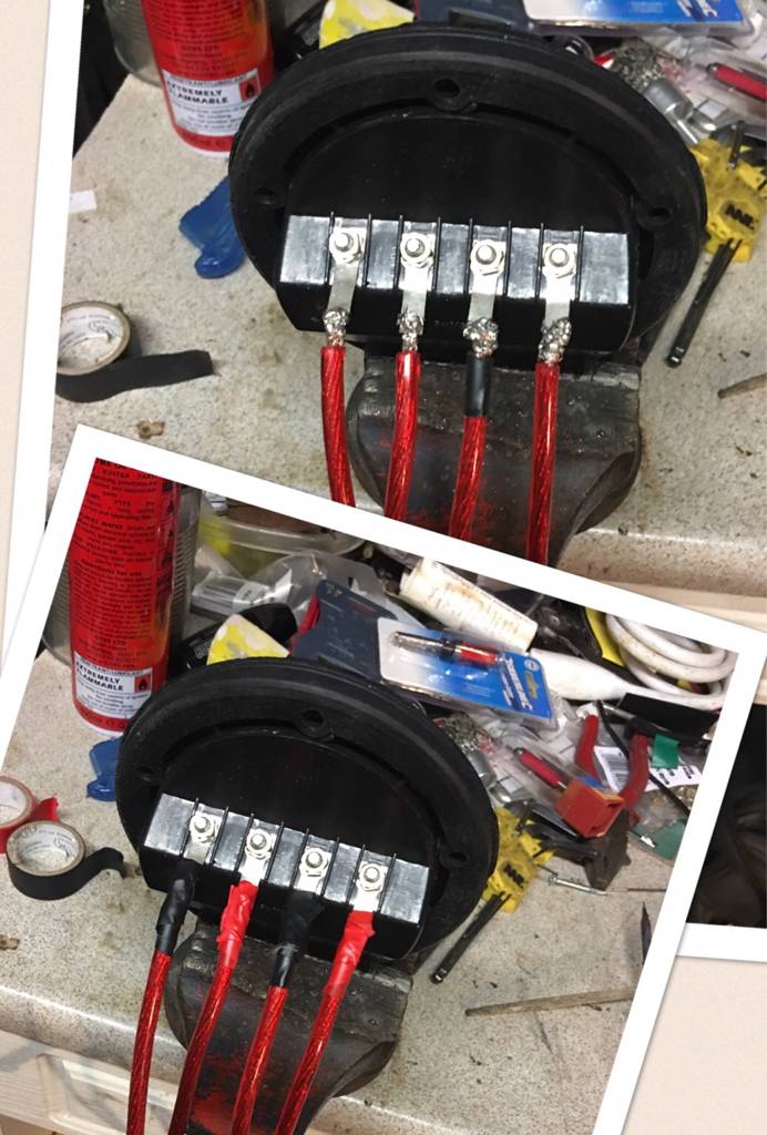

Got a new 4 post terminal plate, flushed it into the side

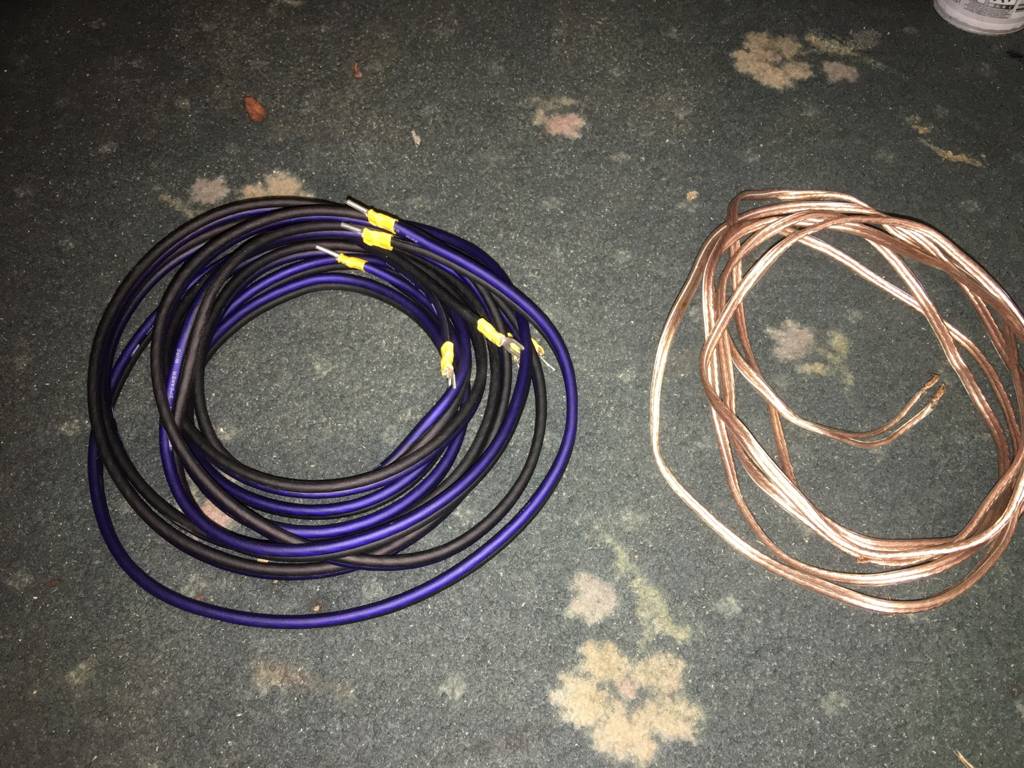

Soldered on the '8ga' power wire on, it's the same thickness as the new 12ga speaker wire

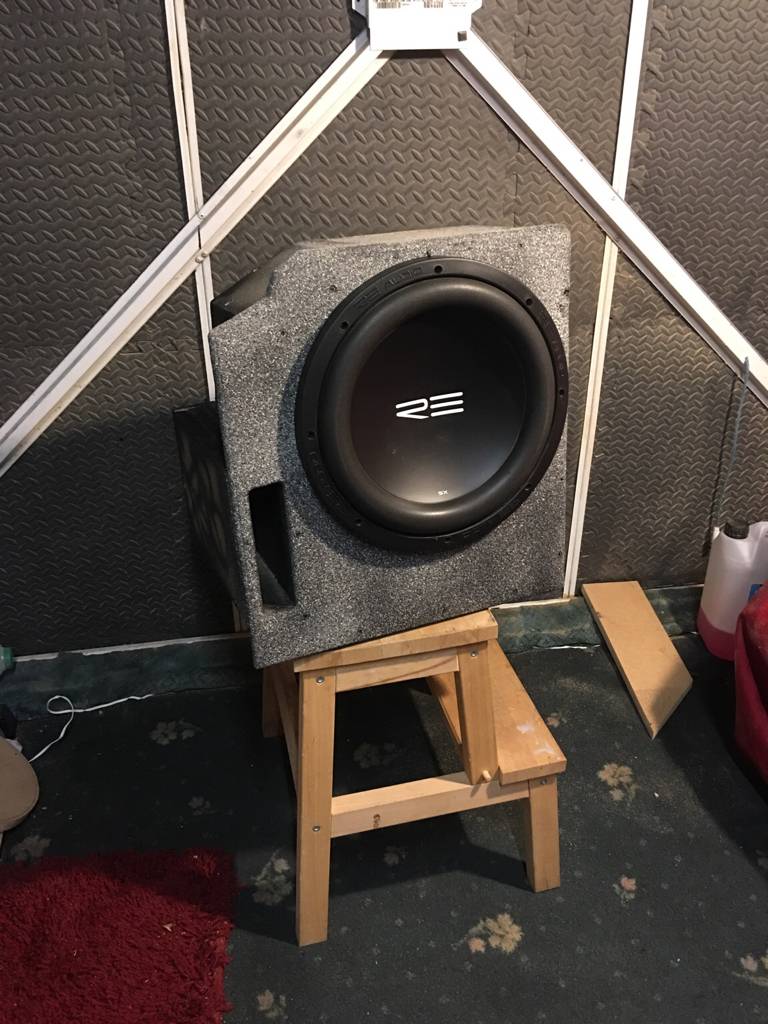

Made the new external port, tune is about 35Hz
It is a little, Re spec is 1.5cuft net for the 'compact' design and I'm more like 1.2

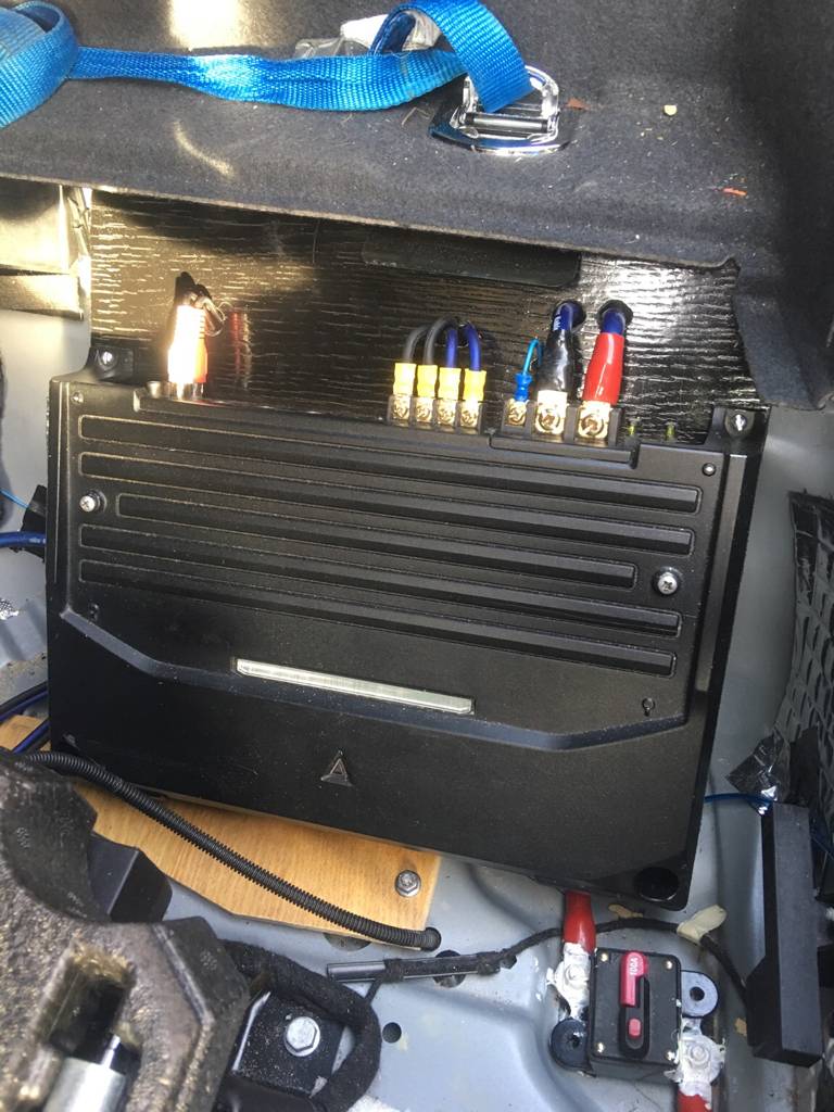

I will run it for a while like this, will be wired to 1ohm so amp spec is 900rms, no idea if it will actually do close to that.
Will see how the SXX and the amp (KAC9104D) play together.

First 1/2 hour out in the car with no kids...

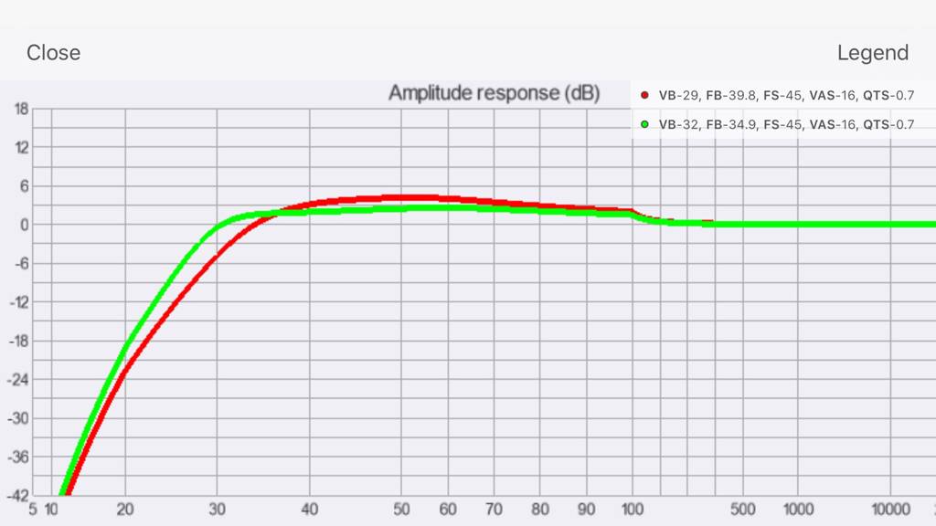

The box is much flatter through the lows now, it feels louder and the (admittedly poor) IPhone dB meter has it up from 122 to 124.3 on the same extended note in the same track as before.
The plot from the box calculator app is in agreement, getting the 3L back and tuning a bit lower flattens it out.

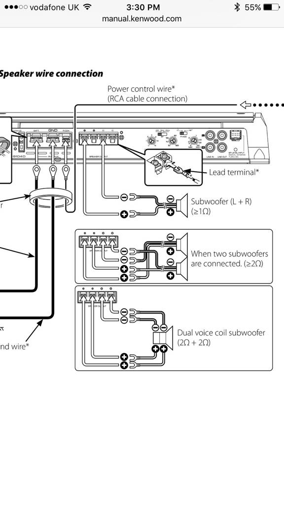

I have also wired each VC to the speaker outs on the amp as the diagram below, I'm not sure if it's now loading the amp to 2ohm or 1ohm?
