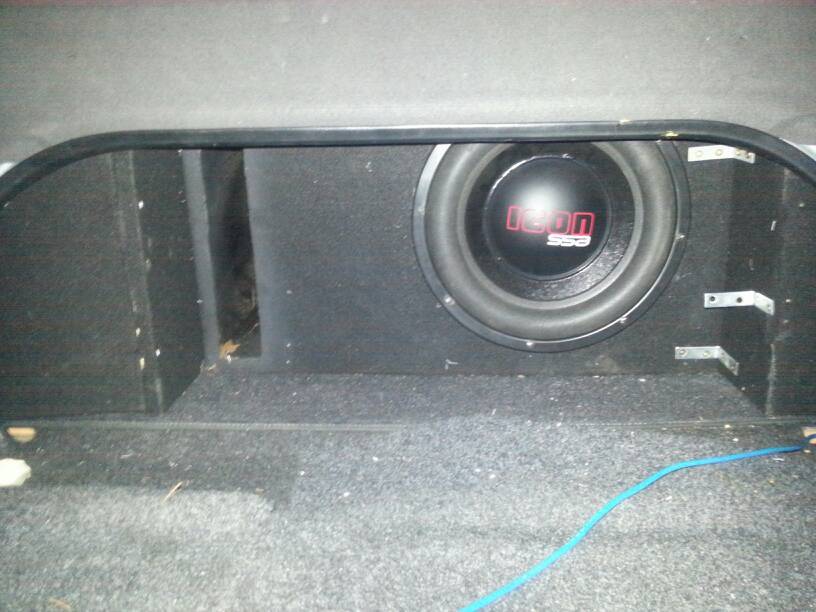

It's in the car now.
It's definitely extending the
The punch has suffered a little, but this may be that the continuous tones are louder.
I played with a signal generator and the peak seems to be more 35-40hz compared to around 50 before.

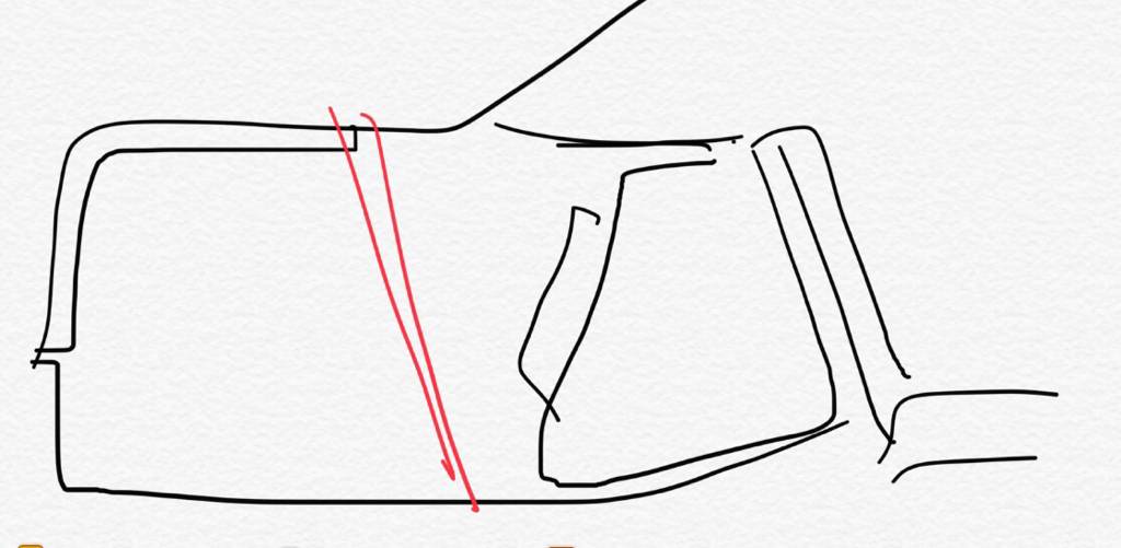

I will try pulling the box to the back of the trunk space to load it, if it really helps I may have to consider doing something different.
I really need it to go in the dead space of the trunk, so I may have to face the sub into the back of the seat to load it
Left is trunk lid. right is opening into cabin. You can gain alot cleaner sounding bass by facing the sub into the cabin and sealing it off completely, But only by sealing it off completely will you get it. Otherwise, you introdoce cancellation issues.
Is it worth actually adding a loading pannel?
My side profile sketch is p1ss poor but maybe you get the gist.
The fixed parcel shelf has the OEM sub in it and on the other side a big hole so that's the best passage into the car.
The seat backs fit snug and there is no ski hatch

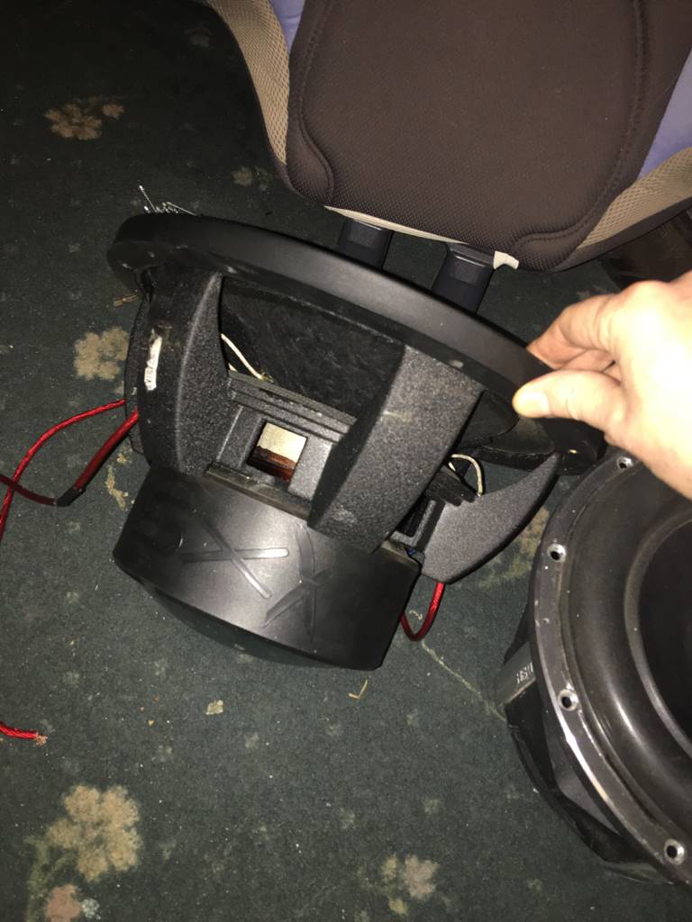

Plans have changed.

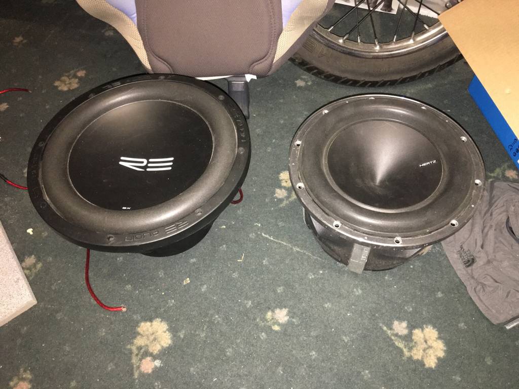

I came across a deal for a RE SXX 12 that I couldn't refuse so the Hertz is out.
As my amp is 500rms (only a value from the manual) @ 4 ohm and 900 at 2 ohm and >900 at 1ohm, I wanted to go to a DCV and get more out of it.
The SXX is dual 2, currently wired to 4 ohm at exactly the same settings it's a lot cleaner than the Hertz.
Will be going down to 1 ohm after a few days listening.

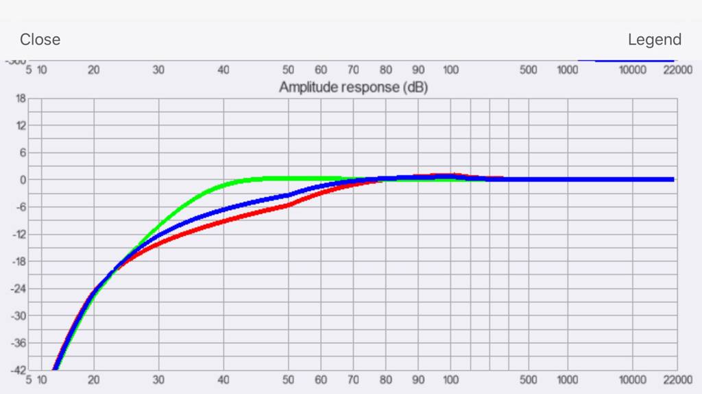

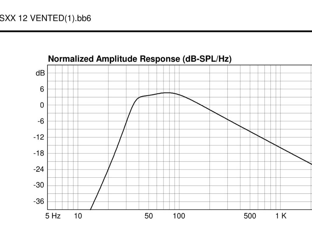

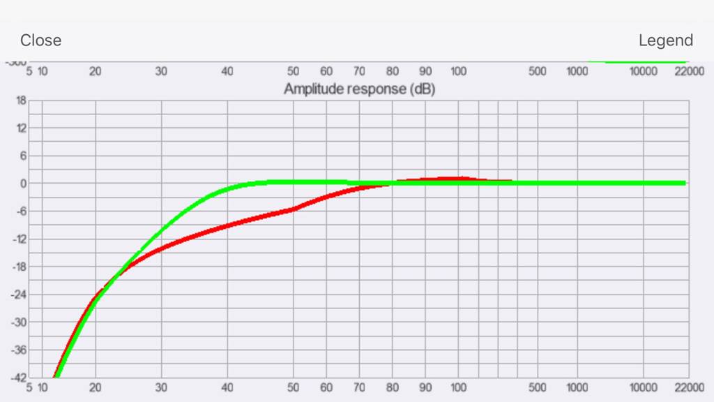

The box designer app spat out a suggested box size of over 79 litres for the SXX 12,
Re recommended is 45 L
I don't have 80 L, but if I take out the internal port and the MDF that was recessing the 10 back from the baffle then I will be back up to 34 L net.
Throwing 34 L in the app and comparing it to the 80 L it suggests, looks terrible below 60Hz.
Is there any way to make a compromise with the external port?
If I add Re's recommended box size (43L) the calculator does look better than my tiny box (no surprise there) but it doesn't look like Re suggest in their tech sheet
What calculator works on a win64 computer or iPhone that can give out believable curves so I can see what box and port size I can use to maximise the use of the space I have without just building the Re website cube it suggests?

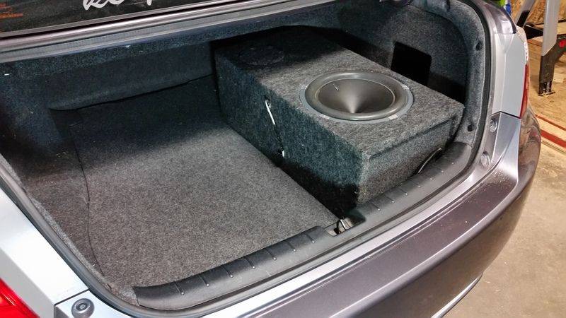

i've done a few sealed boxes for the ML2500 and I run a ML3000 sealed. I followed the mfr specs for the ML2500 with great results, corner loaded.
your box design is neat for the for the application but i'd want a much larger port since the sub can move a lot of air.
as mentioned, if you move that box into a rear corner (facing the corner) you'll hear a HUGE improvement in output. you built a neat box but it was destined to fail simply due to location.

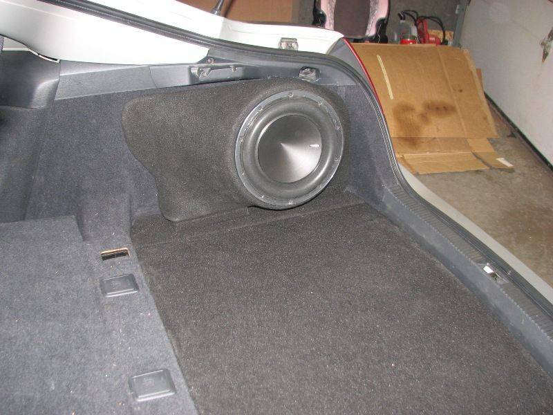

here are some locations i've tested with my ML3000. I started with a dual flared port and changed to sealed (same airspace). This increased Q from .7 to .85 which is still acceptable SQ.
ranked best to worst (i compete in IASCA SQL with #1 )
Thanks for this fella, some nice work on the differing setups.

I can move the box a few inches forward and re-mount the Re 12 in the box facing the seat back.
Doing this, would you face the port the same way or another direction?
