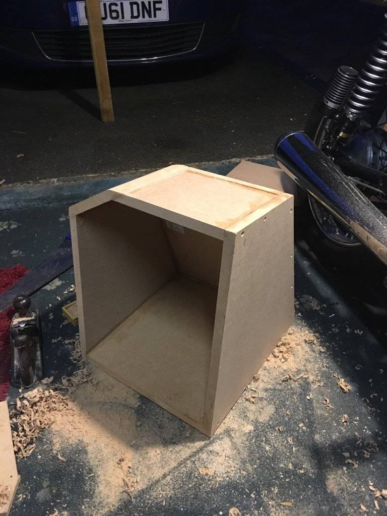

I'm making a sealed box for this sub and the data sheet info only talks about sealed.
I'm making a 25 litre (net) sealed box that tucks away nicely, but I I have a lot more boot space available and I'm thinking of a ported box that goes lower.
Who fancies offering any ideas?
Sealed box so far

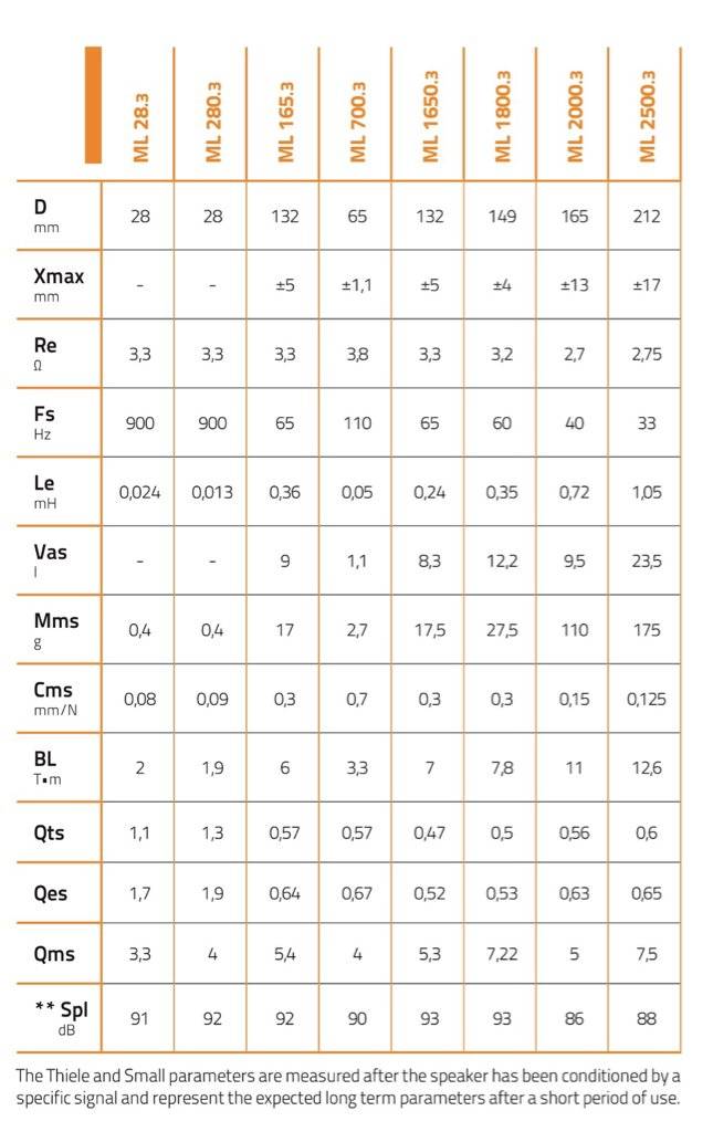

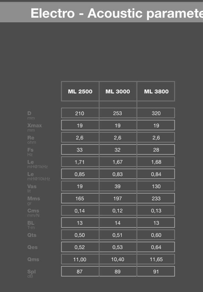

I found some data for the ML2500 the series I have
Seems quite different to the ML2500.3 info on the Hertz site
I would much prefer the flatter profile of the second ported box if it's realistic.
Can't find the thiele-small parameters for the series 1 though

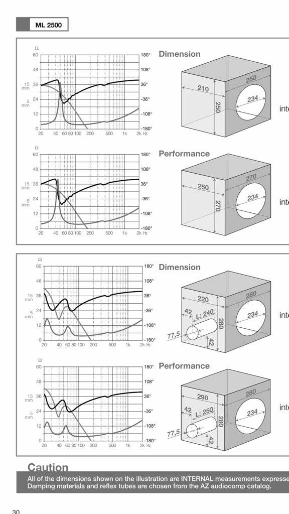

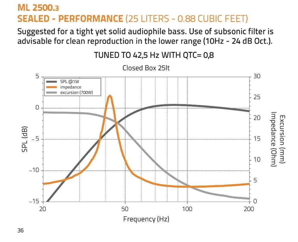

The ML2500.3 box info on the Hertz website suggests a sealed 26 (0.92cu ft)litre box.
The ported box for the original ML2500 is 22.7 litres (0.8 cu ft), does it make sense that the sealed box would be larger than the ported one?
I have about 35 litres (1.15 cu ft) available with the box shape I have so far, not sure what to build
I would follow their recommendation unless there's serious data saying otherwise, some subs are created with parameters allowing them to perform better in small ported enclosures even though it may defy the logic of sealed vs ported. After bracing and displacement your volume will likely be close to what they recommend

Generally high Q and low FS makes for a far better sealed box performer. Ported likely will give you more output around peak but possibly at the expense of flat response. you can download WinISD if you want to try and model it. As I said, just looking at the specs I'd say that sub is built around 1 cube sealed for optimum performance. Higher Fs and lower Qts is a sign that a sub will really benefit more from ported alignment.
