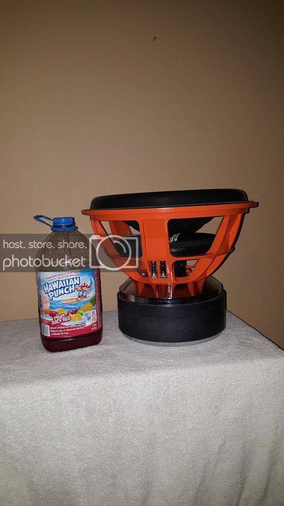

Knocks pictures off walls.. lol. It's honestly just a design theory I had. I'm infatuated with high output low distortion drivers. Just want to build something ****** that's musical. I'm sure adding some shorting rings would lower the le more(stabilize the curve abit) but it's already a expensive driver to build as is. Although the mag id rings aren't expensive and apparently they help stabilize le I need to test if it is worth it. I've never tested this theory before so I started off with a more typical build with no shorting rings. Although I really want to do a full copper sleve but that's going to cost a good deal more..

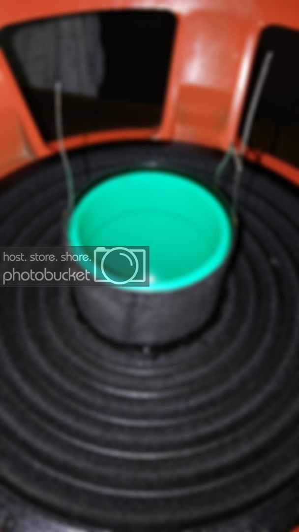

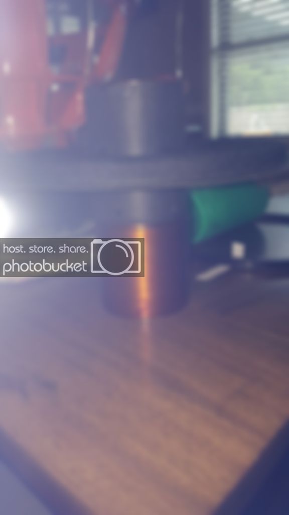

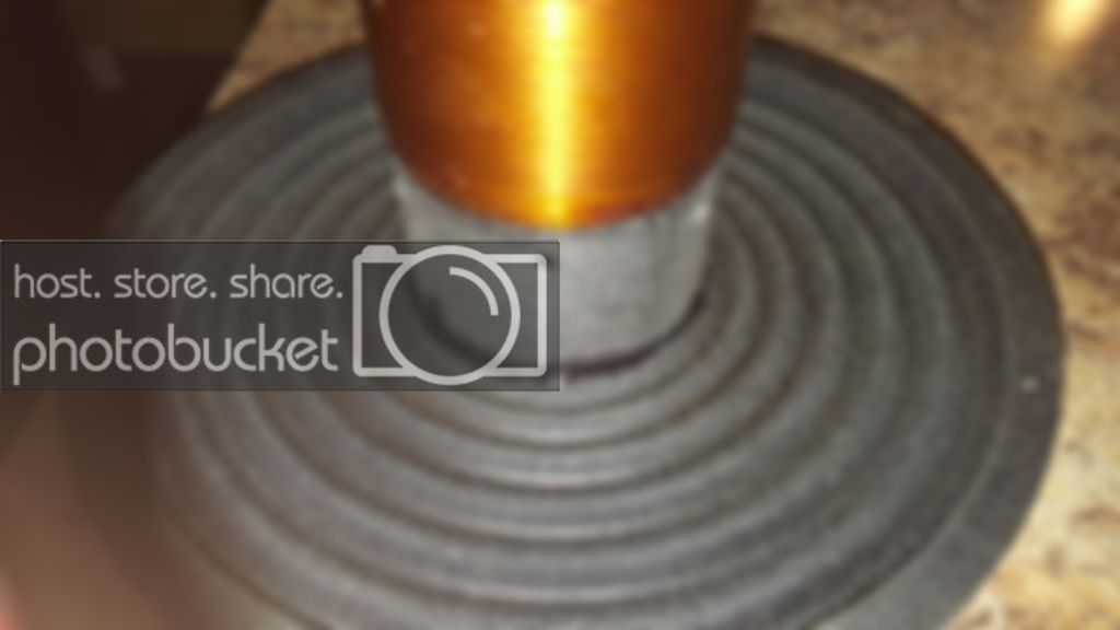

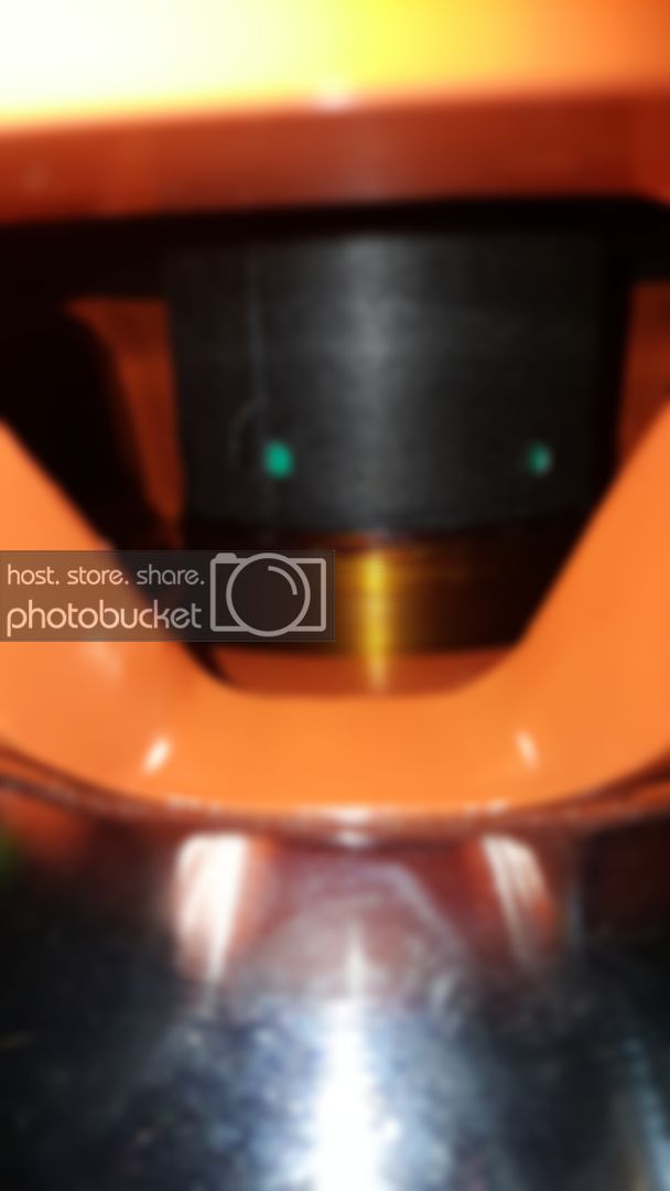

Put the spider in place set the shim in. Put the coil in. Aligned the coil set the coil to the correct height and put a small bead for the first pass to hold the coil so I can put the joint underneath the spider without worrying about the spider moving on the joint at the bottom.
20 minutes later..
The bottom joint 1st pass..
