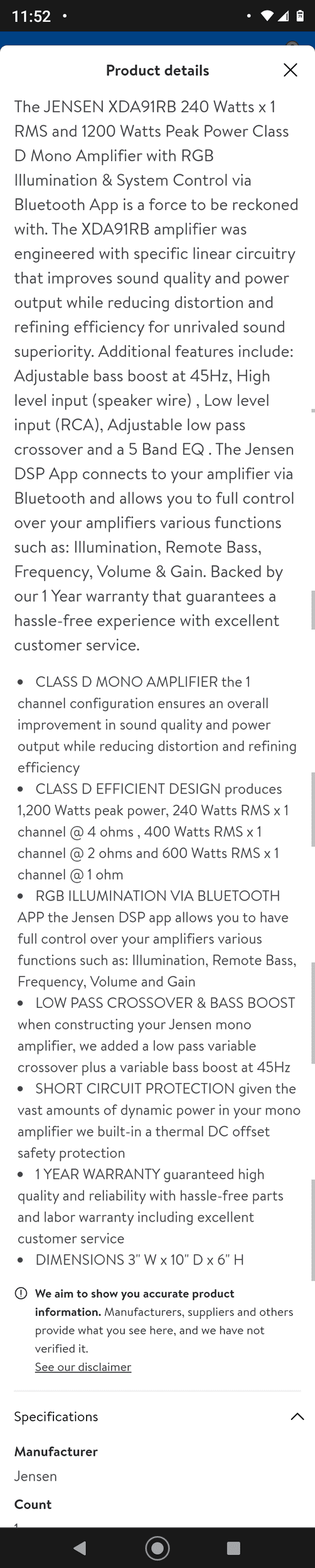

So can I use that on one set and the other amp on the other set
You can but you would have to pull the wires out the box and wire each 4 ohm sub to each bridged channel on the Jensen. If that Terminator amp came with the first sub set, I assume the subs are single 4 ohms paralleled to 2 ohms, hence the single terminal cup.
