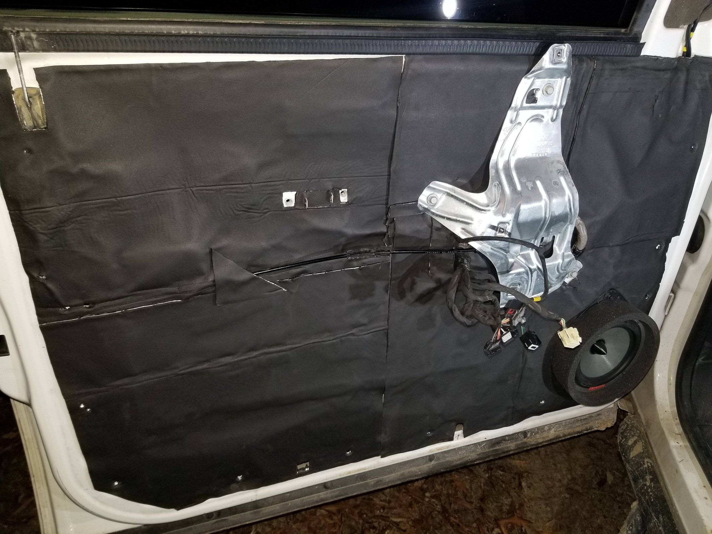

Yeah I have door treatment in the front doors all behind the whole panel of the door is all been treated the rear has been treated but I don't have my speakers in the doors bumped out like the photo you put I don't know if I can come that far out without the plastic door panel hitting that I don't actually know how much space I have between the plastic speaker grill that's part of the door panel to actually hitting the speaker itself don't know how much room is in there to further bring the speaker closer to the grill.

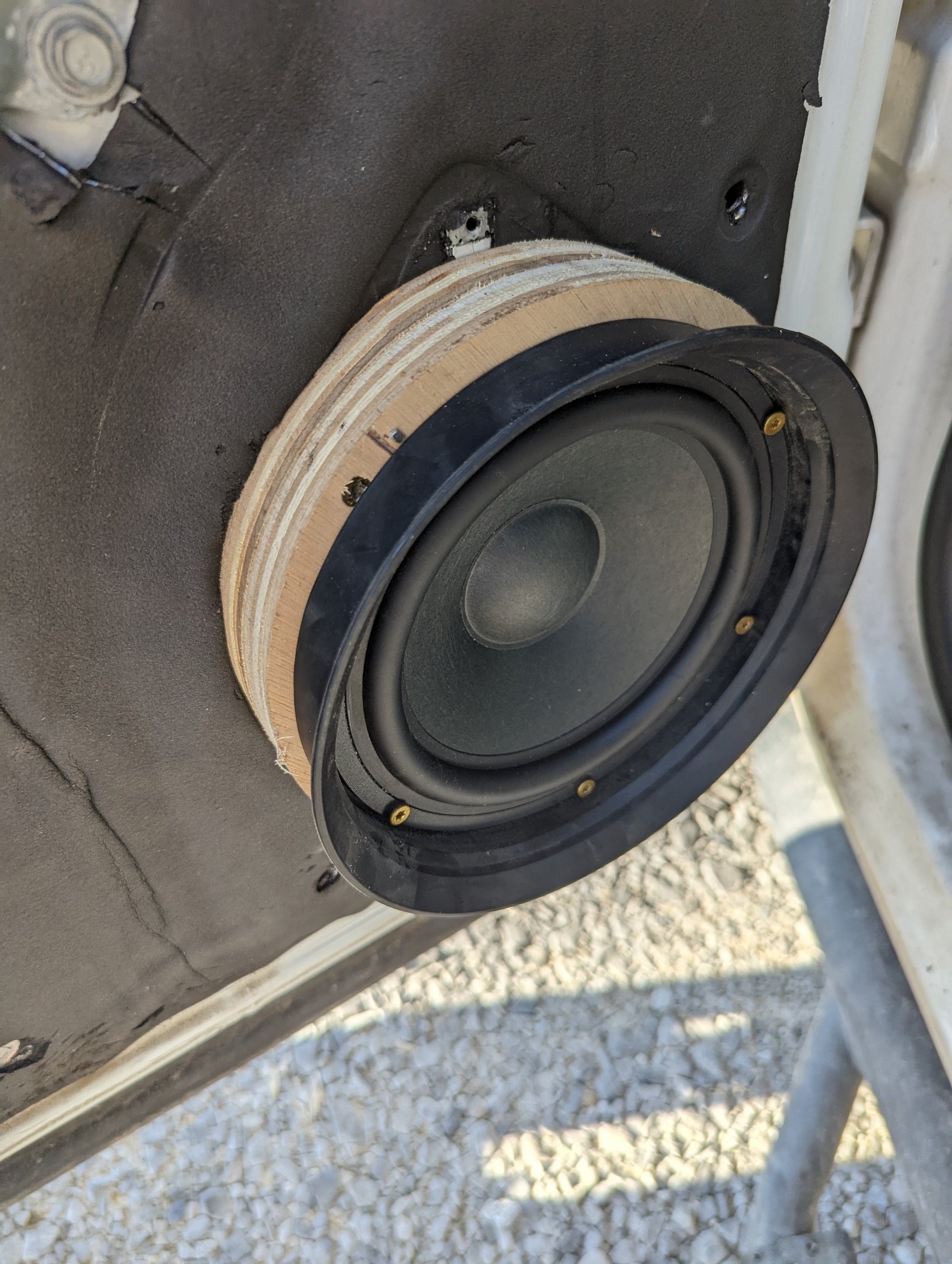

I bumped the speakers out so they sealed on my door panel. The silicon rubber ring seals to the door panel so sound doesnt get stuck between the panel and the door and cause cancellation and distortion. You should make sure you have a solid mounting surface. 3/4 inch plywood usually fits and makes the mounting surface much more rigid than just bare sheet metal. And a way to seal the speaker to the door panel foam works just as well and stinger makes the fast rings just for this purpose that's what is on the Memphis mids in the second photo

That's pretty much free. Mounting the speakers on a stiff mounting plate helps. You can judge the thickness needed by comparing the factory speakers thickness. And get some cheap 1/2"-3/4" by 1inch foam from home Depot the kind you use when installing window units works fine to just seal the gap. Shouldn't be very expensive. And the adhesive should make it easy to install without being overly difficult to remove if needed.

Okay I'm going to take my door panels off I'm going to get some foam some plywood I don't have the stock speakers anymore so I'm going to have to figure out how to determine the space between where the speakers are now and the front of the grill which don't think that's going to be easy because I can't actually see in there there's it's going to be hard to measure without the stock speakers but I'll figure it out and then I'm going to bump them out and put some foam around it so it's basically sealed and only shooting out the grill nothing's being wasted on the sides going back into the door bouncing around I know that's going to help.

Going to do the door treatments tomorrow it's my day off I'm going to work on that get the tweeters out and turn them towards me play with that and see where that gets me before I spend any money.
