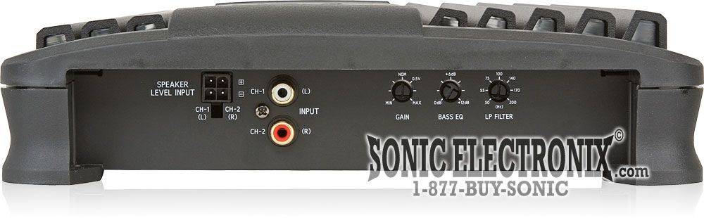

I recently ordered a MB-Quart-ONX1.1500D(1000rms@2ohm) to power my 4 ohm DVC Audiobahn aw1006t(900RMS) . Seems like a great match for each other @ 2ohms. anyways my friend wanted to try out my sub with his new amp after work today so what the hell why not. he has a Alpine MRP-M500 amp. This thing is only rated at 500RMS @ 2 ohms. we hook it up and my sub sounds great. after like 3 minutes of testing a bass mechanix cd, i began to smell the familiar voice coil smell. i let it hit for another minute to see if it went away but it didnt. I felt the cone after we shut it off and man that thing was hot. so my question is what gives? this sub is rated for double what that amp puts out and it was well on its way to killing my sub in 10 minutes flat? Granted i know that audiobahn isnt the greatest, but this particular line of them were supposed to be tough as nails. Is my new amp going to be the death of this sub?

I'm with ya, bro....the amp has a rated voltage range where it is designed to operate. If the electrical is good and the amp is not wired outside of it's recommended nominal loads, the amp should amplify the signal without clipping due to electrical. But just like we discovered when talking about power output with different amps, this is another area where amp ratings can be deceiving too. As far as your buddy's amp gain being set "a little under Half"...this too means nothing. If your source (HU) only provides .5v max through the line inputs, then the gain may be turned almost all the way up...if the source voltage maxes out at 7 volts, then the gain may be almost all the way down...source voltage varies by head units and gain ranges varies by amps...not all are the same.
man if i would of known half this stuff before i started lol. well anyways it looks like his HU has a 2.5v preamp out put (jvc kw-r500). and its really hard to gauge the gain settings lol. it only has 1 reference point at .5v slightly at 1 o'clock lol. they should label these better than they do. Anyways so what i take from all this is this happened bc the gain on his amp was set or calibrated for a specific volume for his 12, and because he had to turn it up more(he had it crankin near max volume) for my 10, it sent clipped signals and nearly toasted sub. lesson learned
