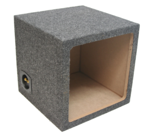

Picture of your box along with letting us know what head unit you have and how your gains are set

So the stock head unit cutting off bass signals from built in high pass crossovers is definitely holding you back like it'll reduce the performance of any setup you have by 70% kind of bad. The box is absolute trash as well, dont expect any kind of performance out of that box at all. So those are the key issues you need to address. You subs and amps are fine

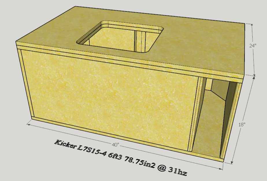

A custom ported box (can copy shredder's design) would cost you 300. There thats how you should spend your 500.
