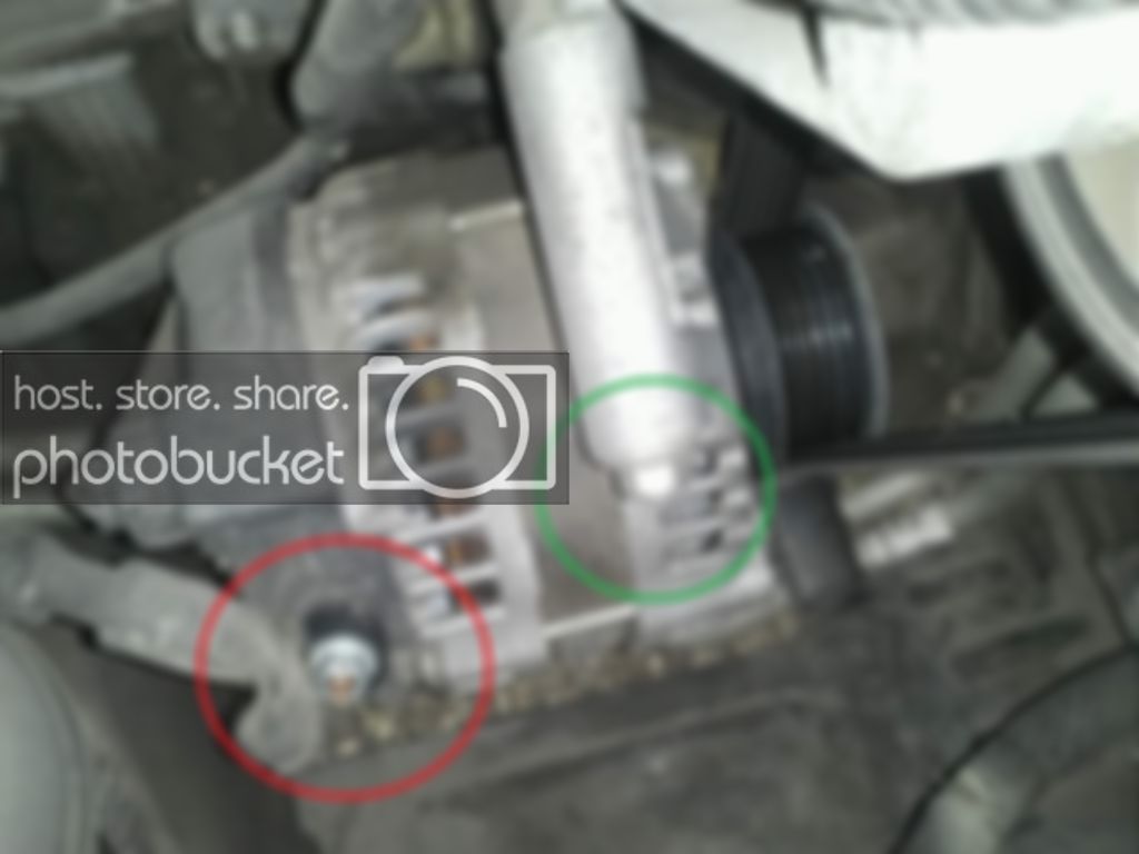

First time doing that grand ol' big three.
What bolt do I mount it to?
"Positive alternator" is what I've heard, would it be the one towards the bottom?

ps your positive on yoru alt is that brass bolt there

your brass bolt with silver nut on there is yoru charging wire to your battery and i jsut used a alt mounting bolt for the engine ground to my batt neg cause it was convient in routing the wire.

Not to second guess you or anything, but you're %100 positive the previous bolt you mentioned [the one towards the right, also noticably longer] is the correct one? Re-reading the big 3 thread again, and it mentioned again the one I want is covered by a protective coat. and the other one was, and that is why I was leaned towards thinking it was that one.
I'm not gonna read all of the above...
Red Circle = Positive
Green Circle = Good engine ground/alt ground (looks like an alt mounting bolt)
