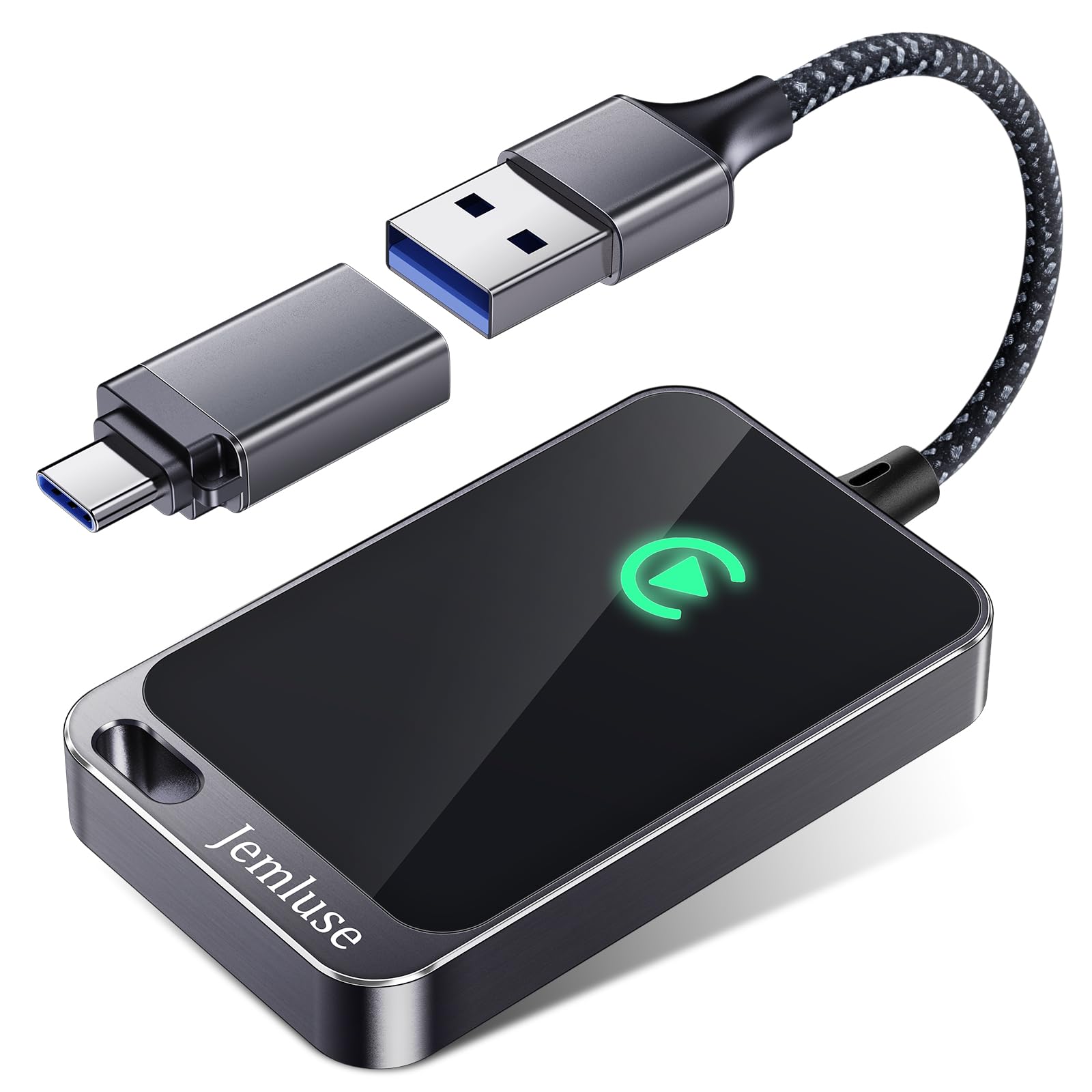

I don’t know if you are adding a CarPlay or Android auto, these harnesses are made specifically for these radio features. CarPlay started in 2014, Android auto started about 2015. Newer features of the car radio. There is a video slot too on the harness and Android radio. So that feature works too. I think on the South Korean made cars, the technology is more on radio rather than on power for cars. So stick to learning all the car radio gadgets for better technician results. Plug this into your iPhone, and you’ve got USB CarPlay. Radio, Google Map, Spotify, and Bluetooth.
