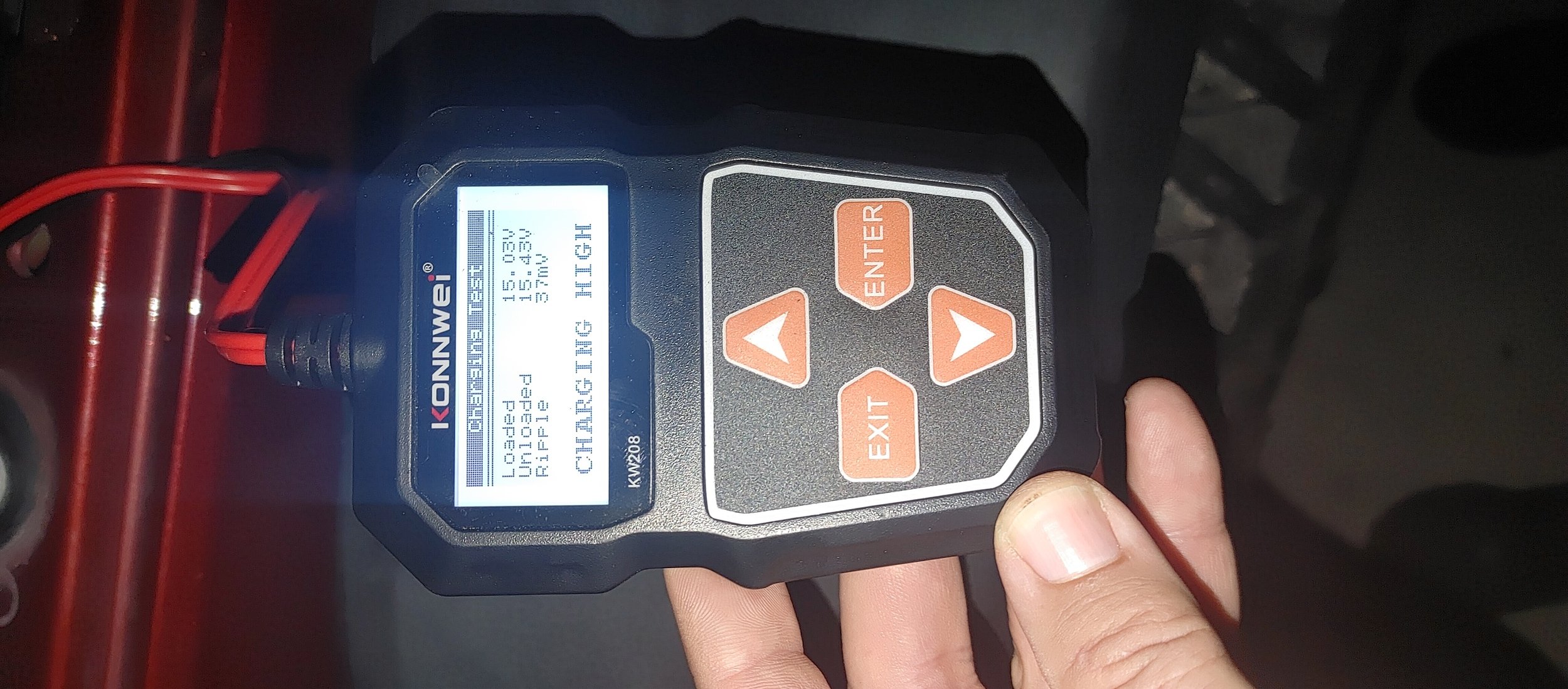

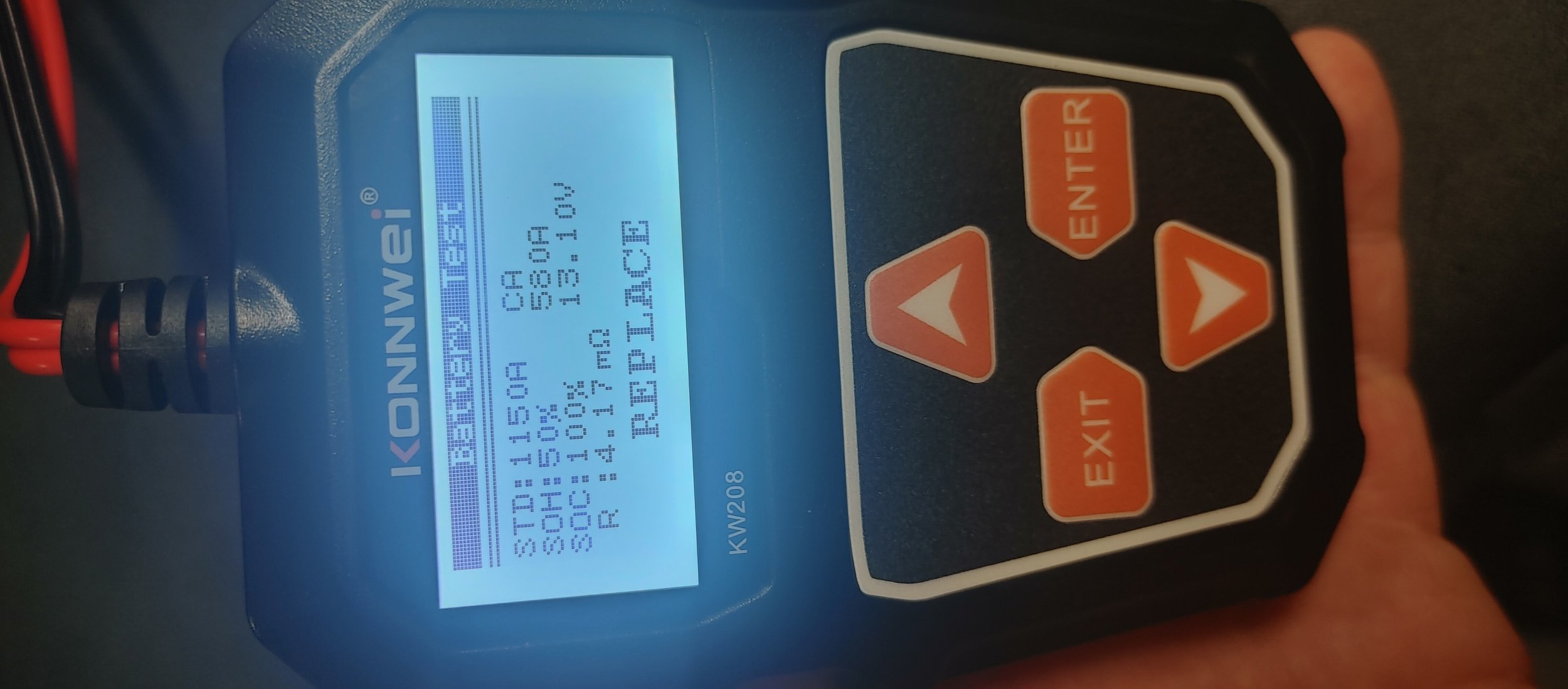

When i installed my js alternator 300 amp in my 08 jeep wrangler my voltage at idle was 14.25v. I checked my idle voltage a couple months ago and it was 14.75... Now today and it is 14.85 to 14.91.. I know my agm is weak and needs replaced.. Can a weak battery cause overcharging? I am getting ready to switch to a headway bank and don't want to overcharge it.
Never seen a bad battery cause overcharging. Bad regulators cause overcharging.
Colder weather will cause a small rise in voltage. I've got a voltmeter in my HU. Cold start in the morning reads 14.2 - 14.4. By the time I get to work it's 13.7 -13.8
I was wondering if the cold temps had anything to do with the high reading... I drove it around and pulled it back in the garage and tested it again and got the same readings from 2 different multimeters. I dont know if im splitting hairs but my expensive xs power agms didnt last very long and i hate to charge my new expensive headway higher than recommend.. I want to do it right. I have my oem alternator and my old lead acid battery that somehow still tests good.. Thinking i probably should swap em out and see what i get.

My truck is up .2v today to 15v and at max voltage is up to 15.5v over the usual 15.4 assuming I turn it up. My alt is set to 14.8v so I don't cook my agms. I wouldn't put lifepo4 cells on that voltage.
