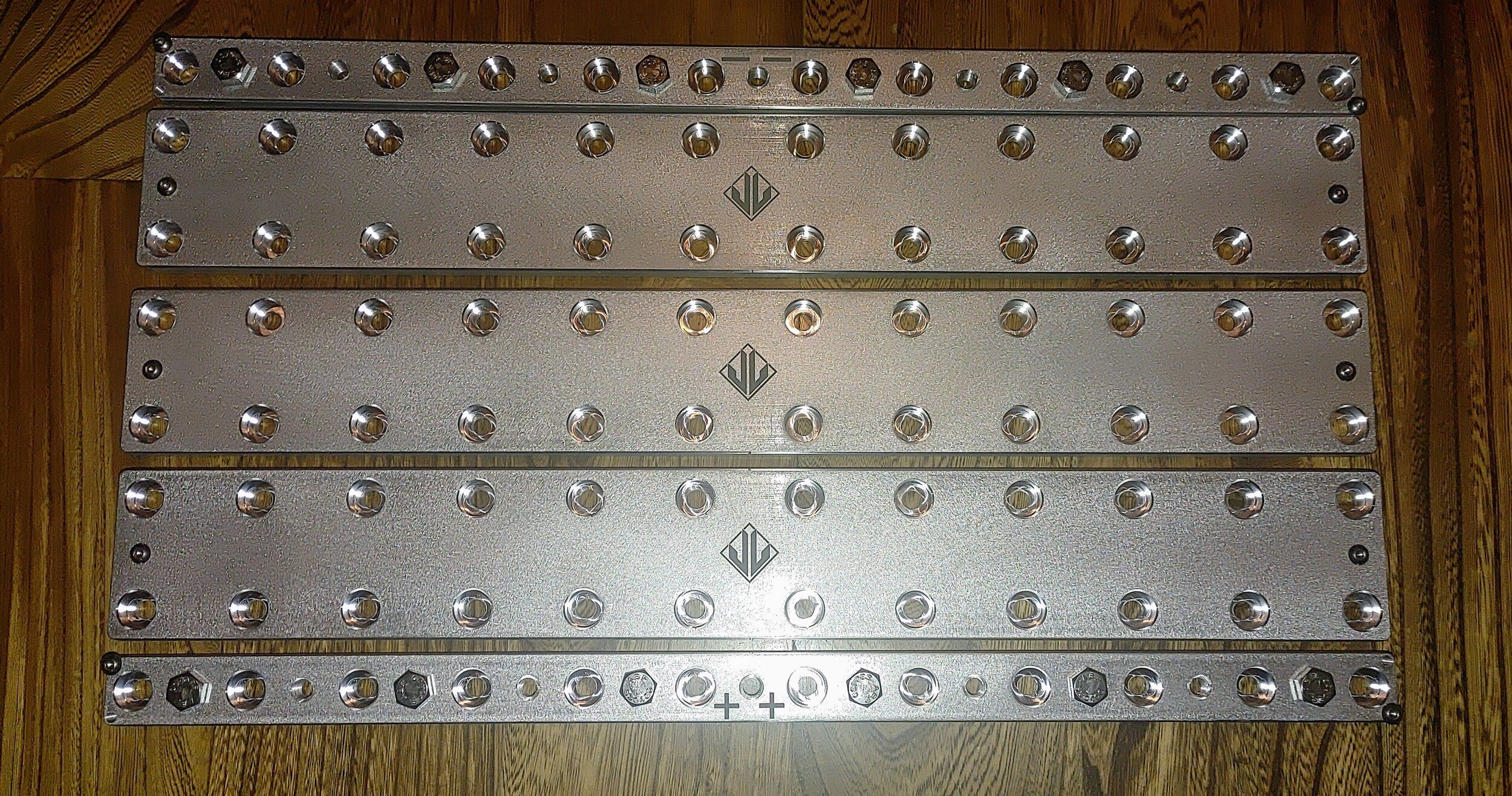

I finally got to the bottom of of the overcharging.. My system and extra batteries are out of the jeep right now and i left my weakest agm underhood while im building my new system. I ask js alternator if a shot agm could cause overcharging and they said it could.. So i replaced the old agm with 500 farad Xs power superbank and everything is back to normal... 14.6v to 14.8v. Also i called xspower about putting the superbank underhood and shawn said it actually handles heat better that an agm. And my headway bars arrived today... Couldn't be happier with em!
