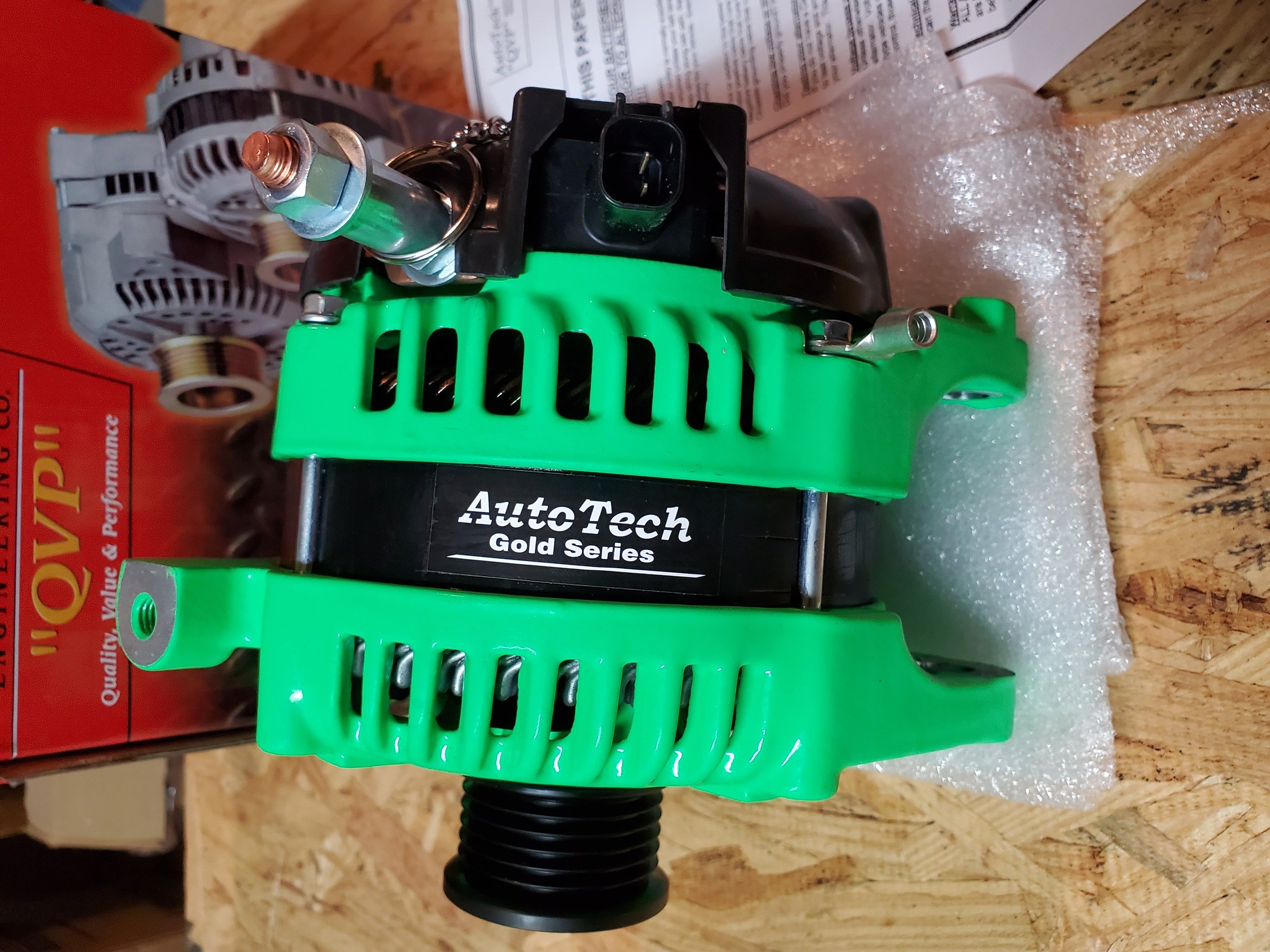

Alternator arrived today.
It looks great. Samuel was very helpful, and even with powder coating, the unit arrived well under quoted lead time.
So far, so good 👍
