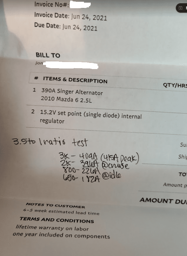

Likely because Mike is being honest about real-world expectations of an alternator installed.
I'd be interested to be proven wrong though if someone has some "400A" alternator and can show us some video of clamping some numbers out of it outside of a cold test bench scenario.
You almost make me want to buy it to test it now.
Almost.
Got some video of this happening installed under real world conditions?
35573

https://autotechengineeringusa.com/
Got my 320a with powder coating for less than Mechman 240.

May I ask how long you've had it and how it's holding up? I'm assuming you like it if you reccomended them.
That's definitely the most power per dollar option I've seen.
I literally just got it so I have zero experience in reliability other than the reviews on Facebook for the past few years. I'm very impressed with their customer service and build time though. Talked to the owner over the phone and he was great.
