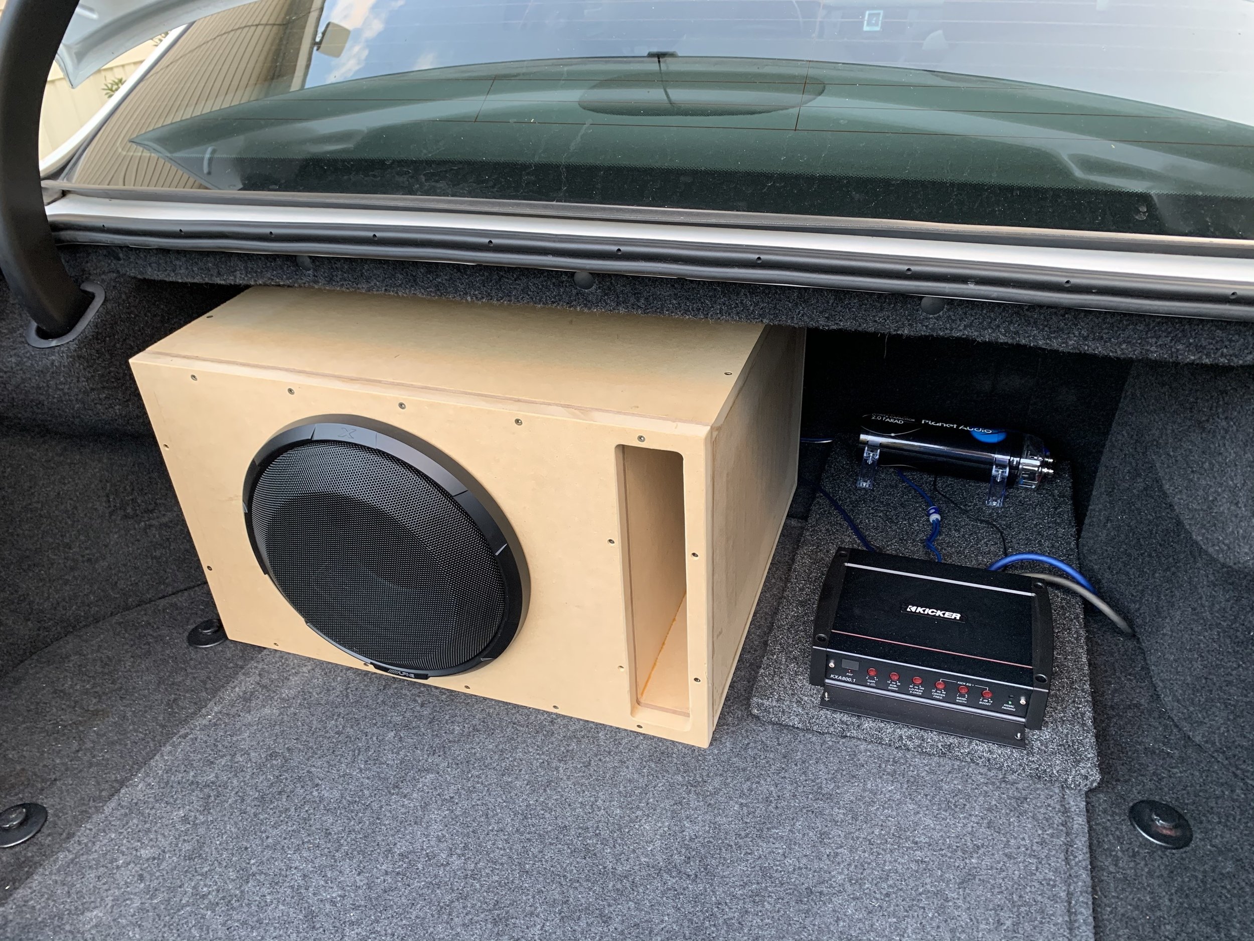

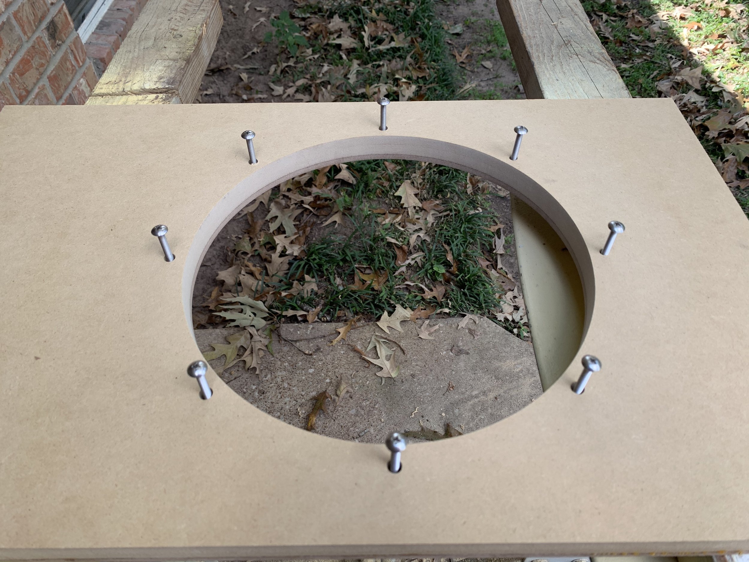

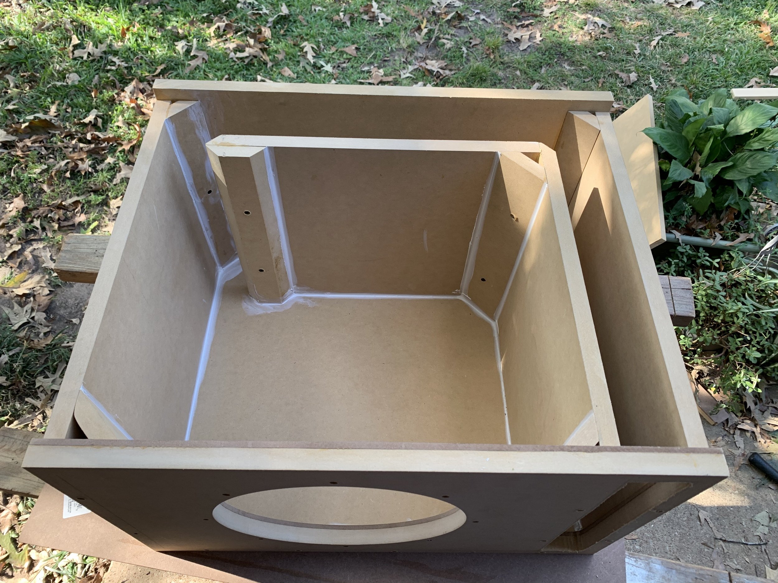

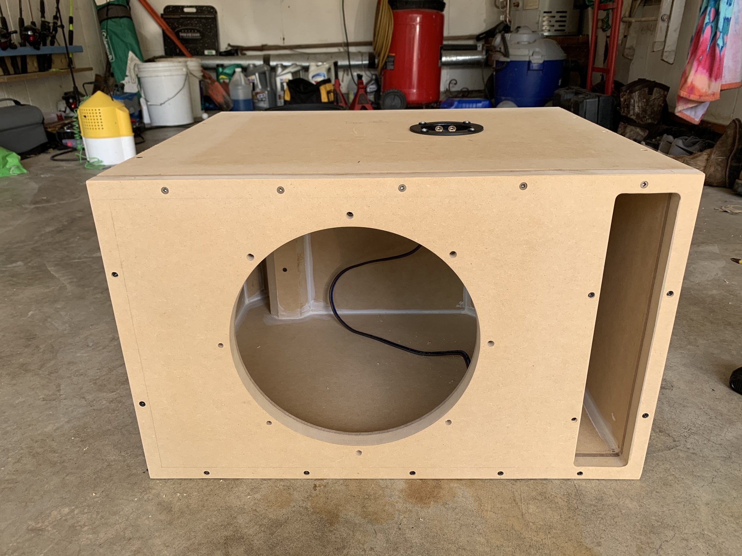

Big shout out to @shredder2!!! Built the box he designed today, and the Alpine X is actually sounding the way I think it should. I might actually keep it lol.
Nice work. Subs can still perform with them pushed that far back into the trunk? I always had mine 4"-6" away from the back if I can move mine that far back I can gain some grocery room.
