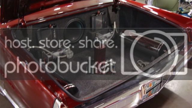

dude run it in 2 ft^3 ported through the rear deck right between the 6.5's flush it in and run you amp to one side leaving room on other side for your highs amp
like this
that is a caddy i did its one 4 ohm jl w3 on a tma500.1 (called J2 now ) bish slams trust me port through rear deck if this is a DD
