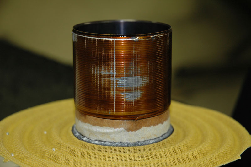

On Weekz woofer the lead wire broke where it attached to the coil as it was not properly encapsulated with the CA glue at that point. Only the top of this joint was glued leaving a weak point. That is an issue that I did not catch with the new guys building drivers. It worked well enough that he made this video first and will work well again upon receiving a new one that will not have the same failure.
WS1086's woofer didn't stop playing. The wrong terminals were used for the 12" frame and the slack on the lead wires wasn't pulled properly. The cone was able to hit the terminal posts but even still the woofer plays fine though. We did realize a need for an insulating layer to keep the leads from shorting on the underside of the conductive aluminum cone as well and a solution for this took some time. Yes, this was a design issue that I missed prior to then and take responsibility for. His driver was returned to me at my expense. He asked about doing a pair of 10" drivers instead and was given a discount on them to make up for the delay. If he's not happy and wishes to have a refund in the end then he will get one. He hasn't ask for one though. In fact nobody has to this point.
Then there is so far the whole issue with the woofer that then went to bassfreak. I believe it has been covered here already. He first was amazed at how loud the woofer played and claimed he must have been doing at least 144dB at one point with it in 3.5cf tuned to 32hz. He also argued on several occasions that he does not believe in using a subsonic filter and that only the suspension of the driver should protect against over excursion below tuning in a ported box. Knowing this he went and applied 1500W to the driver in this situation. This "little SQ woofer" as some have referred to it, is not intended for this kind of use with 1.5x the rated power of the driver and no protection from over excursion below tuning. Then one day he claims the system was bandpassed 25hz-80hz. The next he claims it was 30hz to 60hz and states the system lacked output above 60hz. Of course a driver put in an enclosure with flat response to 30hz anechoic is going to have excessive output at the lowest frequencies when you factor in cabin gain. Then put the crossover at 60hz and very little output can be expected above there. If someone wants an all out SPL woofer that is virtually indestructible I can build one. I can laminate multiple spiders with a flexibilized epoxy and greatly stiffen the suspension. The AV woofers are designed with SQ in mind though. It just happens that with 23mm Xmax they can still play pretty loud within their limits.

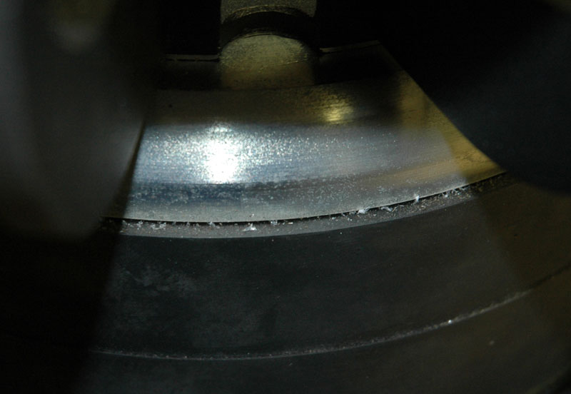

I'm not calling anyone a liar. There were metal shavings on the motor you can see here.
http://www.aespeakers.com/temp/Damaged%20Woofer/Damaged_AV15-1.jpg
and the effects here:
http://www.aespeakers.com/temp/Damaged%20Woofer/Damaged_AV15-4.jpg
The metal on top of the magnet was not on there when the woofer left our door. How it got there I do not know and have never claimed otherwise, but there was a good amount IN the gap as well. If you understand how the magnetic circuit works you'll realize that the highest amount of stray flux is near the gap. Anything magnetic will tend to go towards this area if it is not restricted by something else.
