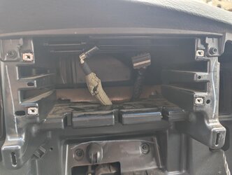

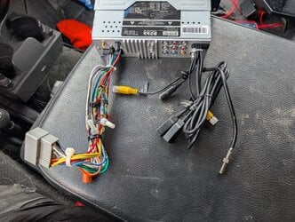

Just pulled the head unit too, the wiring harness looks pretty well done. All the wires are labeled and connected with those fancy sleeves with solder in the middle. It all terminates in a single plug that connects to the factory plug, minus what I'm assuming is the antenna wire connected to its own quick disconnect connector.

Well that will definitely cause problems lol, were you testing for continuity with the headunit unplugged? If so, it sounds like you'll have to check the wires for damage. Could be pinched in a door or under a piece of trim.

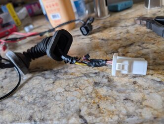

Well, managed to narrow it down to (thankfully) the wiring harness in the door. Good continuity from the head unit pigtail to the end of the plug in the gap between the body and door. No continuity from the other side of that plug to the speaker plug. Guess I'll either get a new door harness, or just thread and splice some new wire there. I'll update when I've got it done. Still scratching my head about the distortion in the front speakers even with the rears unplugged. Guess we'll see if this solves the issue.
I'm wondering if the positive and negative being shorted was somehow causing the distortion, so unplugging the speaker didn't change that but reducing the power going through that channel did... Just a guess. Hopefully fixing the wires solves both issues lol, Good luck!
I think I just *MAY* have found the issue lmao.
Pulled the whole door harness, got it inside to start unwinding it and would you just look what was hiding under that rubber boot 😂 as an added bonus, the sound system is running fine now that this mess is disconnected from it.
I've got a couple new speakers and some 14ga wire coming in a couple hours. I think we'll have all these connections repaired and buttoned back up by the end of the day.
Thanks for all you help!
