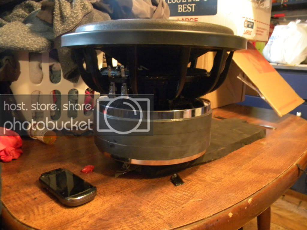

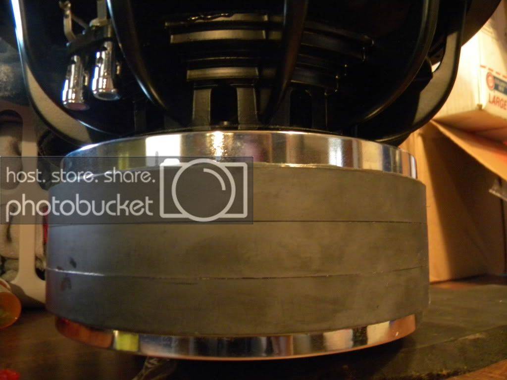

Wow....That's a big *** fu**in motor for a 12. What version was that though? 1Kw or 2Kw? If it's the 1K then the motor/magnet assembly is now smaller according to the picture on the site...Only 2 stacked magnets on the 1K
