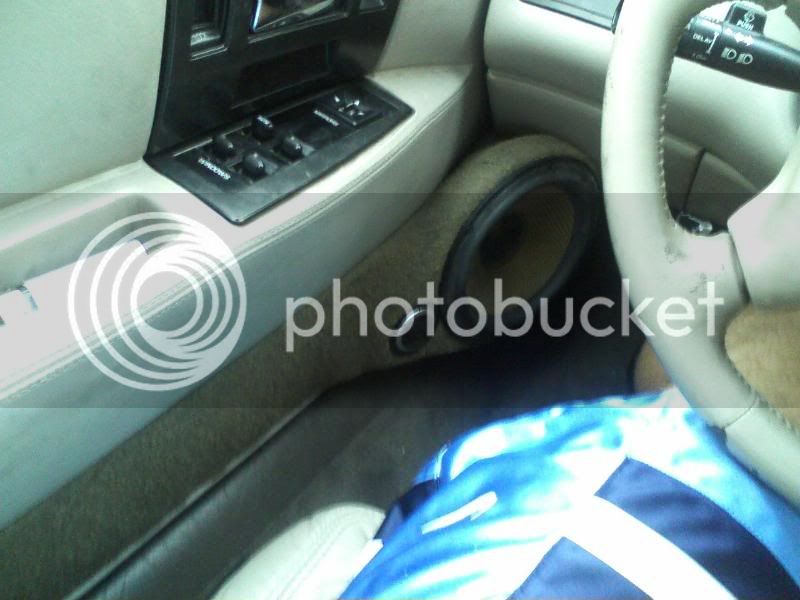

im running a set of 8" usher mids in my door and they can play down to 55-60hz all day (300 watts rms)
http://www.partsexpress.com/pe/showdetl.cfm?&Partnumber=296-616
here is a link for the mids
and here is what they look like in my doors
