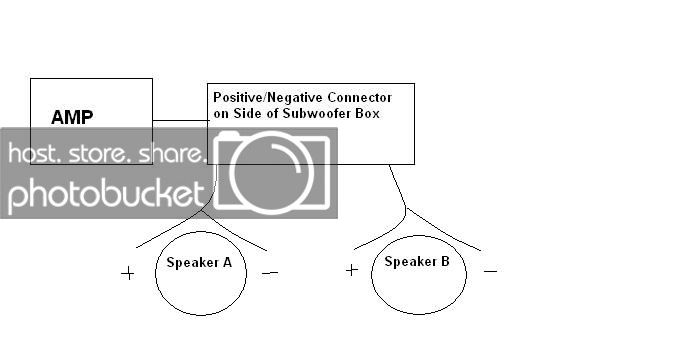

1. I've been reading about parrel wiring and I want to know if I wired my box wrong. I have 2 Kenwood subs in a box. When I wired them I ran the speaker wire (bridged mono) from the amp to the connection on the side of the box. On the inside of the box the speaker wire splits at the box connection and the 2 seperate speaker wires then run to the 2 subs. Is this OK or should I run the speaker wire to speaker 1, then run the wires off of speaker 1 to speaker 2?
2. The amp that is running those 2 subs has a switch that allows you to either choose stereo, mono or L+R. Which setting should I use?
Yeah I'm sorry if that is confusing. I made a picture if it helps.
I really just want to know if this is considered parrel wiring or if I have to redo the whole thing, which isn't an easy task considering I have to remove the rear seats in order to get the box out.

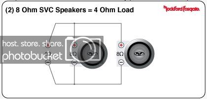

So is the way I wired my speakers essentially the same as this?
1. Thanks for the picture.... It looks just like the one I made except WAY better.
2. Funny, you linked a site I was reading earlier. But I'm still mildly confused. If you look at the amp I linked to, it has that stereo/mono/L+R switch. The speaker wire going to the sub box is hooked up to the Left Positive and Right Negative outputs on the amp, so I'm guessing I should set that switch to mono?
