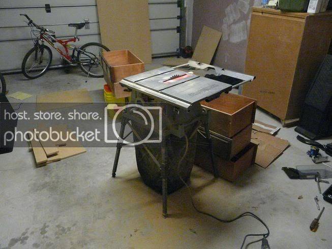

I love this table saw! It's the ***. It does 45 degree angles too! Sexay...also take special note of the kitty litter/dresser drawer table, lol

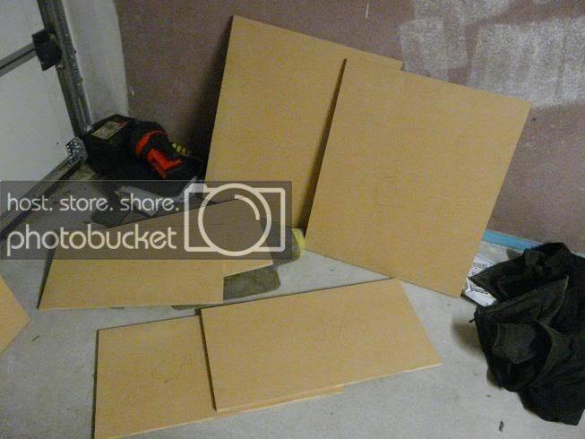

All boards are cut, except the board for the subs!

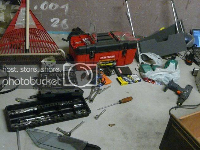

Clamps?! Clamps are for chumps!!!...or those that have 'em

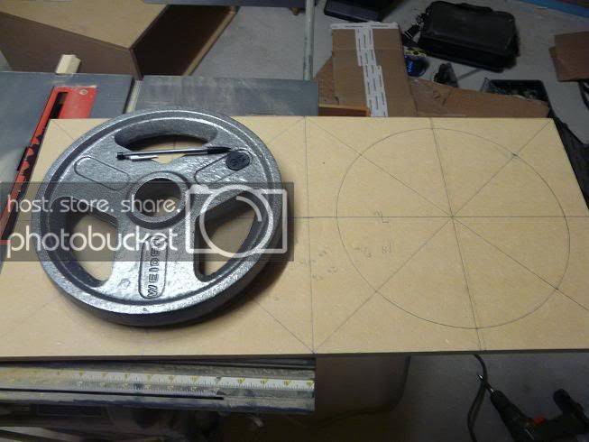

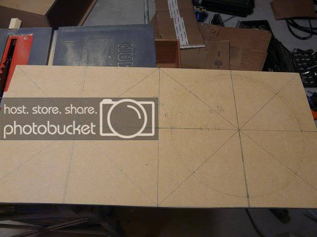

Don't have a compass or any of that crap...trying to do some math to figure it out

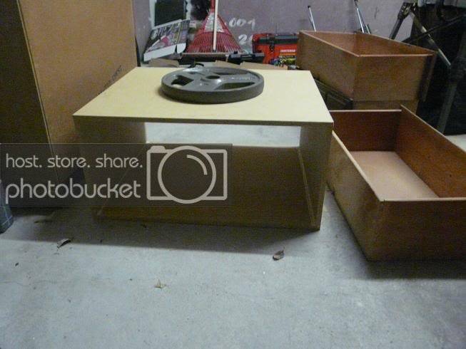

Then I saw that the 25lbs weight had the same diameter! Woo hoo!
The weight ended up being an epic fail...the cutout was too big for the subs. I ended up going online and getting a template, which worked out great. Notice how perfect those circles are! haha

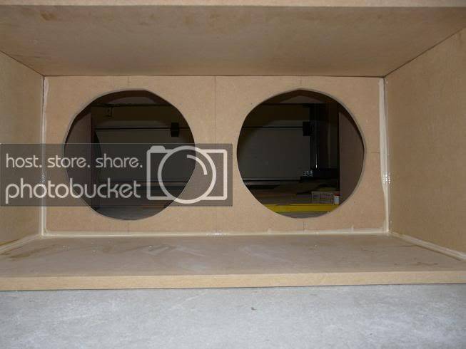

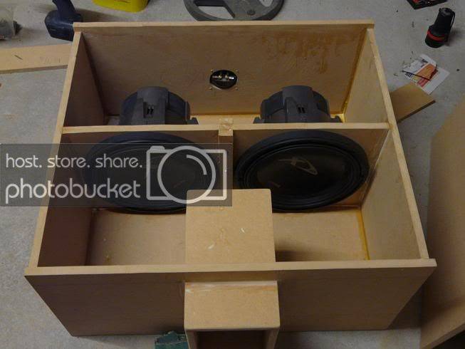

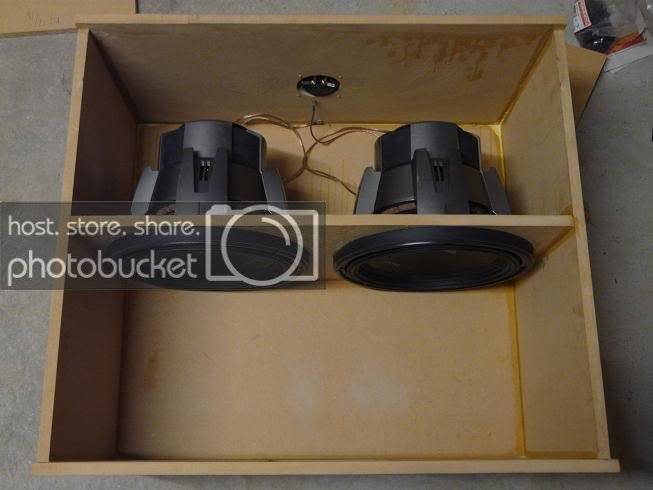

Subs are in...front board is on...terminal cup is in!
The port is in! It fits! Ohh yeahh

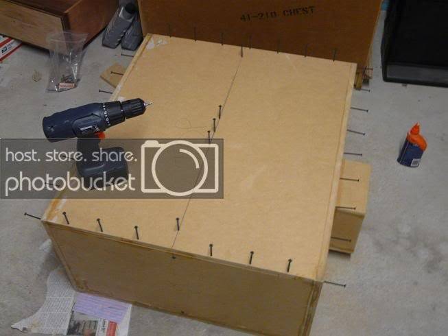

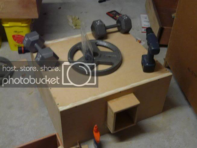

Box is almost done. Man I love not having clamps!
Screws!!!

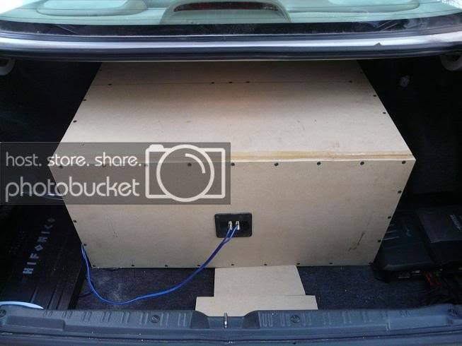

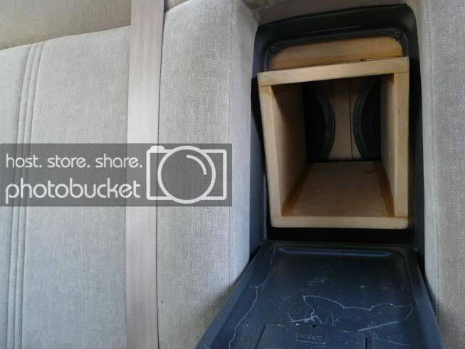

Box is in, it fits!!
Didn't really know how to make the port perfect...but it works. Could be a little longer, but **** it sounds GREAT! Very happy that everything ended up working out so well!
Oh yeah, even though the port looks a little uneven in this pic...it isn't!
The bandpass has 2ft^3 for the sealed portion and 2.5ft^3 for the ported section. The box is tuned at 50hz!

The sealed portion is 2 cubes and the ported section is 2.5 cubes. The port is cut to length according to WinISD and bassboxpro...it's tuned at 50hz.
