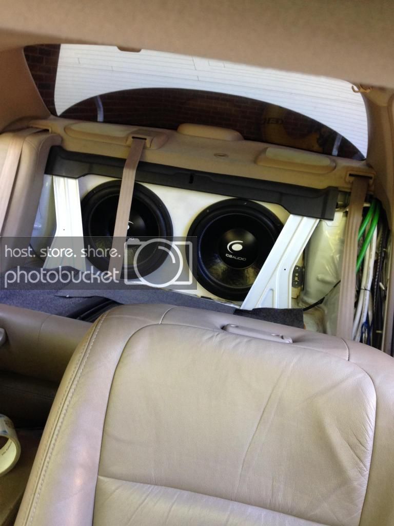

Wire going under where the back seat will be and up in the hole under the rear deck
[/img]
Put the seat part back in and the wire ran fine under it. Did not cause the seat to stick up or anything.
Got all of the rear seat back in and everything went back together no problem. The part where you still see the power wire running into the trunk fits just fine behind the part that goes there( the piece between the door and back seat) as it is hollow behind it so you have a good amount or space to work with
all the wire coming into the trunk
