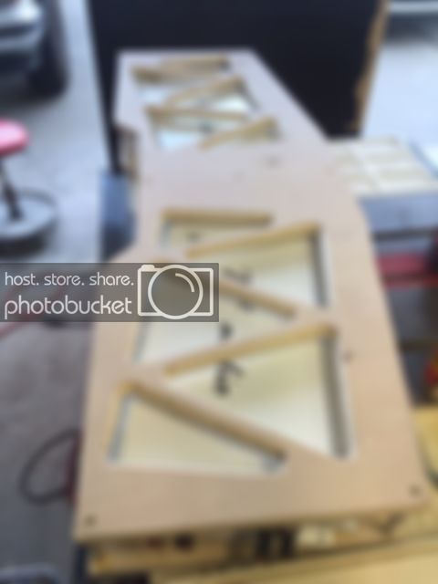

Got my braces made up, Plumber buddy hook up he cut the pipe to length and threaded them. After a lot of gruntting lol the threads are tapered and get tighter as you tighten them so cranking them down to the correct length was some work then made sure the sub cleared them i got them squared up and screwed down, siliconed the screw heads to make sure they dont come loose.
View attachment 26552971View attachment 26552972View attachment 26552967View attachment 26552970View attachment 26552969View attachment 26552968View attachment 26552966
**** sturdy box!!

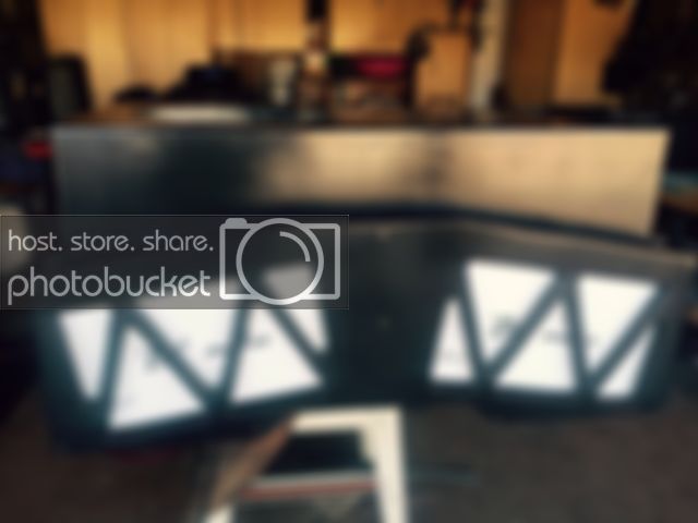

Picked up some carpet today and got everything except the sides done - ran out of glue lol! I saw a vid on YT or somewhere once that said to router a groove around the edges of the side panels to make it much easier to carpet, so I gave it a shot and I gotta tell you its so much easier ! I did all the panels between baffle and box too cuz I got an Idea to cover the baffle too. I will post pics soon.View attachment 26552978View attachment 26552977View attachment 26552979View attachment 26552980View attachment 26552981View attachment 26552982View attachment 26552983
I am going to test fit it in the truck tomorrow and will let you know how that works out for me ha ha !
JEEZ I hope it fits !

Ya you and few others LOL , but its cheap and durable. I gotta get out there and see if it fits in the truck now lol that would be a pisser huh ?

I did a test fit today ! Jeez it fits perfect -les than an 1/8 clearance on each side at the top and back. I was really sweatin it! I figured I would have some grinding and sanding to do. But all is well ! It will slide back about 1/2 - 3/4 inch more when I take existing amps off back wall, Then it will be a perfect fit !
