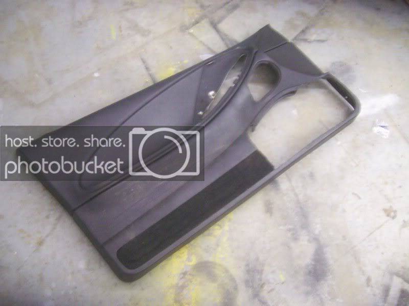

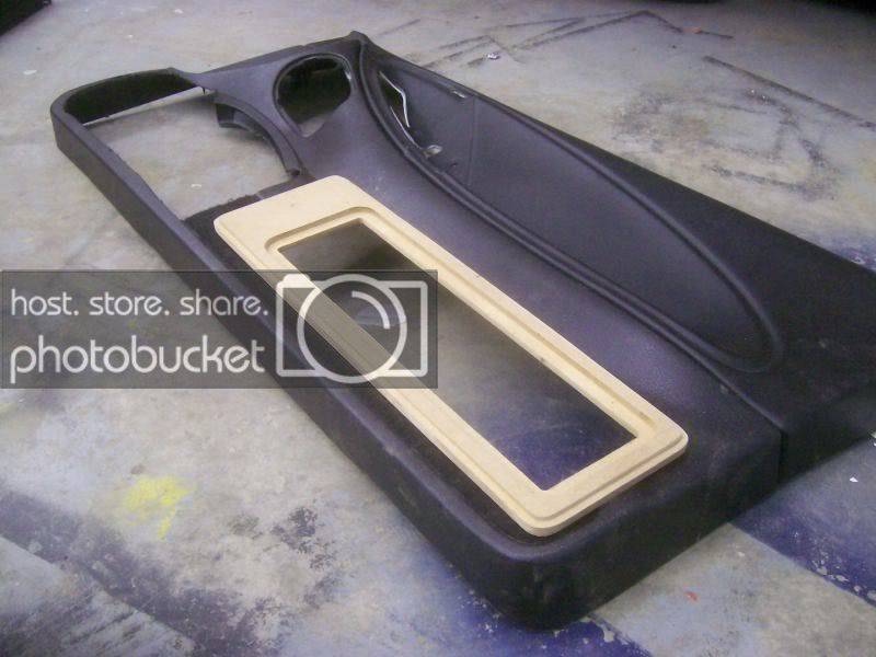

The stock door.

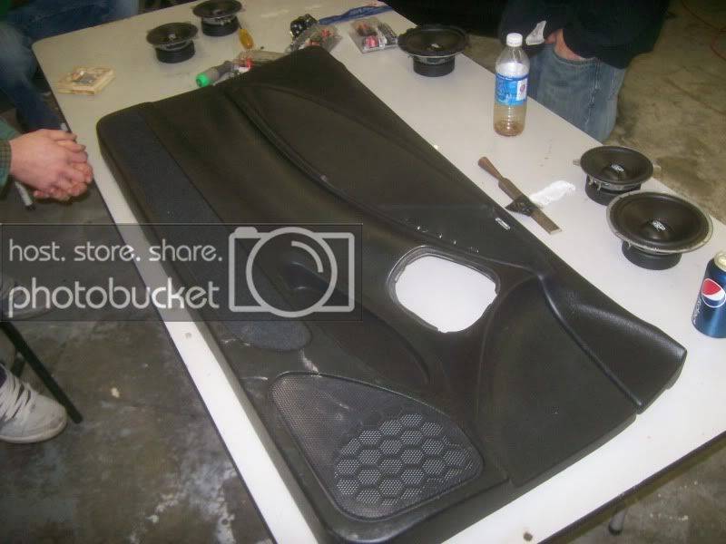

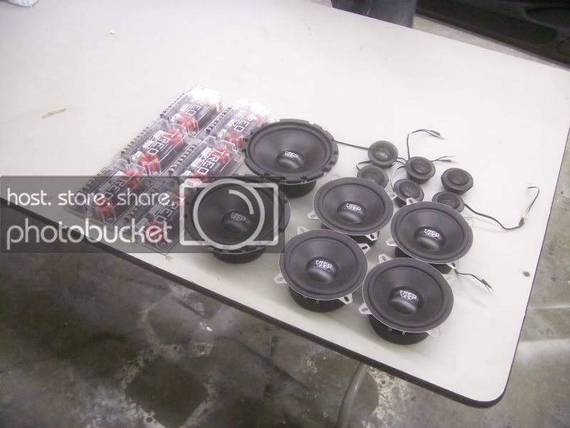

The euipment

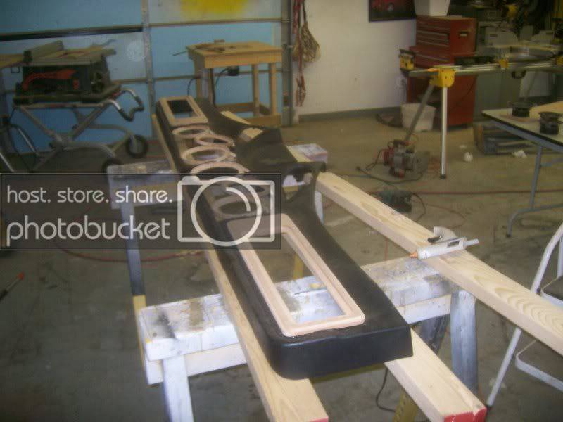

cuttin out the pocket.

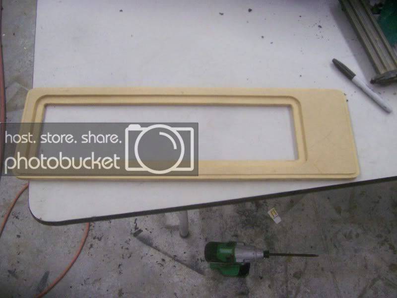

The crosssover plate.

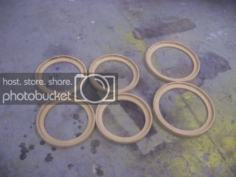

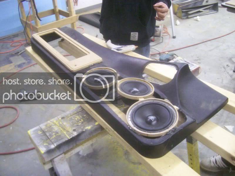

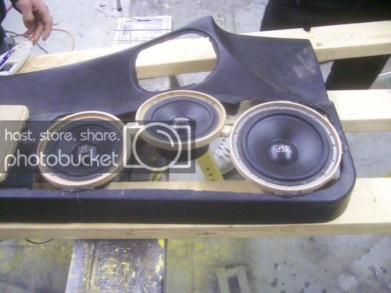

The Speaker rings.... using the router in 10 degree weather haha.

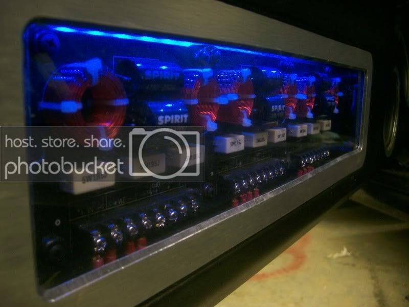

where the crossovers will go.

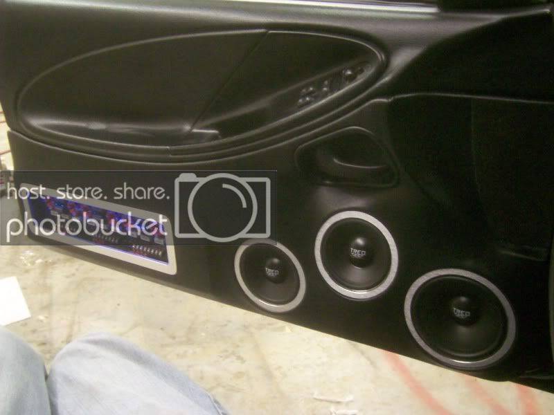

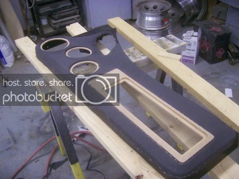

The rings mounted

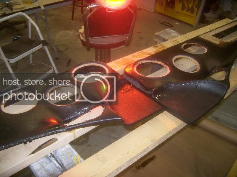

With fleece.

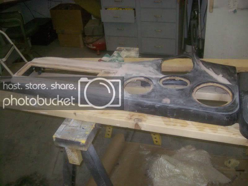

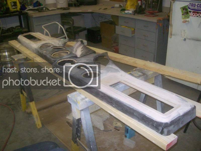

Glassed
In the finishing stage.

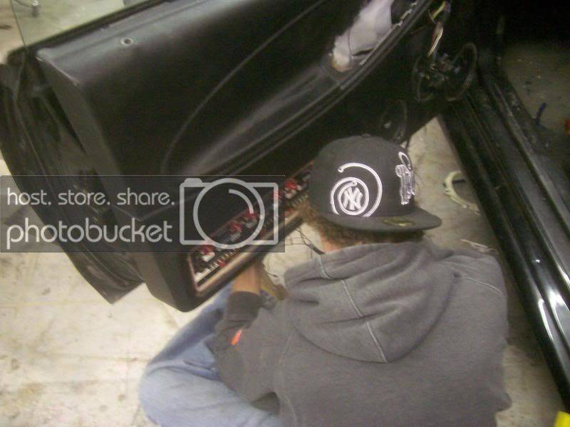

Robie having alot of fun wiring up them crossovers haha.

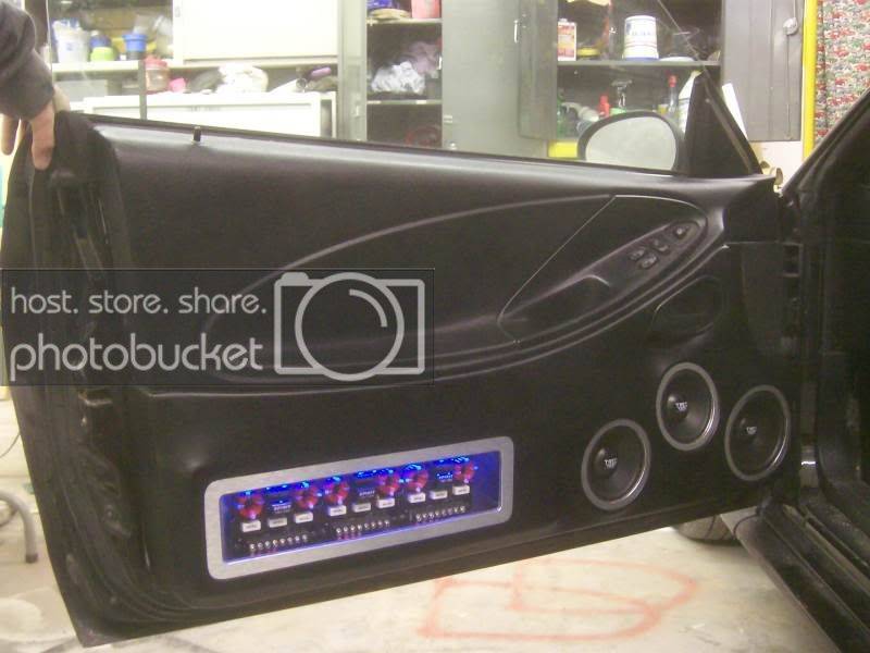

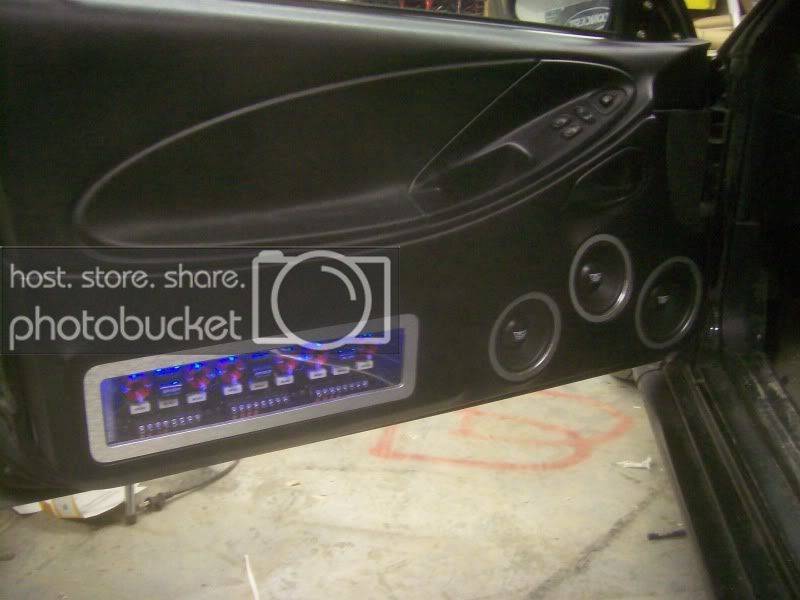

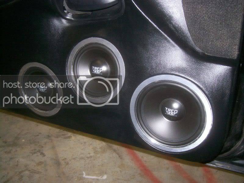

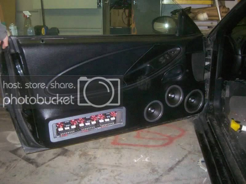

heres some finished pics. bear with me i dont have the best camera haha i got to ge ta picture of them in the daylight.
The rings are made out of Brushed aluminum Alupanel, a 1/8" aluminum abs substrate. i also beveled the inside the edge of the rings to. it was a long router process haha
The tweeters will be put up ont he A pillar when we get some time, and vinyl haha. but just with mids right now, it SCREAMS
