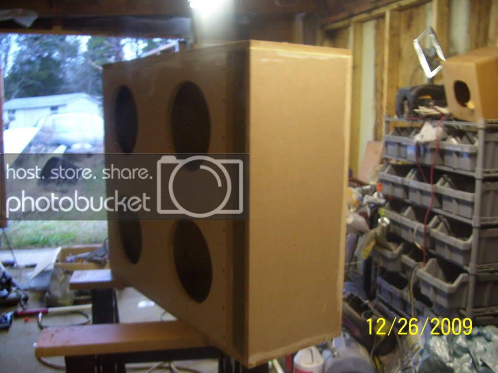

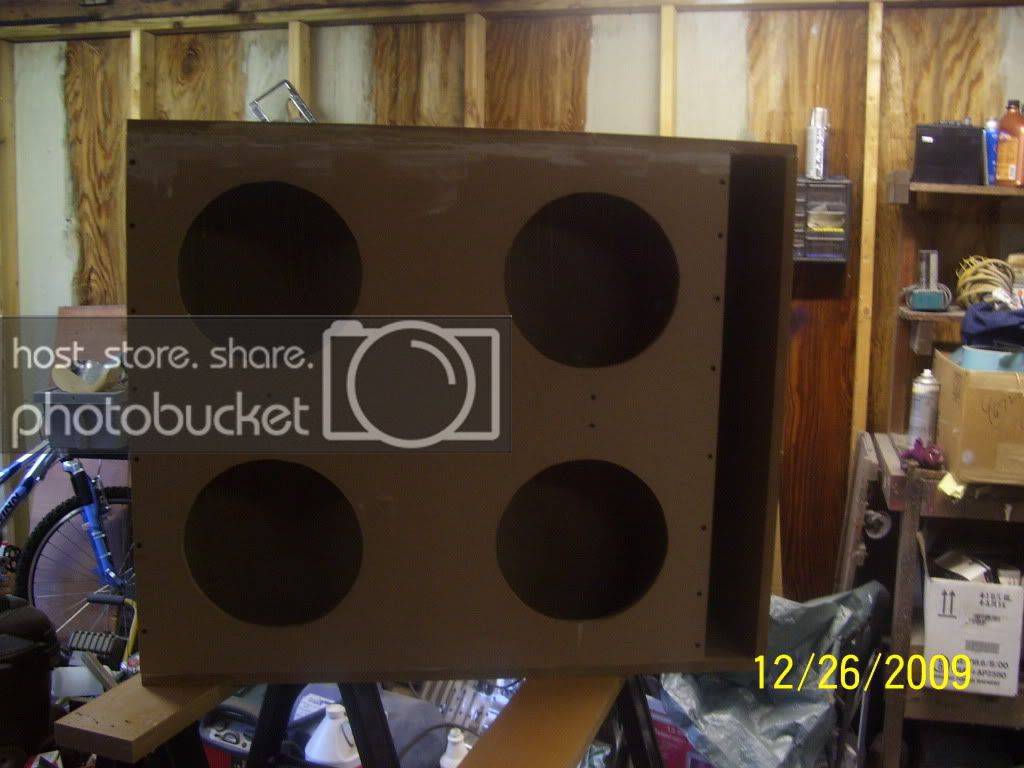

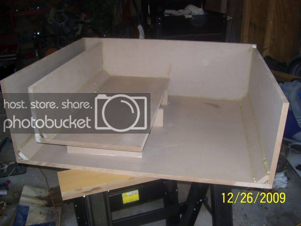

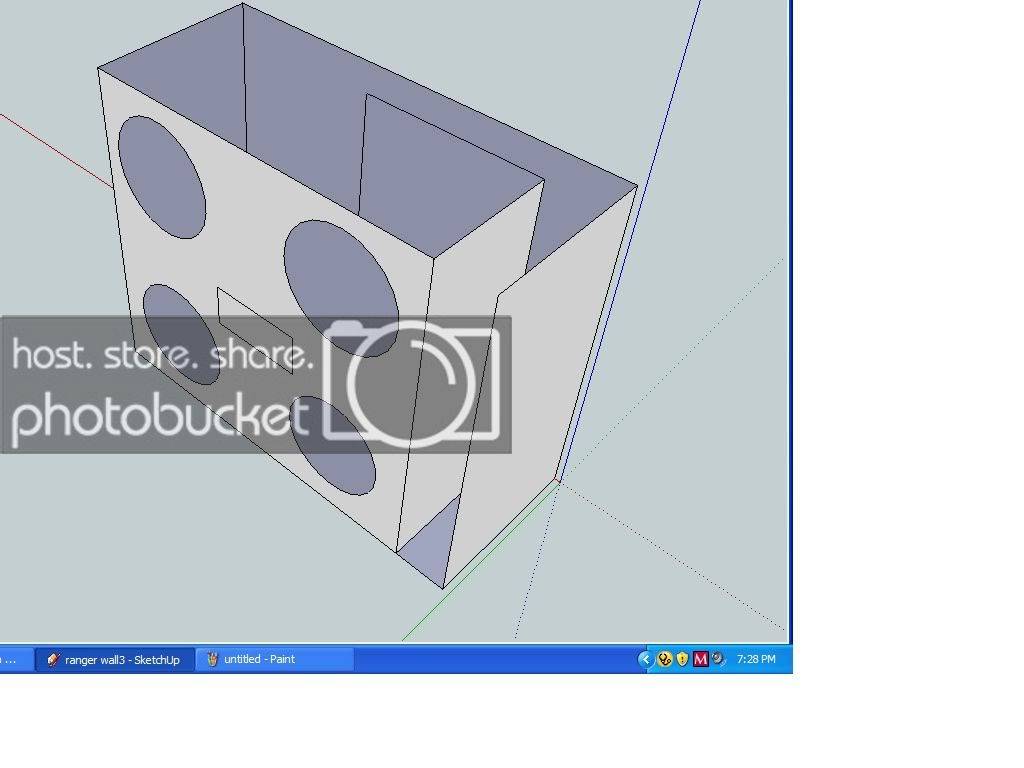

Well i have decided to wall this truck finally it will be sorta a slow process until after christmas and then it will be moving quick anyways. The equipment will be.
4- 12" Funkin audio sx 12's dual 4ohm wired in series to 2 ohm load

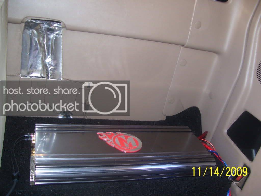

1- Old school memphis mojo amp 2000watts at 2 ohm. 2400rms at 14.4
Alpine cda-9886 H/u

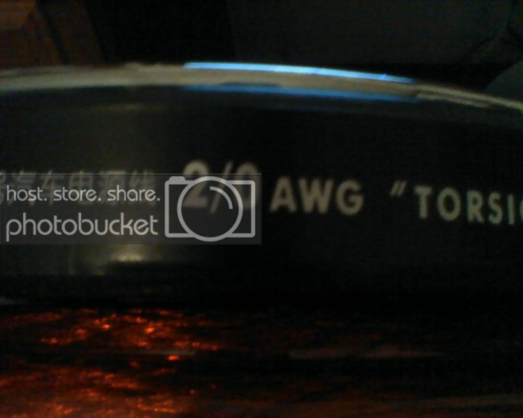

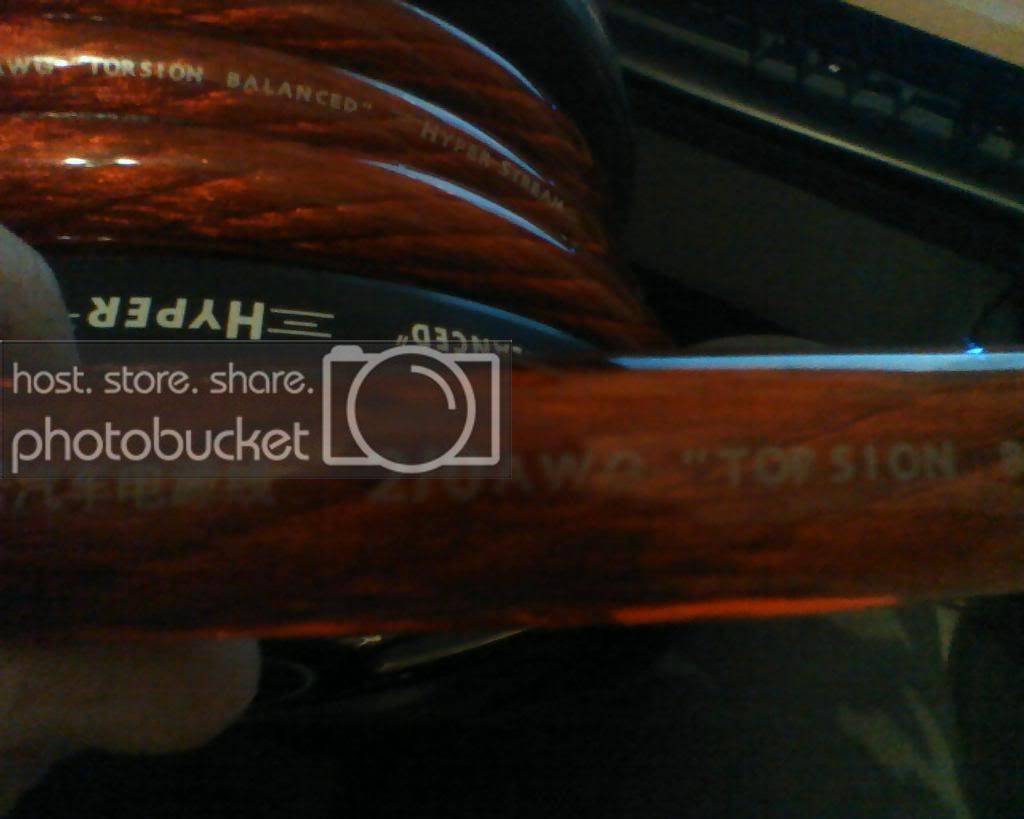

All Funkin audio wiring. Rca's 2/0 wire for the amp 1/0 big 3 wiring 10 Awg speaker wire for subs fuses and fuse holders.
R-blox sound deading through-out the whole truck
Kicker 5x7s in the doors for now until i get some comp's and amp.

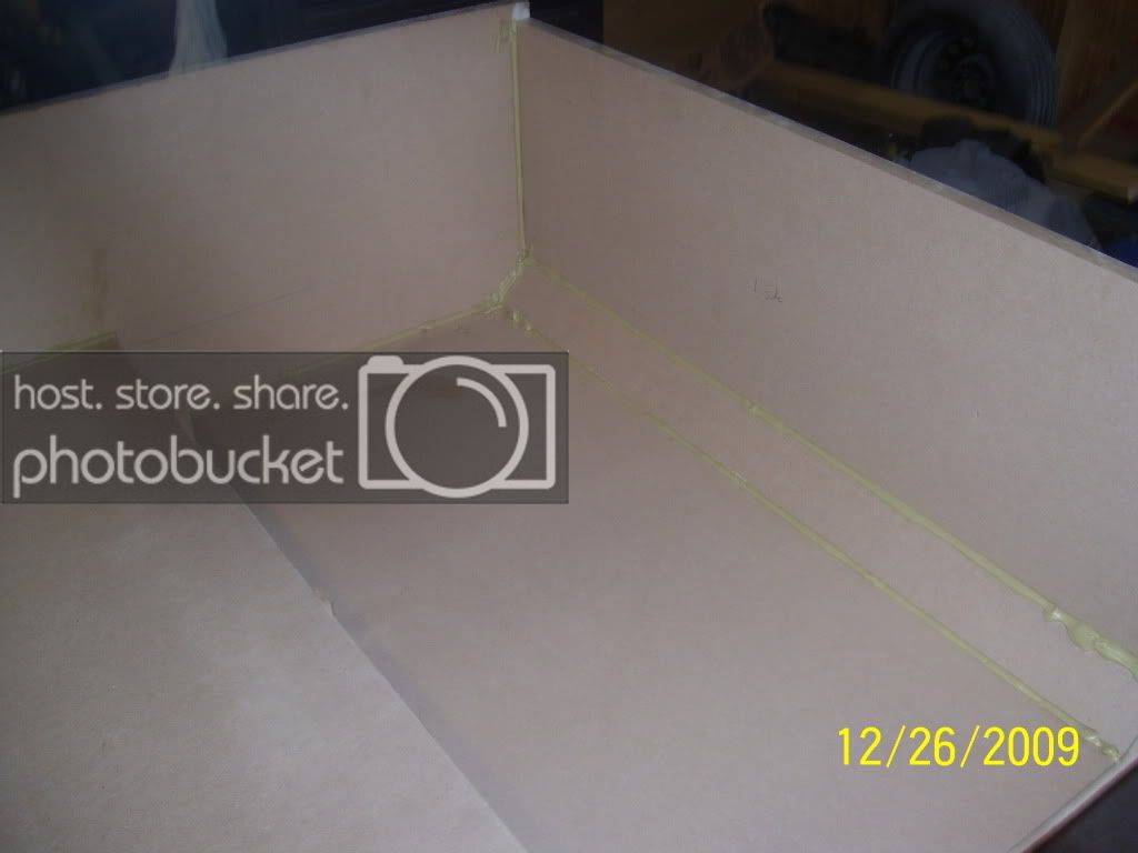

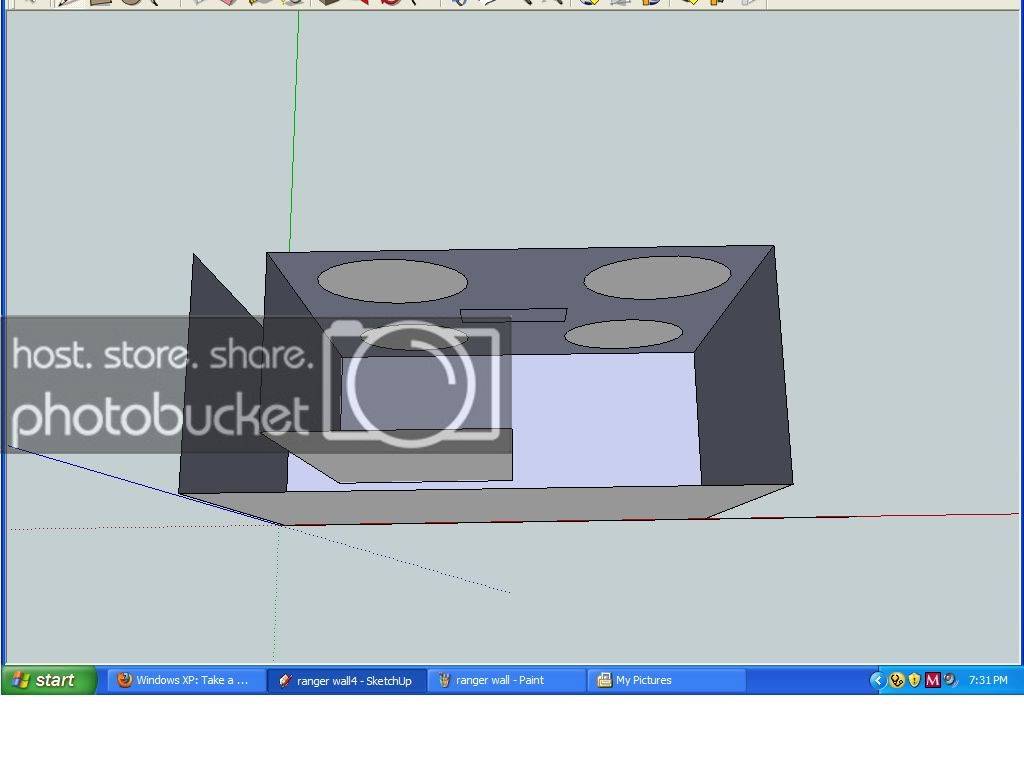

8 Cu.ft wall tuned around 38hz
Here's pics of some equipment and the truck.

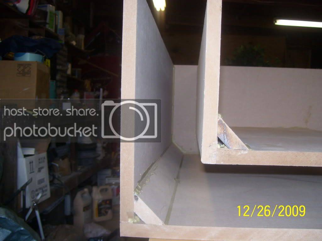

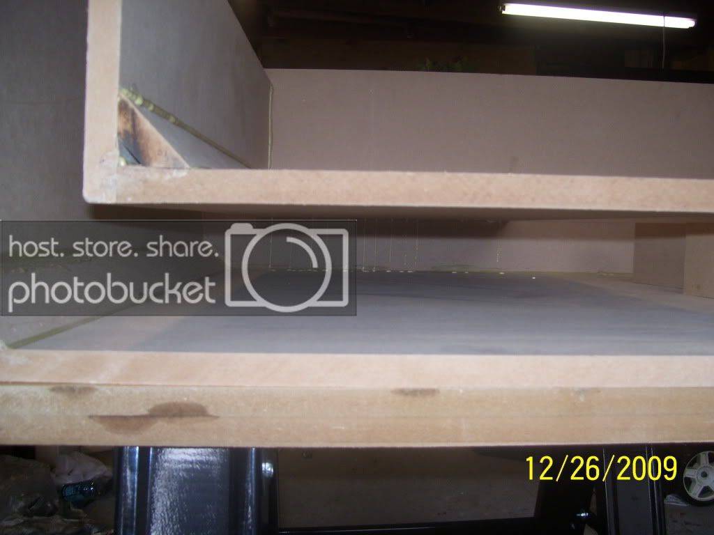

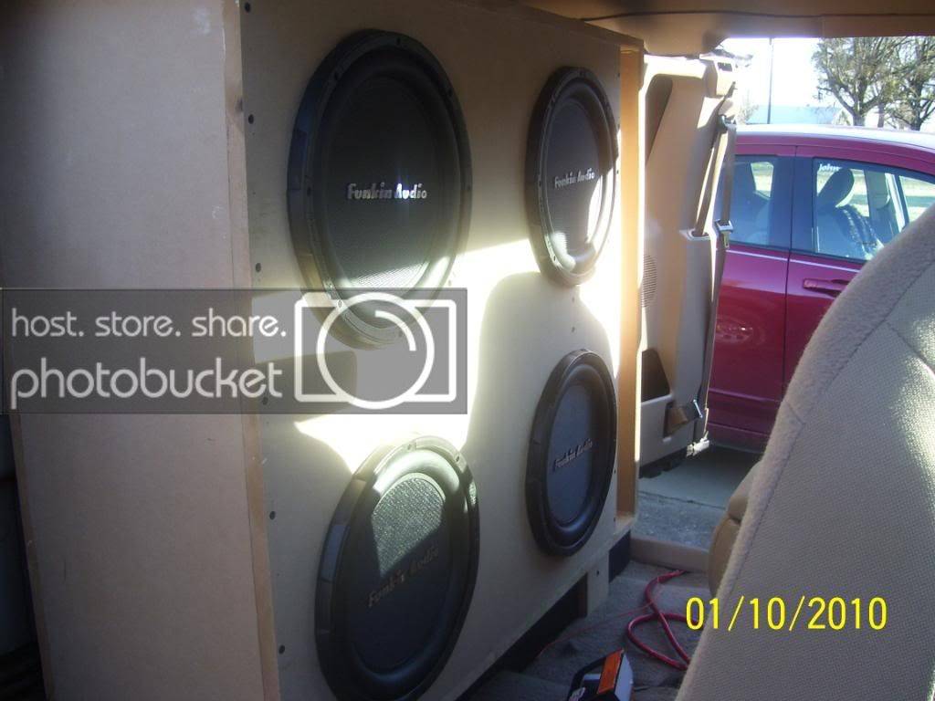

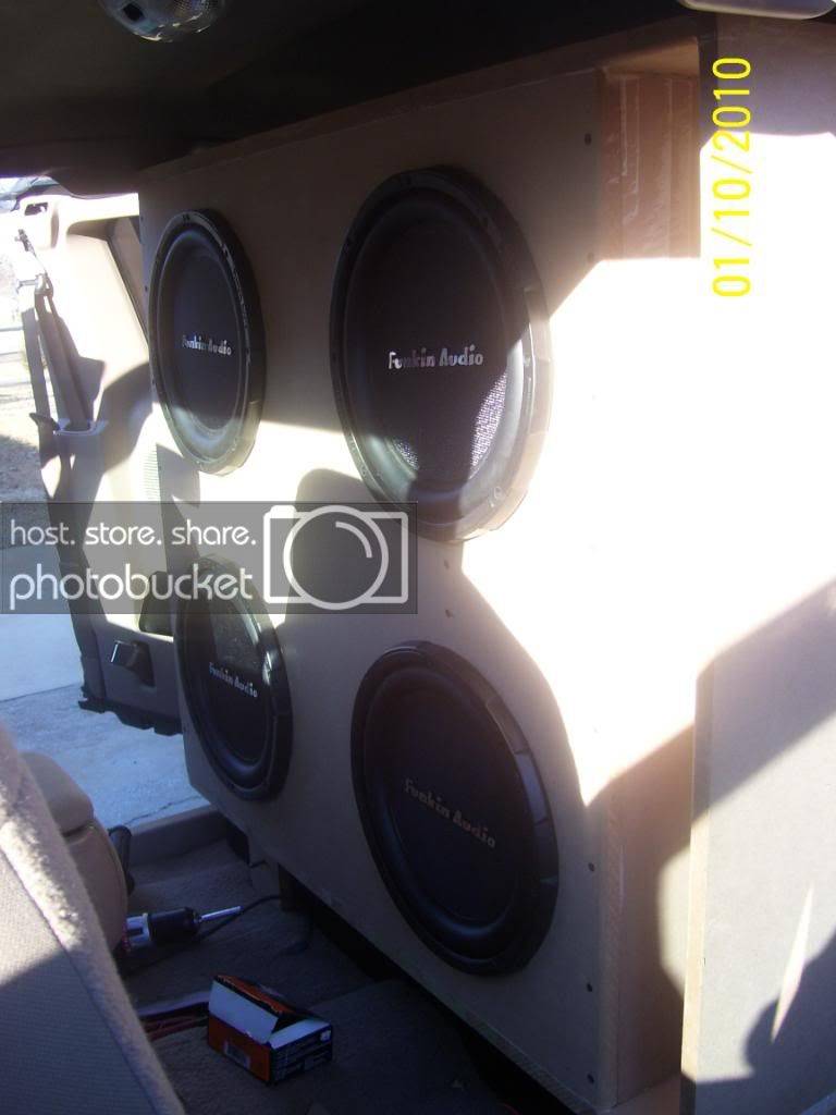

well i finally got the wall in all i got to finish is trimming the wall out order my other battery and install the amp onto the pics let me know what you think.
