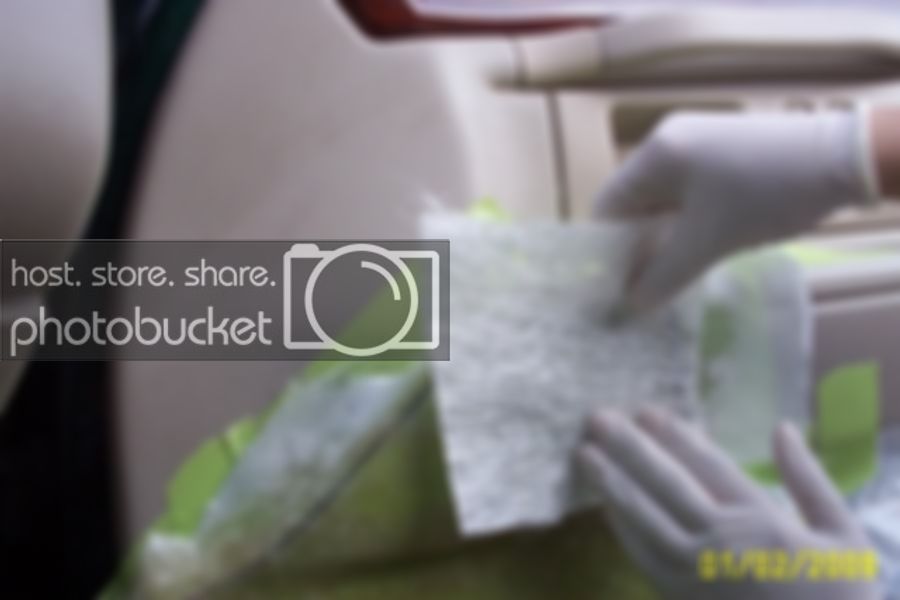

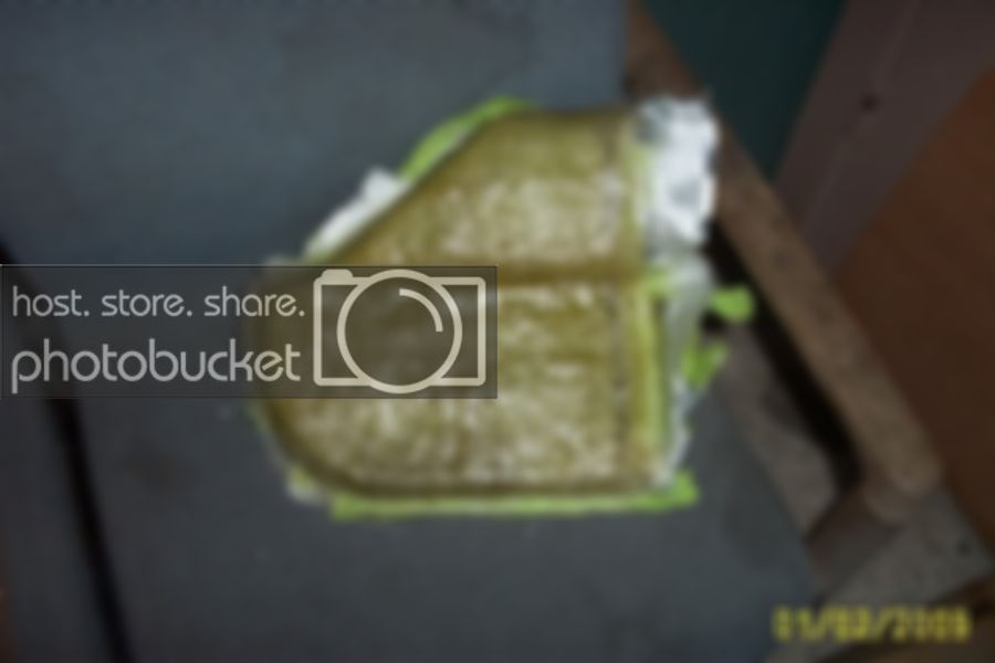

I started glassing my doors for the speakers today. I work with fiberglass for a living but this was a bit of a challenge because the resin kicks so fast! I put one ply of mat down, and then I tried to put on a ply of some thick fiberglass cloth I got from work (didn't work so well, it left a lot of bubbles) so I continued on with the mat and laid 4 more plies down... total of 6.
It came out pretty well, I have the baffles built at work so hopefully next week I can get all of this finished. //content.invisioncic.com/y282845/emoticons/smile.gif.1ebc41e1811405b213edfc4622c41e27.gif

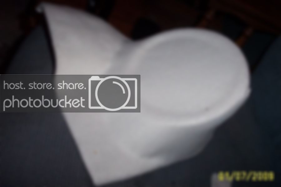

The rough finished product //content.invisioncic.com/y282845/emoticons/biggrin.gif.d71a5d36fcbab170f2364c9f2e3946cb.gif

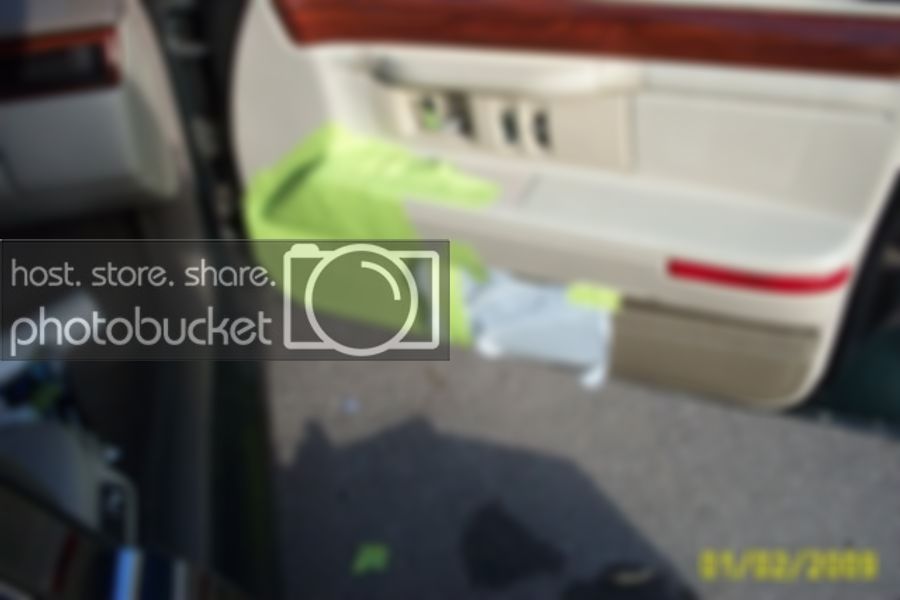

looks like its going nicely, but i have a question....i was just wonder why are you putting you pod so high in the door...do you not like the ones that have this shape.
I've seen a lot of people with those kind, I wanted to do something a little different. Plus, I needed to cover up that stock tweet grille that I won't be using. //content.invisioncic.com/y282845/emoticons/smile.gif.1ebc41e1811405b213edfc4622c41e27.gif
The actual speaker is still gonna be pretty low in the door.
thats right i forgot about that tweet...

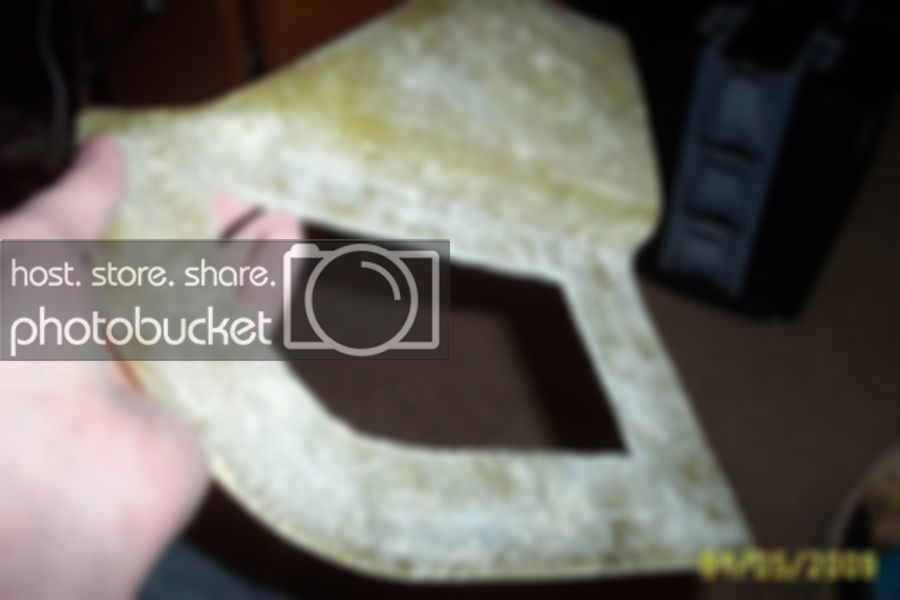

Made a little progress on the door pods today.

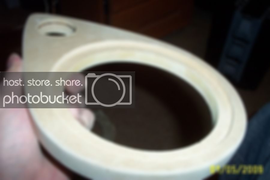

I trimmed/ported/test fit the glass backplate, bored out the speaker holes in the baffles, and rounded the edges. The woofer and tweeter are flush mounted, although the tweet hole needs a little bit more diameter on it which I will do tomorrow. //content.invisioncic.com/y282845/emoticons/smile.gif.1ebc41e1811405b213edfc4622c41e27.gif

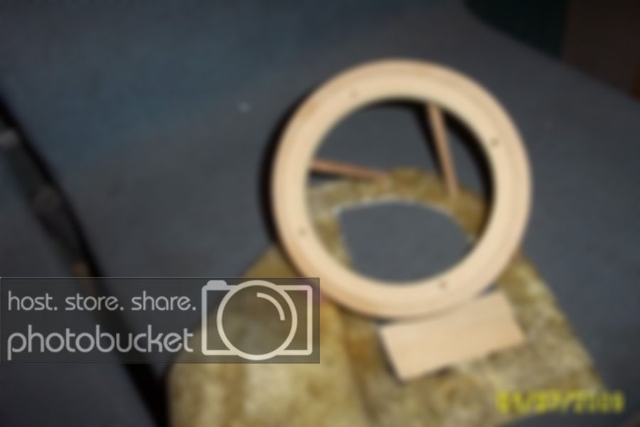

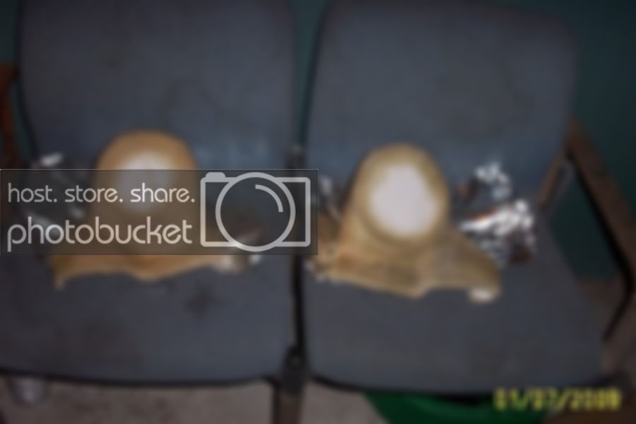

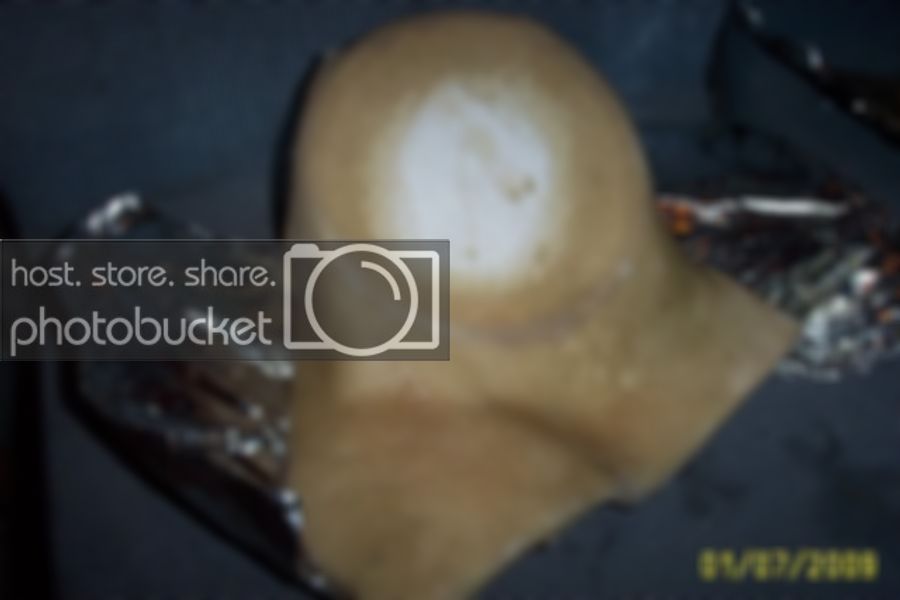

I ground the baffles down to rings and got them properly imaged today, mounted them with dowels, wrapped them in fleece and proceeded to slather them with resin //content.invisioncic.com/y282845/emoticons/smile.gif.1ebc41e1811405b213edfc4622c41e27.gif
They look great so far... tomorrow I will grind off the excess fleece at work and proceed to bodyworking these bad boys... I also still need to cut the hole in my door panel. So here's what I got so far...

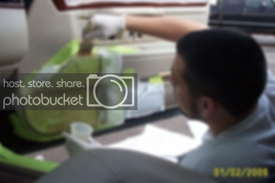

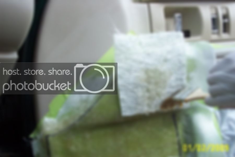

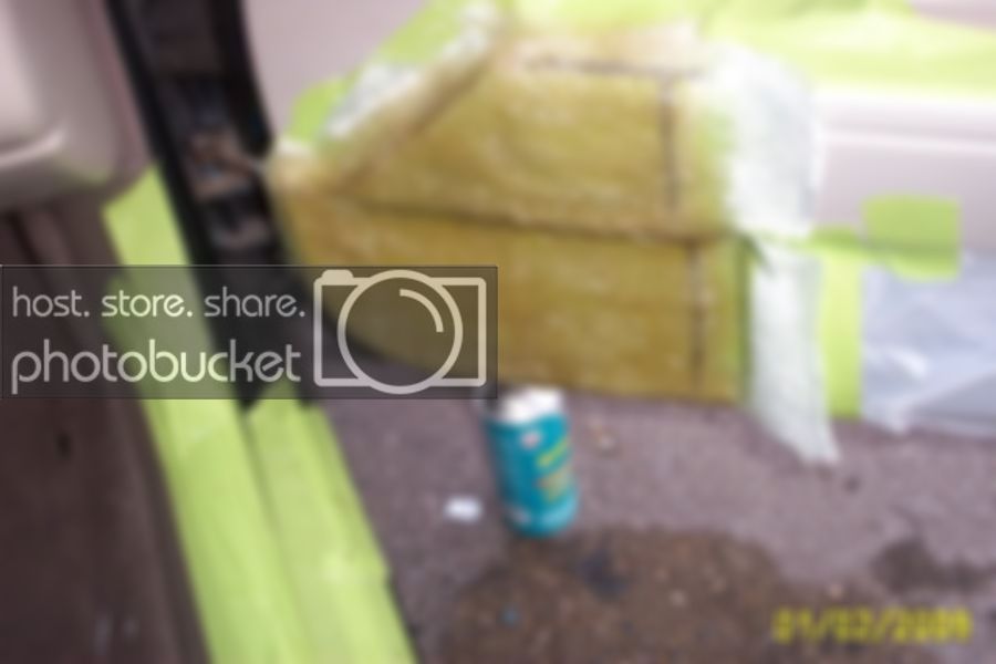

The pods set up for wrapping... Looks a little strange now but stay tuned //content.invisioncic.com/y282845/emoticons/biggrin.gif.d71a5d36fcbab170f2364c9f2e3946cb.gif
All wrapped up
Wetted with resin
Don't look at the backside... needs a lot of bodywork //content.invisioncic.com/y282845/emoticons/crap.gif.7f4dd41e3e9b23fbd170a1ee6f65cecc.gif
