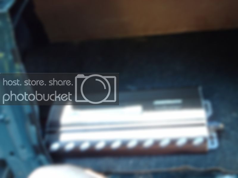

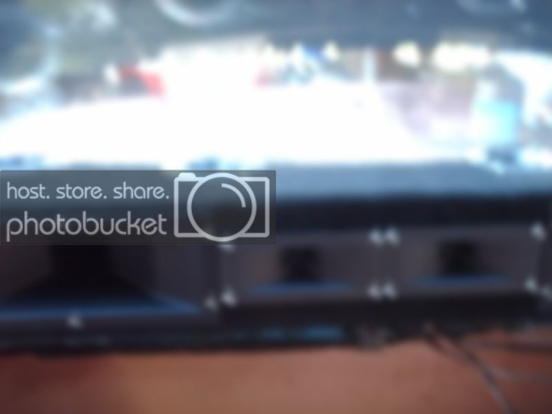

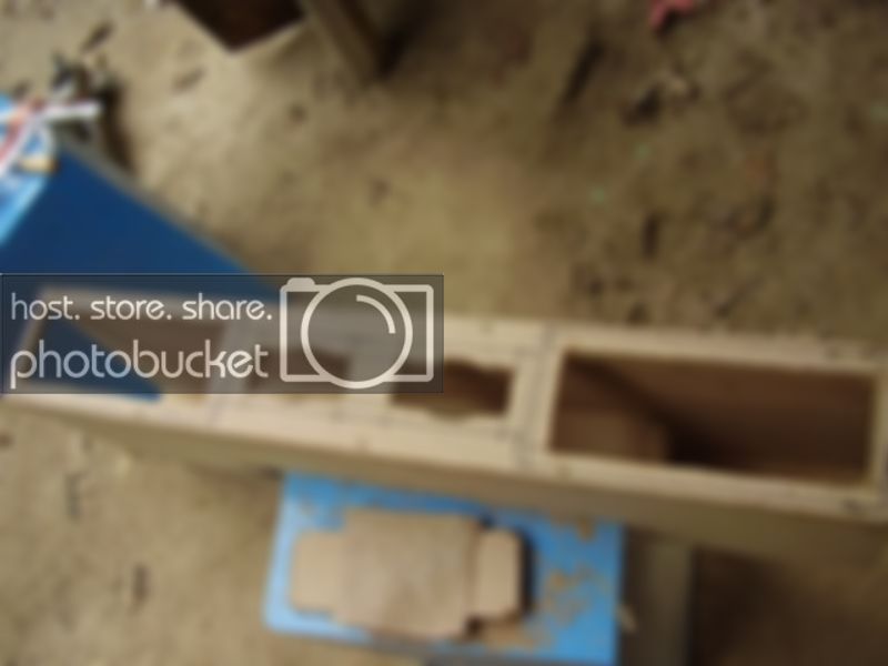

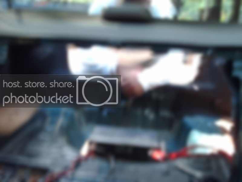

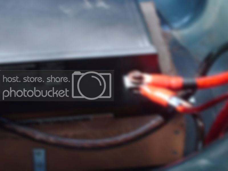

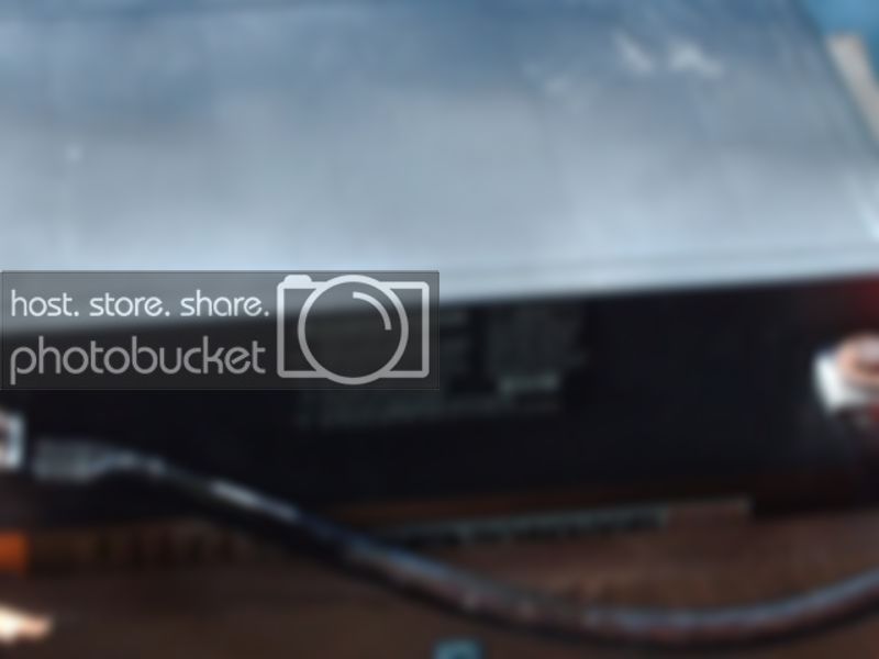

Got a few pics here from an install i did over the week, didnt have time to take detailed pics yet just snapped a few in action. Guys coming over friday for another install so i can take some more measurements and do some adjustments to everything. Ill get more pics then //content.invisioncic.com/y282845/emoticons/smile.gif.1ebc41e1811405b213edfc4622c41e27.gif
96 corolla
Q power comp set up front/ coax in back
Pioneer 3100 radio
Big 3 in 2 gauge
1/0 stinger through car to back, C&D batt mounted in spare tire well
2 Audiopipe TXX-15"s in about 5 cubes, sealed //content.invisioncic.com/y282845/emoticons/crap.gif.7f4dd41e3e9b23fbd170a1ee6f65cecc.gif
AP1500 runs the subs
Alpine 4ch runs the comp set and 8 extra horns in the rear //content.invisioncic.com/y282845/emoticons/crazy.gif.c13912c32de98515d3142759a824dae7.gif

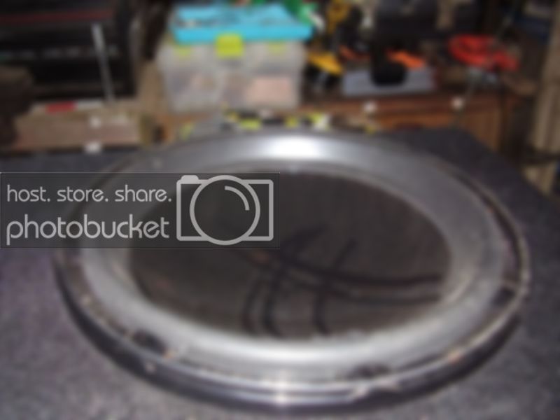

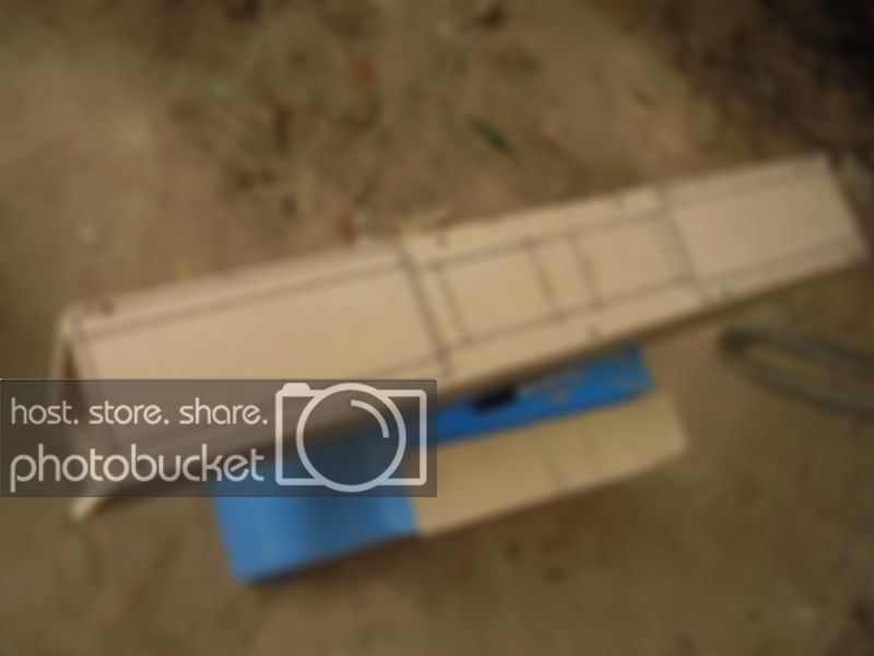

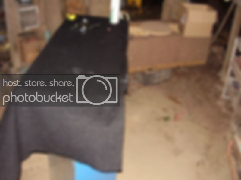

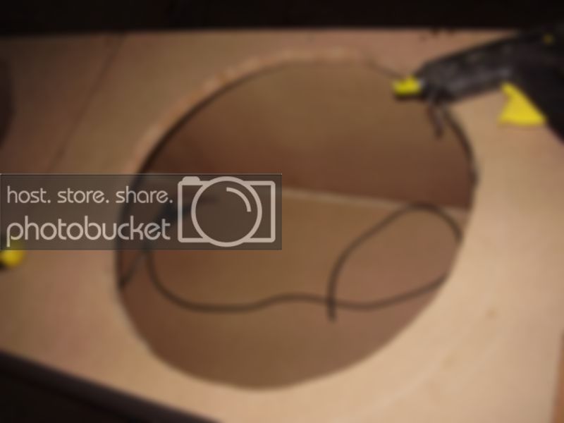

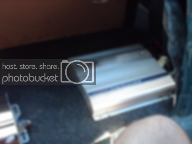

Anyway, overall it was a clean install. Went smoothly except for the box fitting issues. Running about 2k total power and at full tilt it will drop to around 13 at idle, at the sub amp. Thats on zoe - dopeboy. Did a few small things like adding a rocker switch and bass knob flushed into the panels, looks real clean. The car is so tiny i can pull a hairtrick running the subs sealed, cant wait to go ported with it. Loud as fawk for only 1.5k, and the highs are insane too. The sealed box def isnt helping the lows though, guess these subs hate sealed, but ive done several sealed setups that abs. smashed the lows. a 25$ sheet of MDF will fix that though. Dude started blushing and shit when i first played everything after it was done. Word of mouth = best form of advertisement //content.invisioncic.com/y282845/emoticons/cool.gif.3bcaf8f141236c00f8044d07150e34f7.gif

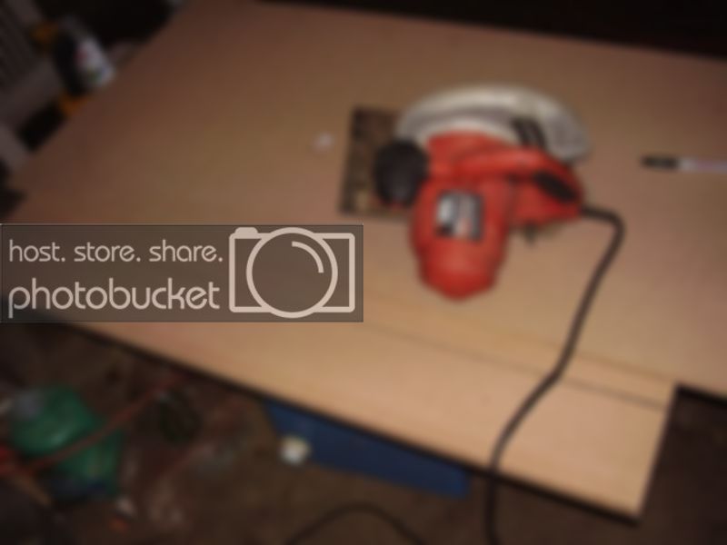

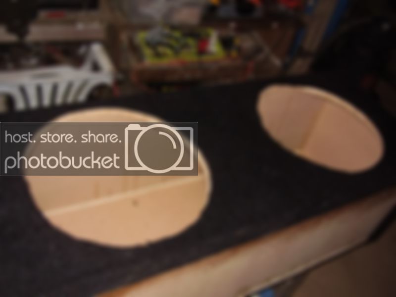

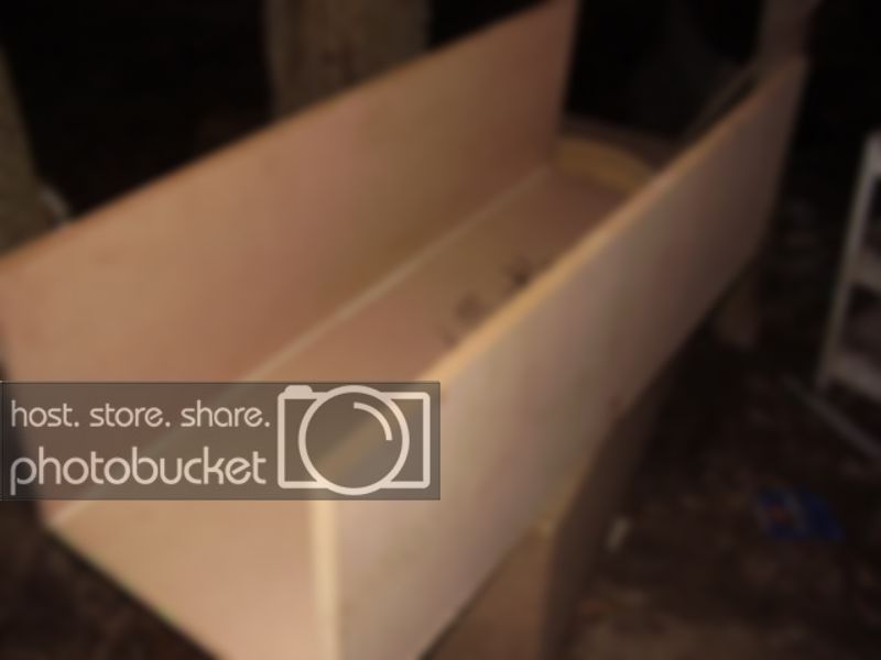

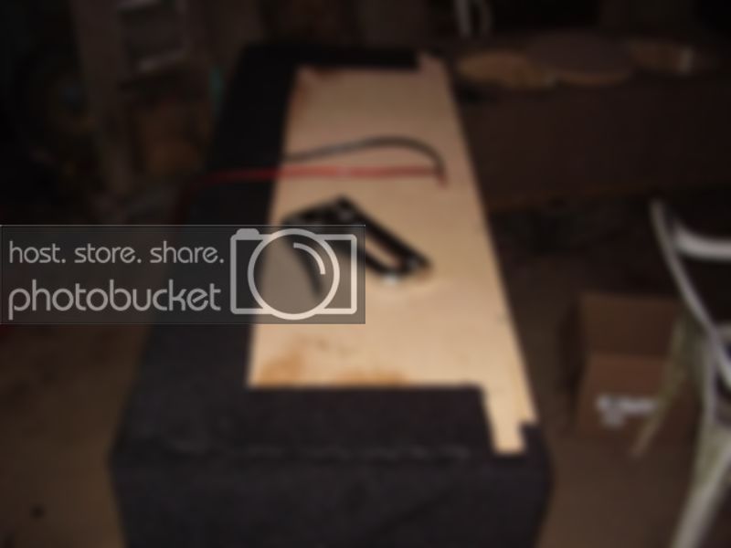

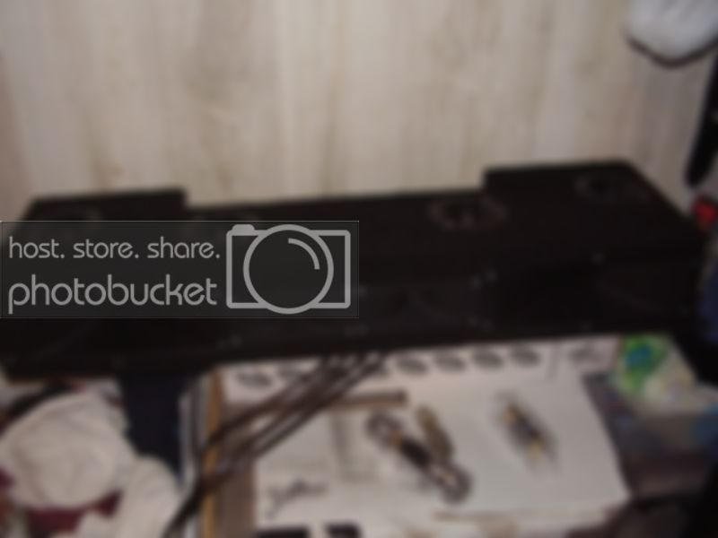

Heres the pics, you might be able to see in some of the pics how i had to trim about 6 inches off around the entire rear seat frame, top, and sides. Guy wanted to avoid this, which was the original cause for the sealed box. No point now though, soon were doing 8 cubes ported, since its basically a hatchback now. //content.invisioncic.com/y282845/emoticons/biggrin.gif.d71a5d36fcbab170f2364c9f2e3946cb.gif
